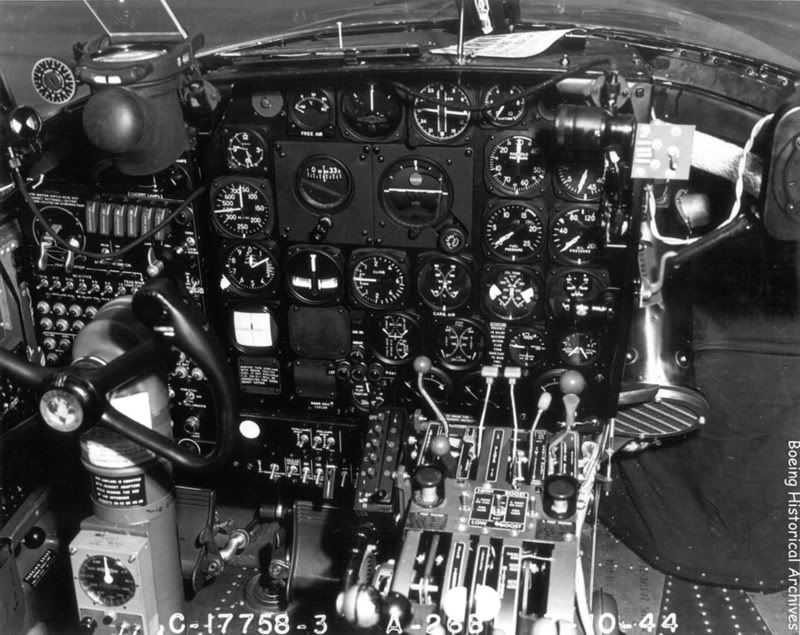

Totally agree that the classical N-9 with B1 sighting head was used on all those planes (example photo for A-26) but we have here another sighting head AND the protective rubber bumper removed during refurbishment.
would have therefore been very unsafe for the pilot if any of those plane in case of accident !!
Laurent
