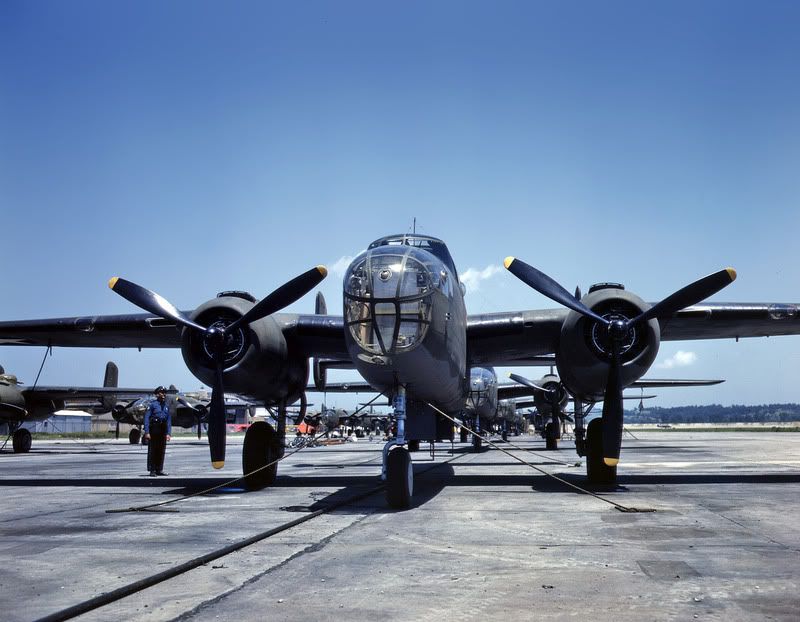

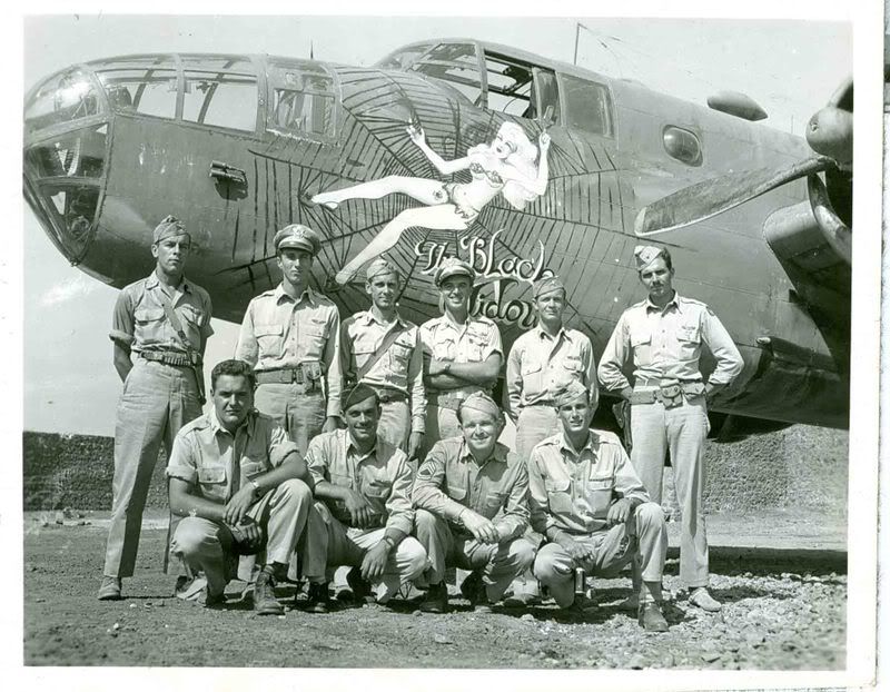

PostPosted: Wed Mar 26, 2008 4:29 am
Posts: 1521
two production shots
and a nice nose-art
is this the window you are referring to, Ken ?
Martin
PostPosted: Wed Mar 26, 2008 5:31 am
Posts: 2348
Yes, that looks like it. The photos bring up another interesting difference - those must be C or D models, right -- I'm not used to seeing the navigator's side windows convex vs. flush (as in the Doolittle airplanes). Remind me again how you can tell a C from a D visually. And to further confuse matters, don't some late C's and D's sport Clayton exhausts instead of rings (as these do).

Posts: 1521
2nd photo - the a/c in the background (tail visible) with serial 42-53332 is a North American B-25C-5
