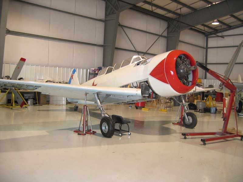

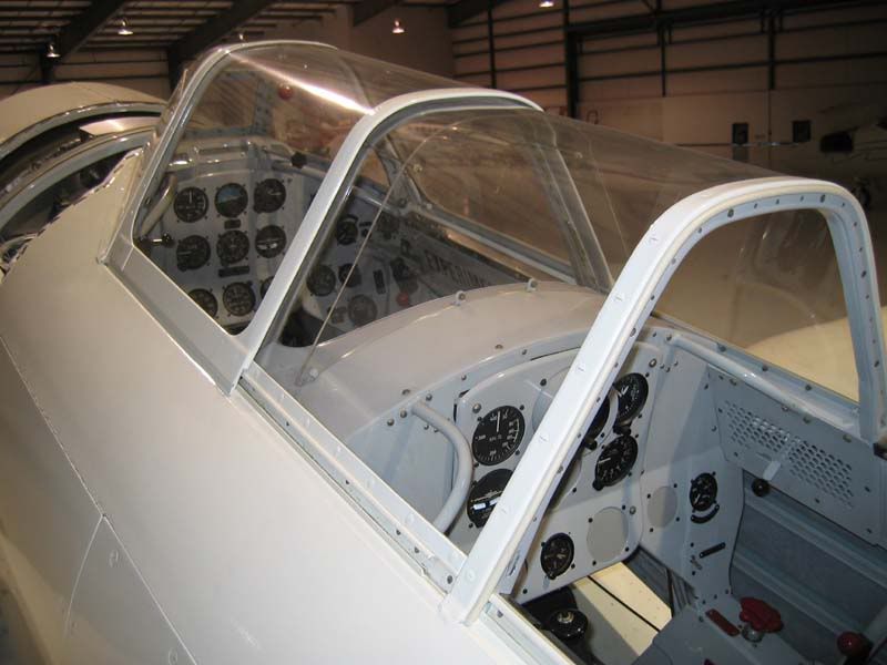

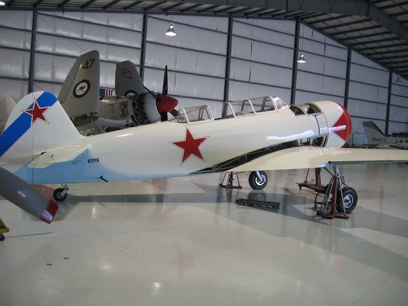

Here's some from the other day. Today the ailerons were installed, as well as fitting the oil cooler. Progress is good, and hopefully we'll be ready for engine runs in a few weeks. Still plenty to do though, as each system is hooked up, brought on line, and checked over.
Mon Mar 21, 2005 8:27 pm
That looks like a nice machine!
Mon Mar 21, 2005 8:48 pm
Good looking ship, it is good to see one that is going to fly in stock configuration as most of the recent restorations seem to be to a single seat layout of one sort or another...............or is it just me with a warped view. :roll:

The prop for the Yak is a cut down Ham Standard from a DC-3.

So what is the big knob upper right in the front pit then Steve?
Tue Mar 22, 2005 4:00 am
Opens the air vent in front of the pilot.
Tue Mar 22, 2005 6:02 am
Blimey is that all! Ergonomics so bad, you'd think they were British.

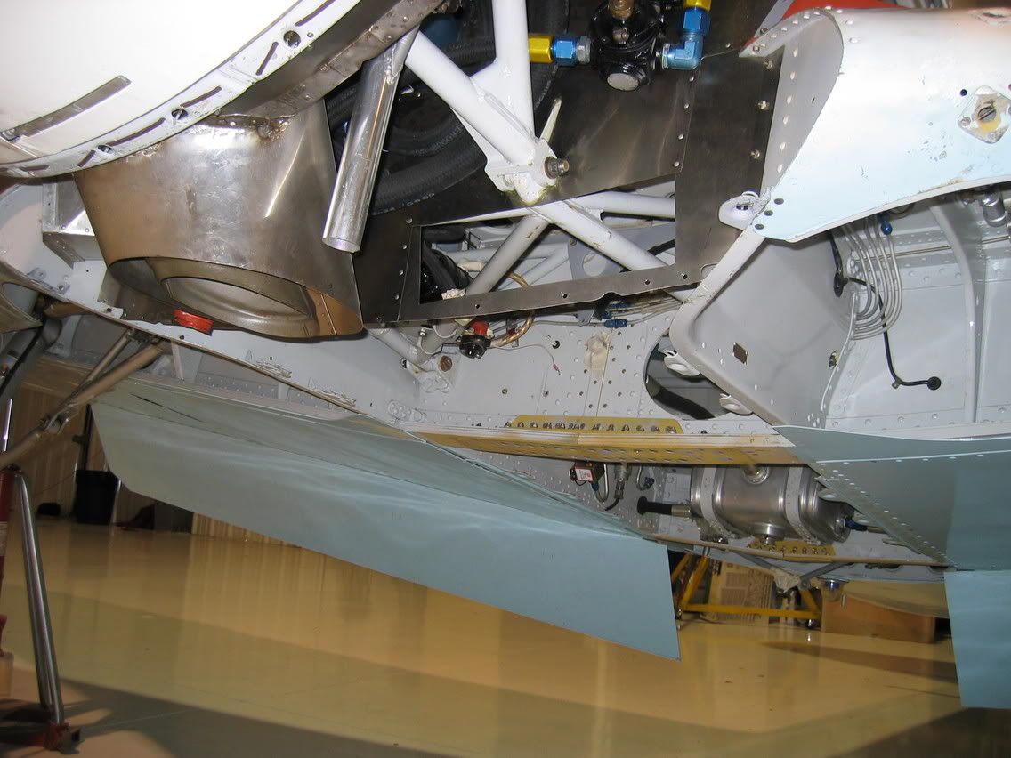

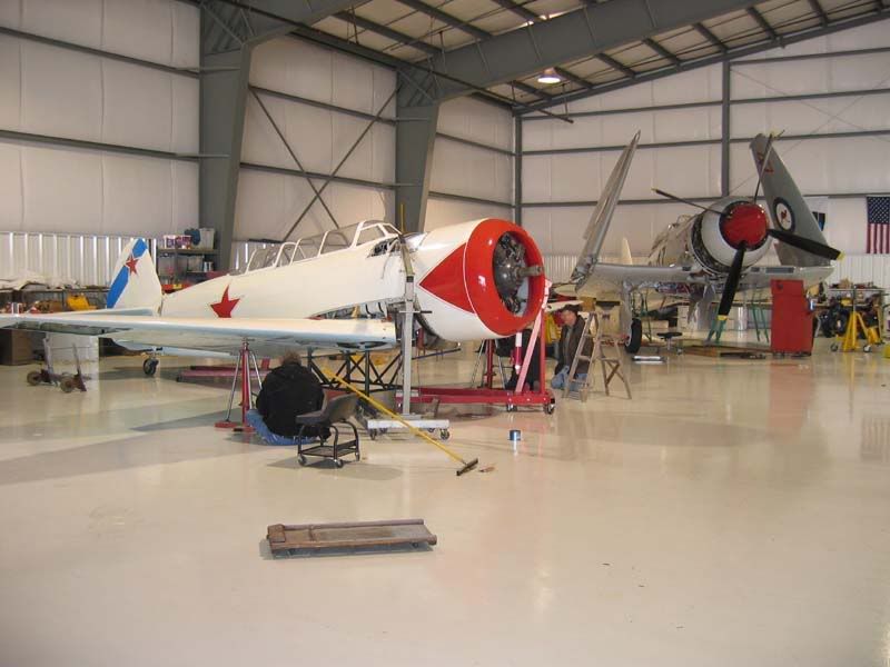

Here are some more photos of the Yak-11 project, taken today.
The flaps are now connected, as well as the ailerons. The oil cooler will probably be installed tomorrow.

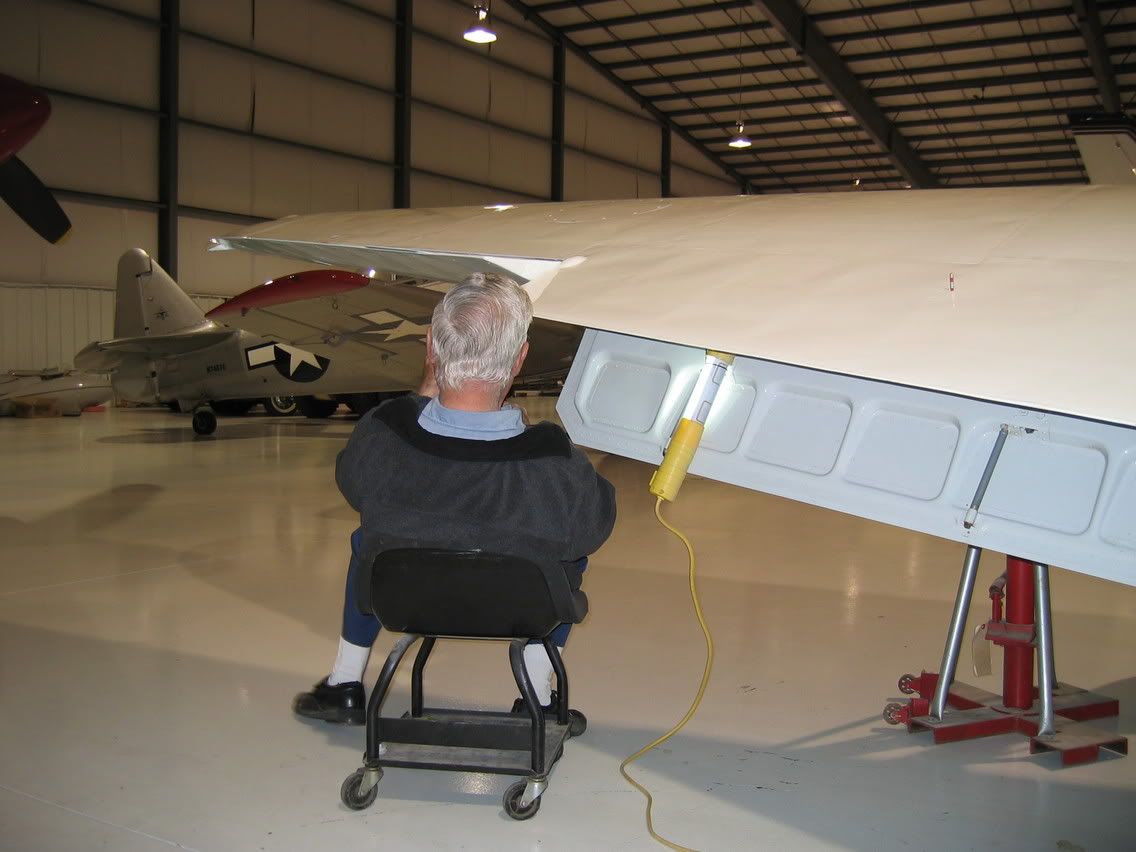

Here's Bob installing one of the ailerons (Bob doesn't like to have his picture taken).
These shots shows the exhaust ring and stack, which exit the bottom of the aircraft.

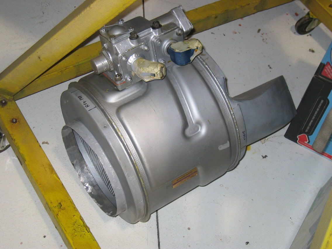

Here's the oil cooler, which installs just in front of the wing spar in the photos above.

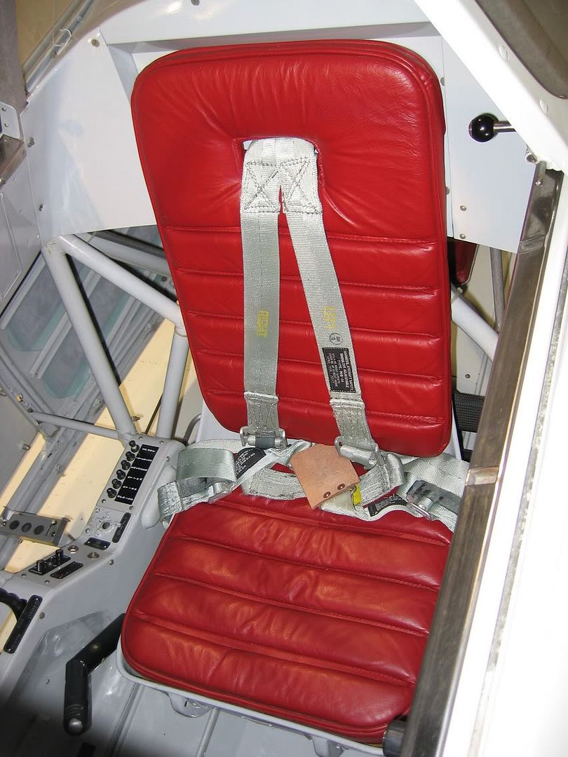

Pilot's seat

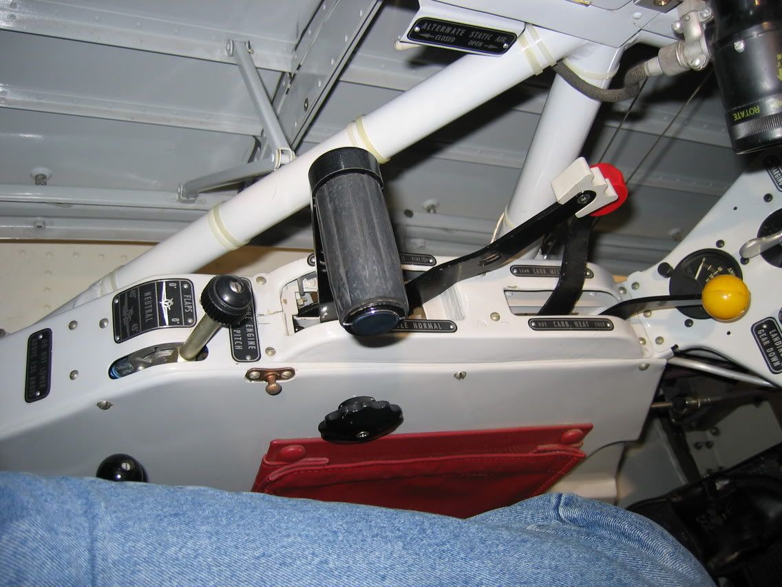

Throttle quadrant

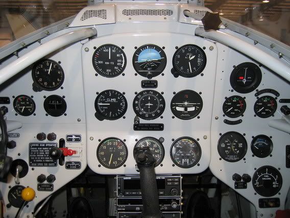

Instrument panel

this is really a good looking Yak! Who is suppling this nice placards for the two cockpits? What are the two instruments on the right panel below the pressure indicators?

Swiss Yak's wrote:Hi Steve
Thanks
Marco
All the placards were made by Bob Chinnery. The two instruments below the pressure indicators are a dual indicator for cyl. head temp and carb temp, and the other one is an exhaust gas temperature gauge (EGT).

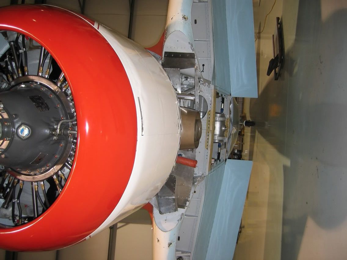

engine
Thu Mar 24, 2005 1:03 pm
are you using an P&W 1830 ?
Thu Mar 24, 2005 2:28 pm
Yes, an R-1830-75
