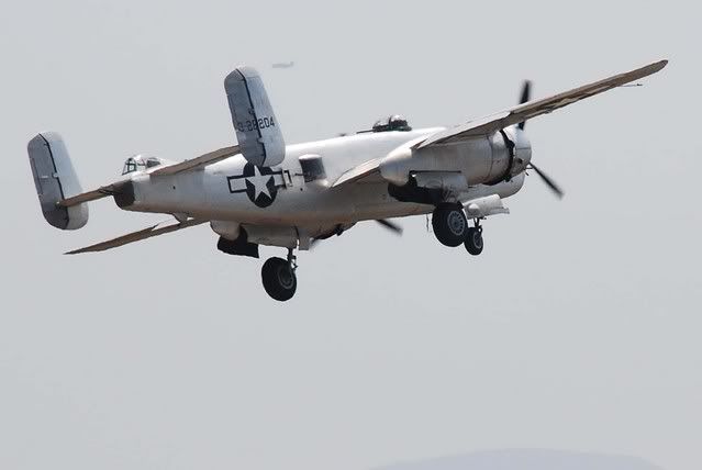

I love that shot of Moody and Fanny!

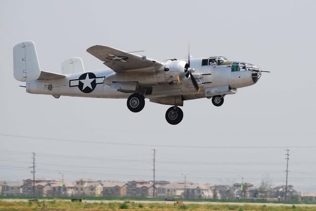

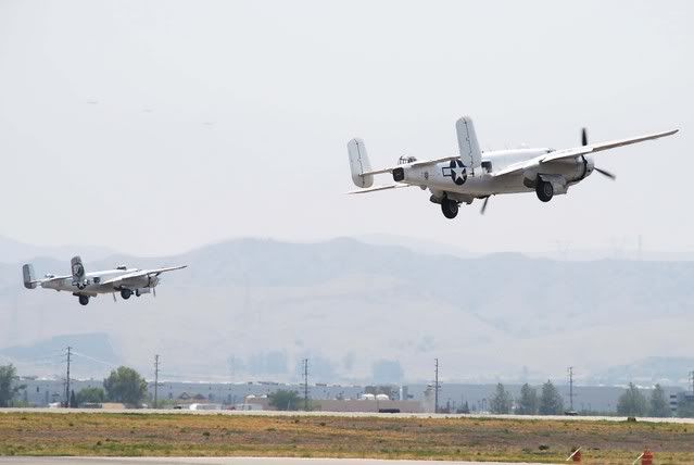

How come they all got the same Bare metal?
It costs a lot to paint an aircraft and a TON of energy to strip an aircraft. Also for "working" aircraft like Fanny and Pacific Princess they often have various logos or re-paints due to movie work or sponsorship and I think that is just a lot of work to keep up a paint job with that sort of stuff going on. Also "working" aircraft require a lot of maintenance meaning the cowling and access panels are coming off all the time which is also hard on paint. Princess and Fanny spend a lot of time outside the hangar and the sun makes quick work of the paint. Plus it was common to see late production Mitchells in natural metal.

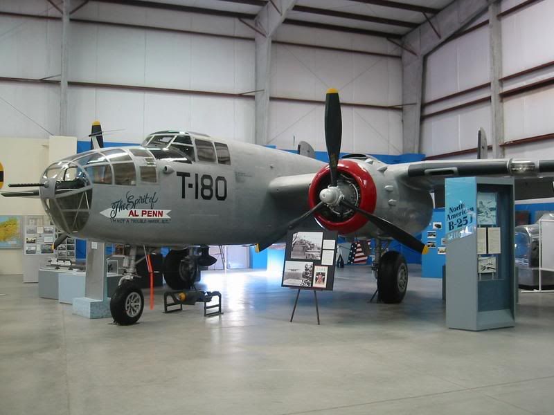

What is the story on this thin intake scoop? When and why did they do away with them?

the low flat intakes are the original intakes for the holly carbs. most flying today have the post war mod bendix carb's and replacement carb intakes

Did that go hand in hand with the exhaust stacks mods?

I looked at a few of my old pic. and I think the two mods where done at different times or at lest strarted at different times I have some pic. with the collecter ring but not the carb mod. so it looks like rings first carbs later. Jim

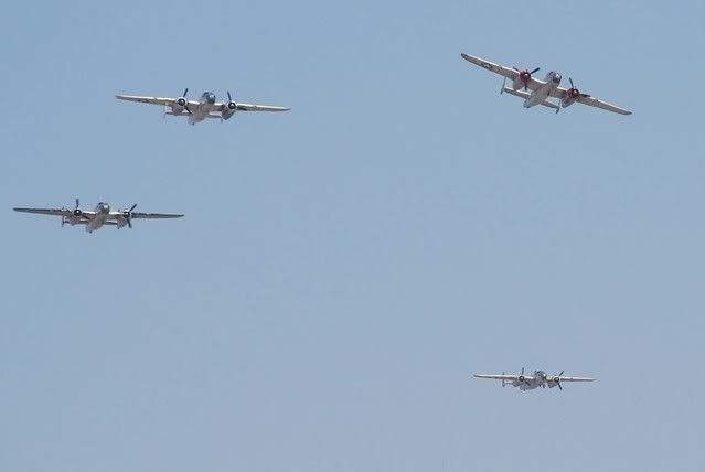

Dans 3rd picture looks like the B-25 may have the thin scoops and the collector ring? Any one have a better picture of the top side of the engine?
