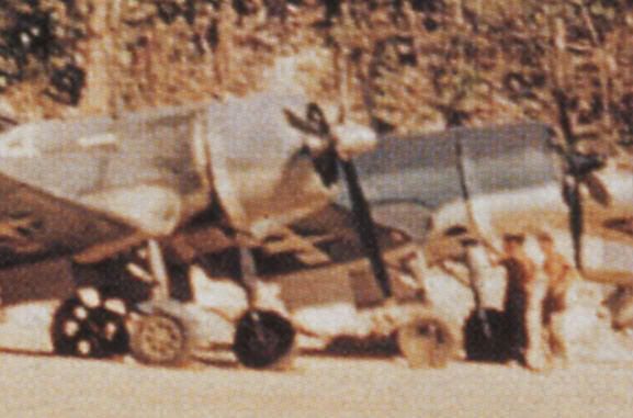

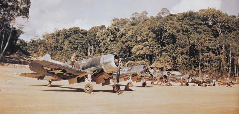

There was at least one Corsair painted this way:
it's the one at the end of the line in this picture, taken on Dec 15th, 1943 at Vella Lavella. This picture, from the National Archives, was published in one of Jeff Ethell's books, Pacific War Eagles.
HTH,
Laurent
