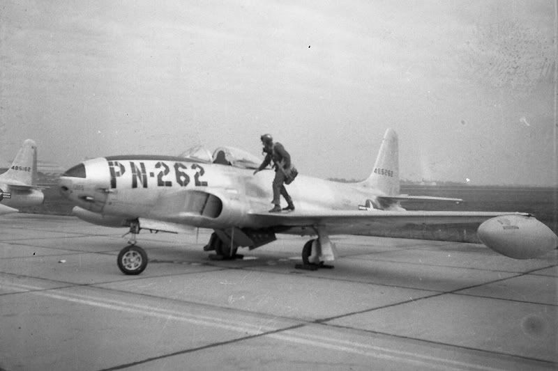

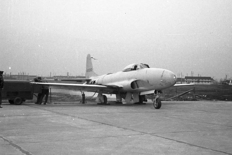

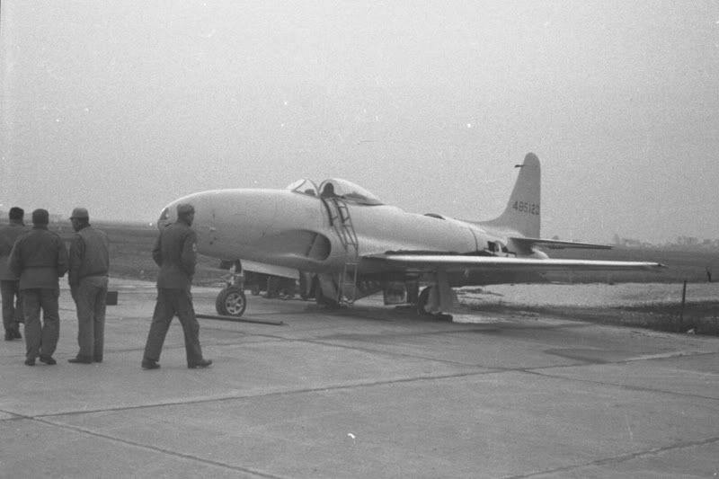

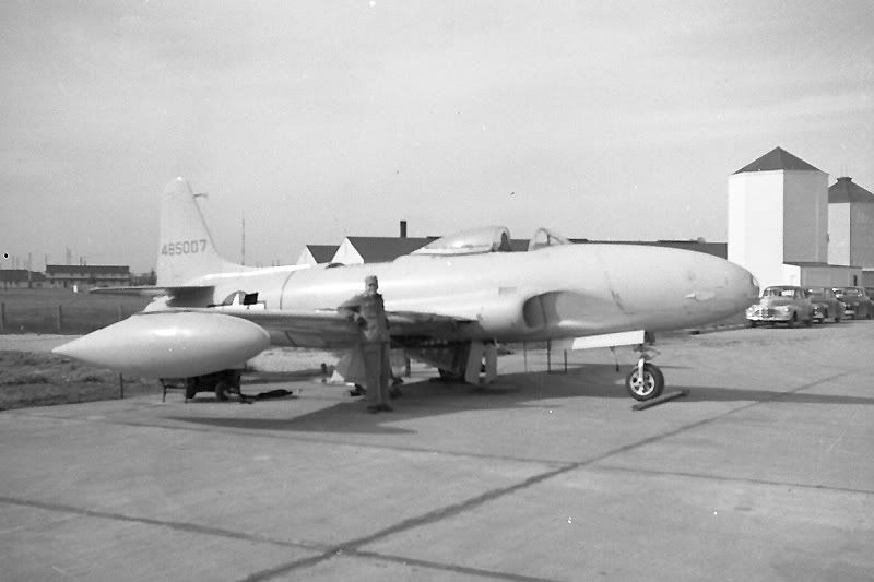

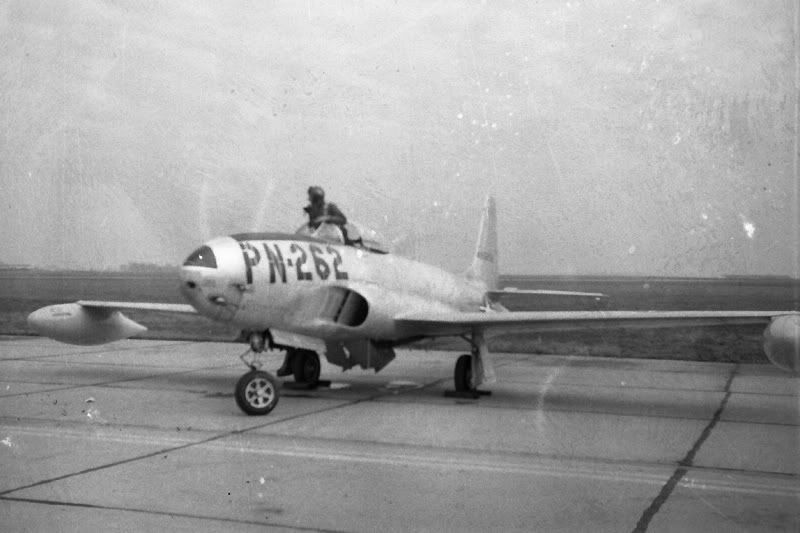

Some of the oldest of Dick Kamm's pics are from his training days upon entry into the USAF. This would have been in 1947, probably at Chanute AFB. The aircraft depicted are all from the P-80A-1-LO block. These are from 3x4cm negs on 127 size film, which was a beeatch to scan; I had to jerry-rig an adapter for my medium format unit. The negs weren't in the greatest shape; sorry for that.
Excited trainee poses with 44-85007:
44-85010:
44-85120:
44-85262 (2 pics):

Great shots! I hope the pilot in the bottom pic remembered to straighten the nosewheel before he strapped in and fired up, otherwise with it being non-steerable and free-castering he might have a tough time getting past the P-80 parked off the right wingtip!

There were/are two kinds of T-33/F-80 pilots, those who have oversteered the nosewheel while taxiing and got stuck, and those who will. When my airplane first came out of it's condition inspection, I practiced taxiing with my A&P standing by with a towbar to straighten the nosewheel in case I got stuck. It was tough because the parking area was pretty tight quarters and I got "stuck" twice. Key is keep up a good rate of speed and don't make too large/sharp a steering input on the brakes once you are at slow taxi speeds. The way out of the overcocked nosewheel is to rev up the engine and tap the brake until you hopefully, maybe powered out of it.
