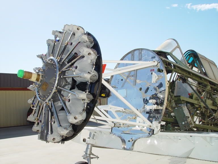

Here are some photos of my project and the restoration I've been doing:
http://community.webshots.com/user/c322348
I started out with a relatively complete airplane with no corrosion. There have been a few surprises, but nothing major. My time is limited, so it has taken a long time. I probably have another couple of years to go yet.
My advice: If you want a flyable airplane, save your money and buy one. It will be in your hangar sooner and will be cheaper. If you are truly looking for something to work on, you will get your wish. it will be a lot of work! :lol:
