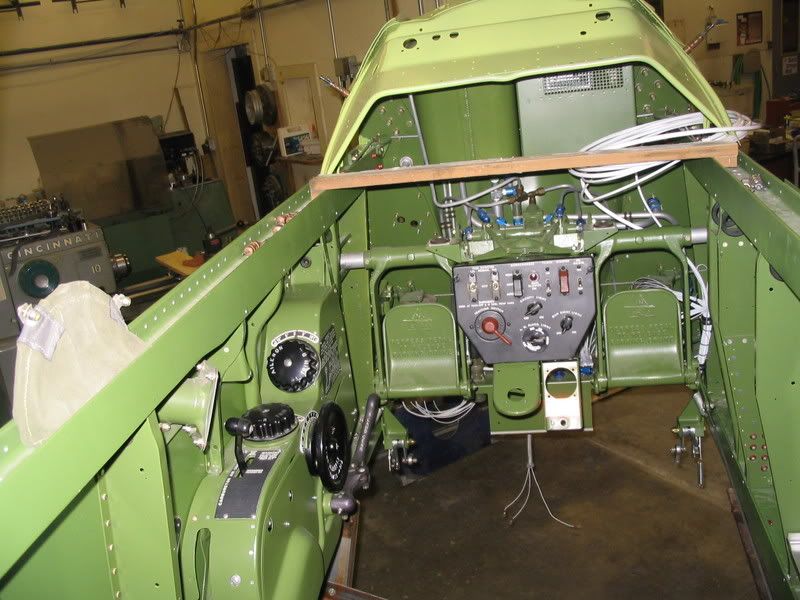

Here are some shots from the work weekend I attended back in October.
If I go next weekend, I'll grab some knew shots too.
John feel free to shot me any pictures you would like to see posted.
