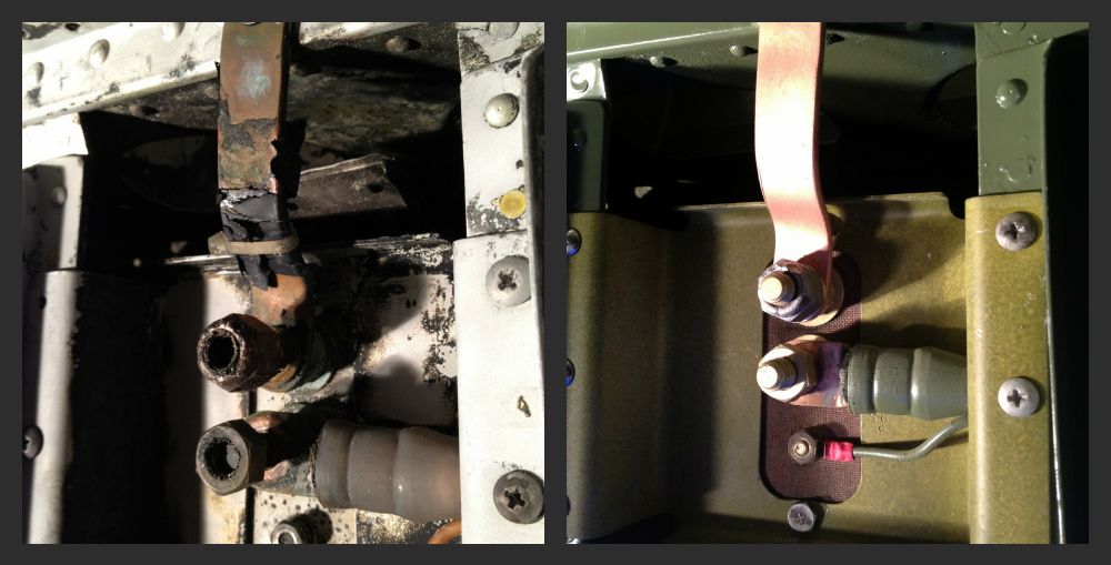

The left wheel well is coming along nicely. It is all painted and David A. took care of the bonding strap and connector for the external power plug on the left nacelle. Ain't she pretty? The look of new copper is just so nice!! Thanks, David!! David and Big Mike got one of the new landing light bulbs and found it to be a little different than the original. It has a two position setting for 1000 watt and 400 watt for taxi. We decided to not upgrade the wiring in the wing to handle 1000 watt so will wire it up for the 400 watt setting. The original was 600 watt. We won't be flying at night so not a biggee unless we get delayed getting in by having to avoid flying brooms or some such. The danger of mid air collision is compounded by the fact the ol bat doesn't look where she is going. But please don't tell her I said so. I don't want to go thru the rest of my life with a big boil on my .... uh.. posterior. :-) The other JR

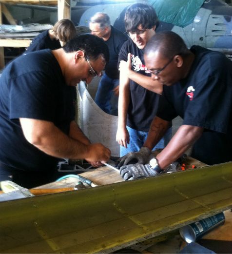

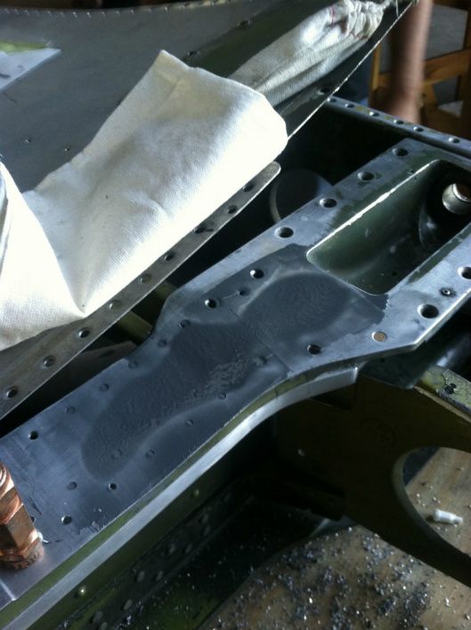

Felipe and David W drilled and measured on the horizontal spar repair all day. That is a delicate chore to get the holes drilled so precisely. They got the ground out areas all treated and ready for Dynamold's moldable shim material. The repair calls for a doubler plate to be bolted and riveted over the top of the spar and on both of the inner sides of the spar underneath. The airplane may break but this spar will be better than new. Oh, Granddad David L and grandson Ethan are in the background along with Denis M "supervising" Felipe and David W. JR

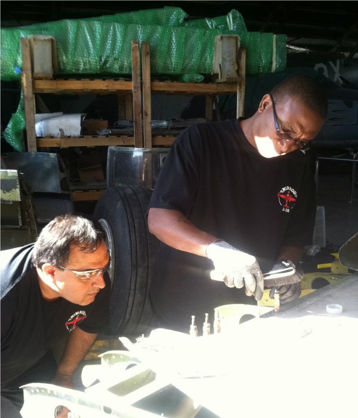

This is what they were working on. The moldable shim is applied and just waiting for it to harden up so that we can smooth it out next week and fit the doubler plate over the top. Looking good. Thanks team!! JR

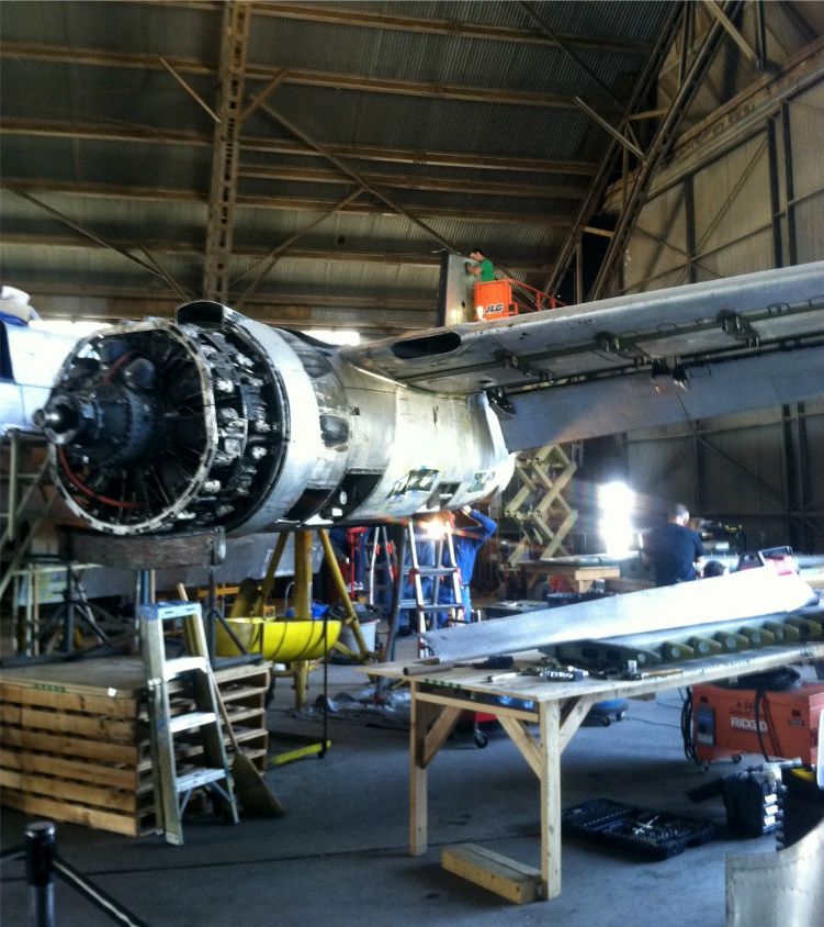

Clay is up on the vertical working on that cleanup. Should be ready to close in another week so we can remount the top and get the rudder ready to hang. Always optimistic!! :-) JR

More measuring and eyeballing by our American Airlines guys. They are a big help. Would welcome others to come out who have an interest in working on old warbirds and especially with sheet metal skills. JR

RickH wrote:
Moldable shim,....JB Weld ?
Dynamold, Inc..local Ft Worth company. can get you the MS number if you want it. Comes in several varieties. They have a website that is easy to find. The particular application they recommended to us sets up in 4 hours. There are a number of aerospace manufacturers using their products. 300,000 lb tensile strength. but we are not using it for load bearing, only to fill any minute gaps between the area and the doubler.

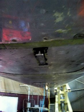

Denis got started on the latch for the avionics bay door on the belly ... uh, I mean the ventral side as opposed to the dorsal side of the airplane. The O2 Lady has been raggin on me to be more formal when I talk about the airplane. Our friends next door with the CAF A-26 Texas Special traded us their old door I think I mentioned awhile back. Their door doesn't fit their airplane due to changes in the size of the hole in the bottom... the ventral side. Well, you know what I mean. That airplane was one of the pre-OnMark airplanes.. Grand Central co. I believe. Robert Denny was involved with it, but then started On Mark. BTW, we hope to have Bob Denny, his son, with us at the Nimrod gathering on May 5th. We are thinking of having a big cookout at lunch time at the hangar as part of the deal. May open it to the public if anybody is interested. After lunch we will gather the A26 vets up in the conference room for some stories and videotaping. Kinda like an "After the Catch" scene from Deadliest Catch on tv. Will see what happens!! JR
