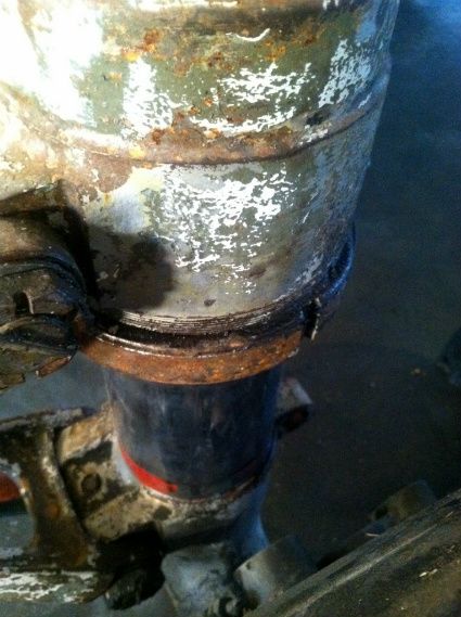

This is a "before" picture of the right main gear. Most of this is simple surface rust, but we will be taking the gear out after the Nimrod reunion on 5 May to start the clean up and overhaul the same as the left side. This will give K three good legs for starters. With the history of gear collapses in the type, we will look at the gear swings very carefully and try to catch all of the "problem areas" before she flies again. Stay tuned!! Jim R,

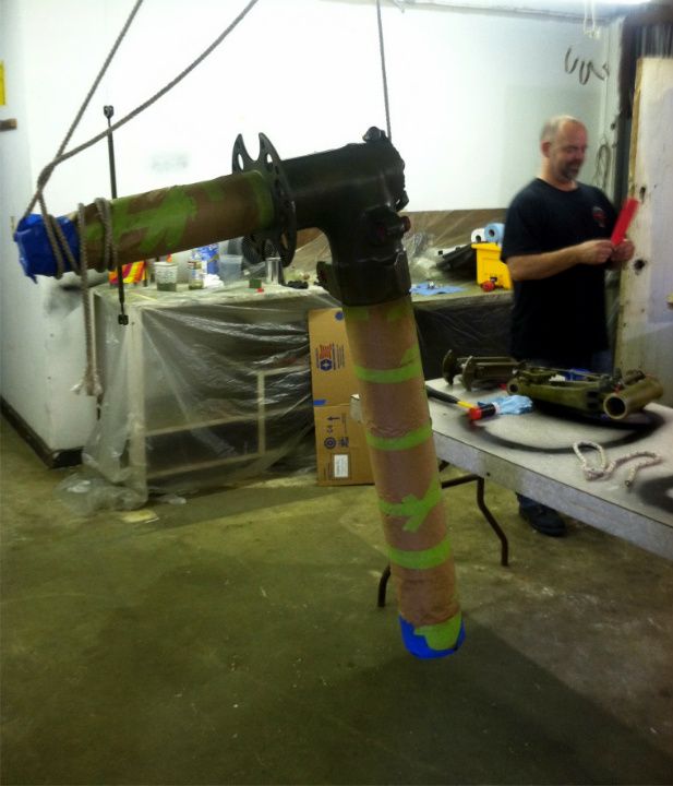

Much progress today. Here Big Mike and Denis are prepping the various components of the left main gear for paint. Got most of it done today so that when the parts that are out for plating come back this coming week, it should go together in about 30 minutes... ok... so it never goes as planned.. 4 hours, then. Then when we get our brake assembly overhauled, it will be ready to put the wheel back on and presto, we will be off the jacks. Also, want to thank the CAF A-26 guys for trading us a good avionics door. Their airplane was fitted with a different door a long time ago so this one is no longer useful to them, but it has a good latch which is what we need the most on our door. It even has a lock on it. Not sure why, but we will make it operational. Maybe some of the old time avionics guys can tell us if they ever used these on the line. Perhaps it was intended for the "secret" missions to the Congo or other places??? I somehow doubt the AF ever used them. JR

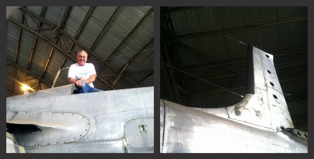

David A and Arnold put up the two antennae, (for you TU grads, antenna's) today and got them all bright and shiny. Will try them out next week with a Ham radio and an antenna tester to see what they like in the way of frequencies. Personally I like two or three times a week, but Arnold said that wasn't what it was all about. Nevertheless, there was a lady visiting the museum today who walked by while the guys were working on the "wires" up top. She asked what those "wires" do and before I knew it, I blurted out that they hold the vertical tail on. I know, I know, I will probably burn in you know where, but I just couldn't resist. She was wearing one of those ugly burnt orange T-sipper T shirt and well, I just couldn't help it. Came out just like that. The funny thing is that she never even questioned it or anything. Just went her merry way. And yes, she was blonde. Not that it had anything to do with it, but.... I better go find another picture before I get in trouble again with the O2 lady.... and no, it wasn't her.... this time. :-) JR

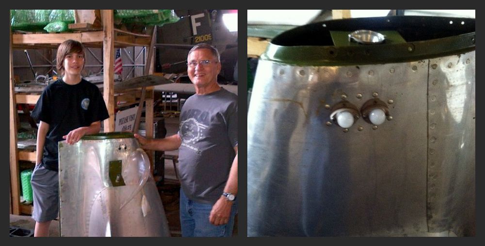

Dave Lester and grandson Ethan worked all day on the tail cone cleaning it up and priming inside while mounting the new formation lights on each side along with the rest of the nav light assembly. It was a really tight fit to get hands inside for the last screws, but Ethan managed to get it done without the thing biting too hard. :-) Dave and Ethan are regulars every Saturday and together they make a fine team. This is a great example of generations working together and passing down skills to the next in line. The boys we are training now will be the ones who work on and fly these warbirds in the future. It is never too early or too late to start. Besides the great fun of working on or operating this A26, it is a living memorial to the folks who flew or worked on them... living history for all to see, touch and hear... and ok, smell when it cranks up with all the oil smoke. Special it is!! :-) JR

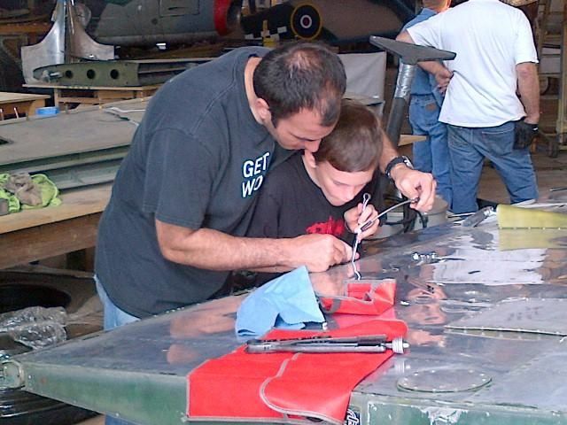

Posts: 2563
Ditto above comments. This is Javier and son Ian removing one of the hinge bolts on the rudder tab. It might take a little longer to get the job done, but it is worth it to pass along some training and most importantly, some enthusiasm for what we do. Ian seemed to have that!! It is a pleasure to watch new generations preparing to fill our shoes. Just would like to make sure we give it our best shot that they do so with full knowledge of what it took to get us this far. JR

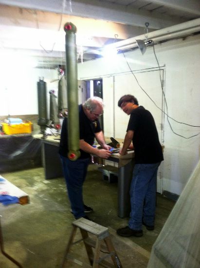

More landing gear wind chimes!! These were primed and hung to finish drying in the wheel well while the paint shop got the next round ready for spraying. We have decided to go back zinc chromate in the well wheels although the insides of the gear doors will be black. There is some disagreement on whether they were black all over inside, but most of the Nimrods remember green and that color would be best for showing up leaks or other maintenance issues compared to black. So there ya go!! :-) JR

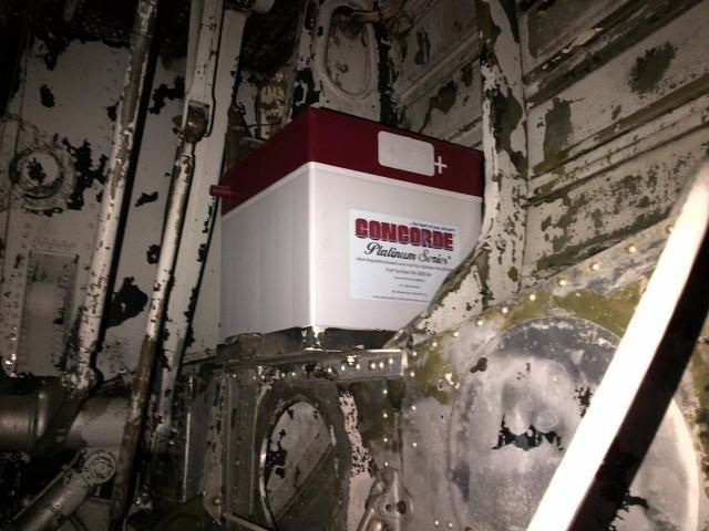

The right side battery box got installed and the left side is about ready as well. That is a full size 24V replica battery to test the fit in the tray. We are still working on converting the system back to the original configuration instead of having two car batteries in the right wheel well. JR

More landing gear wind chimes being prepped by Mark and company. This gear should turn out as good as the nose gear soon. Our main concern is getting the correct manual for the brake overhaul. It appears that the brake assembly is different from the current KC-135 brakes so we are trying to figure out which type was used. They have anti skid and multi disc pads so they are definitely not the original or DC-6 brakes. Oh well, that's the breaks!! :-) I know.... couldn't resist the pun, but have to amuse myself while on whirly thing watch. Got a big line of thunder things heading our way. JR
