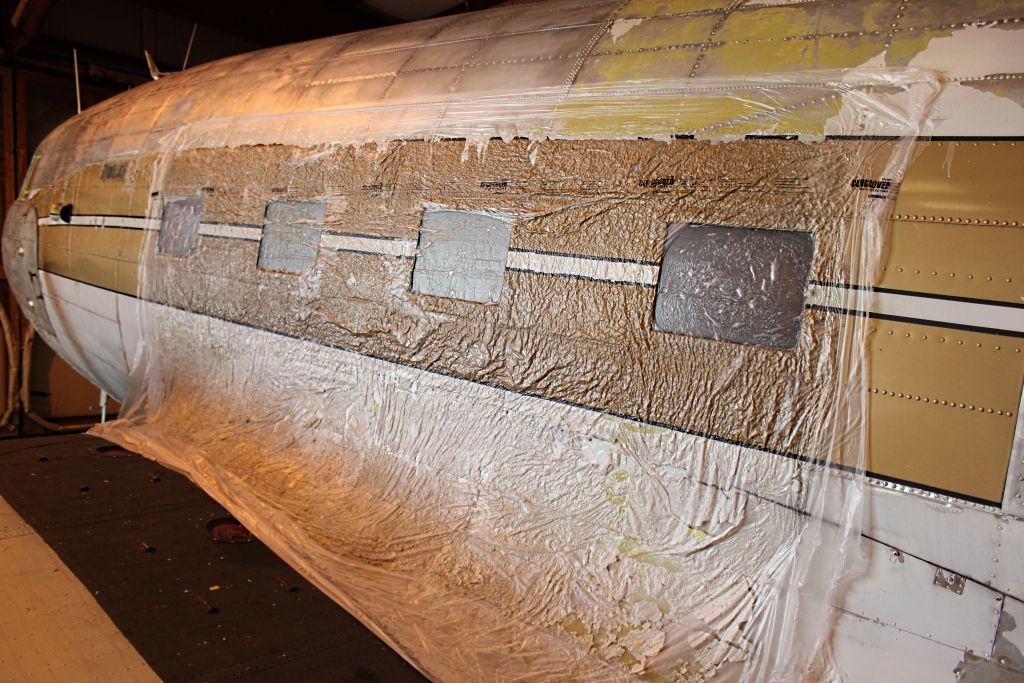

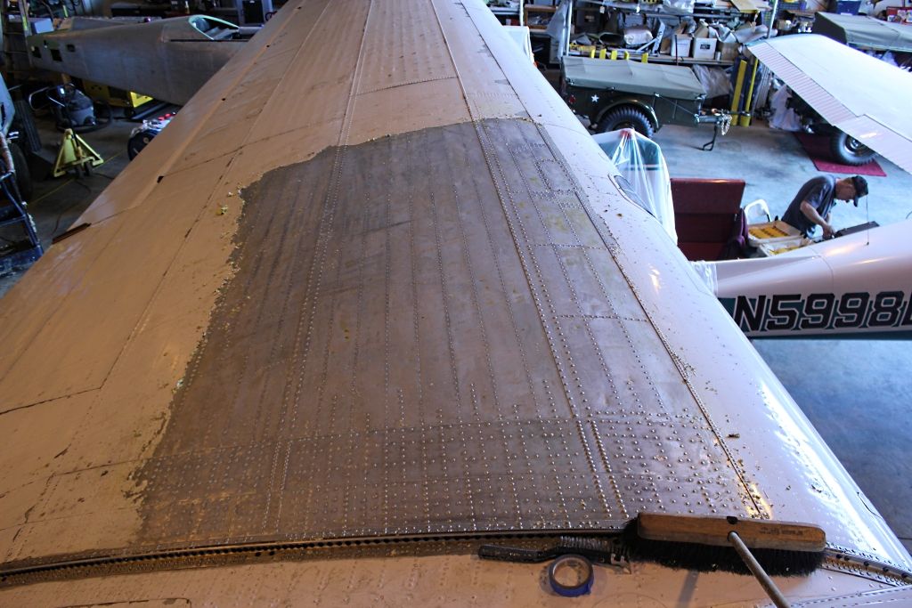

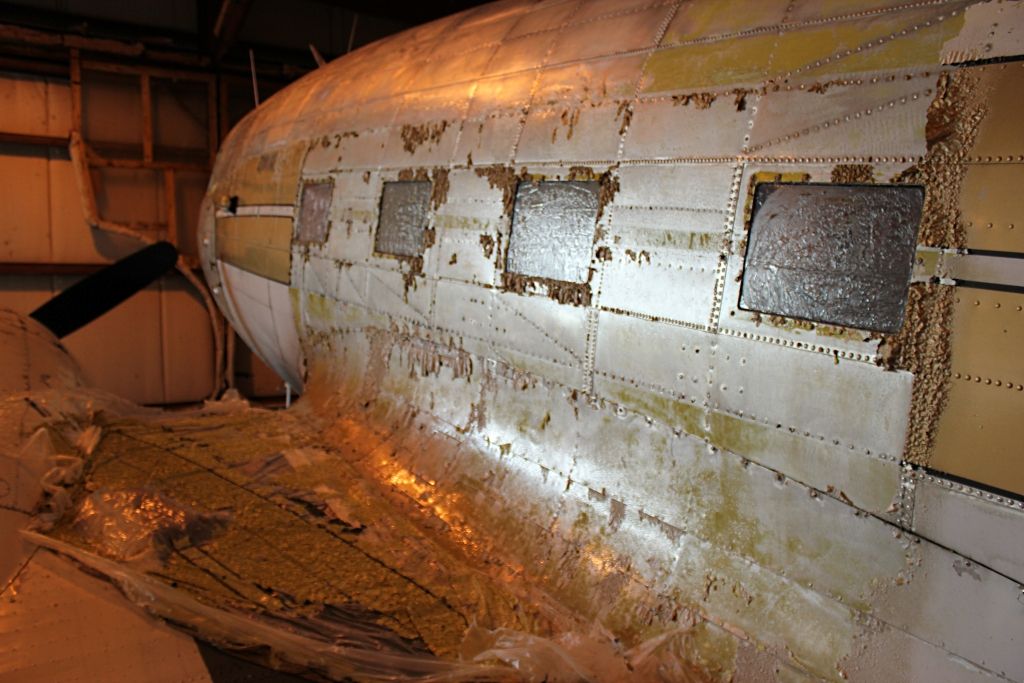

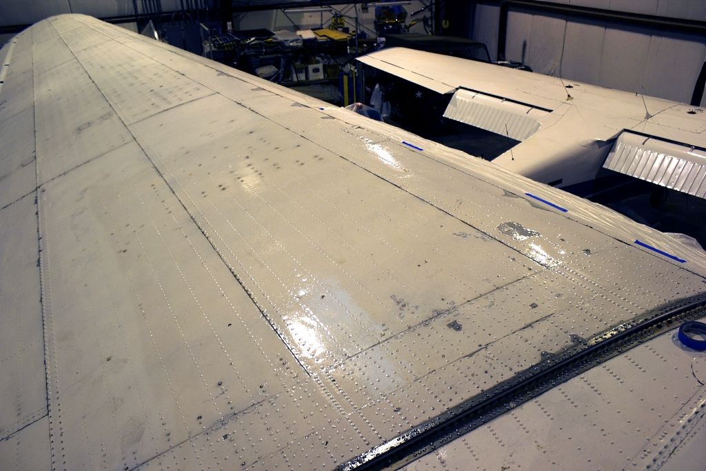

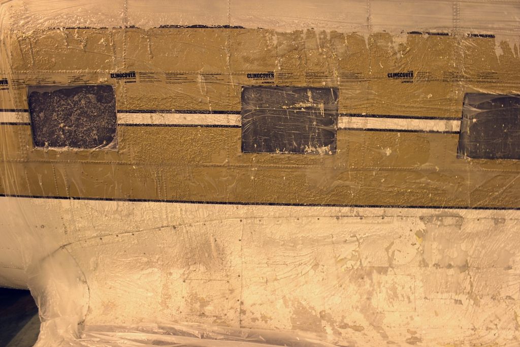

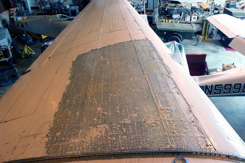

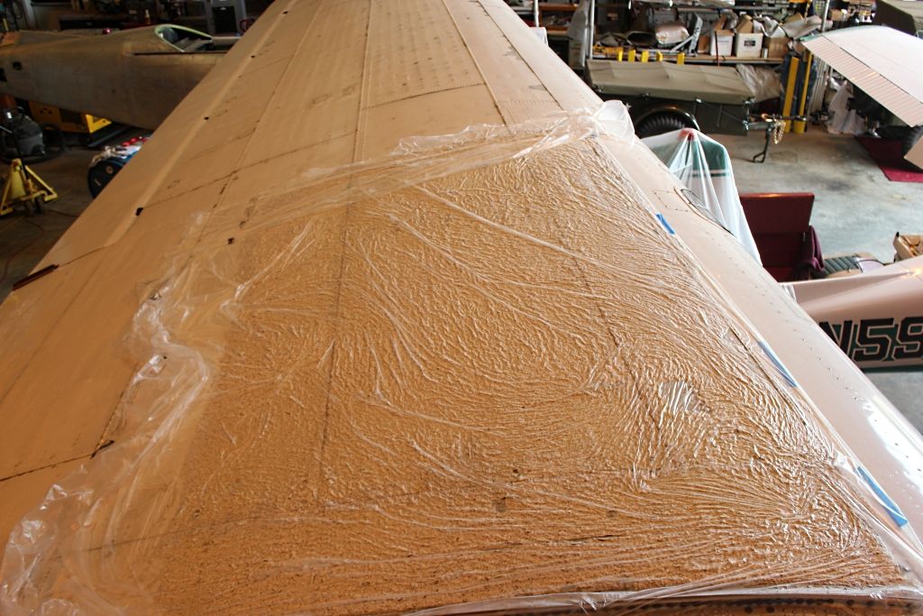

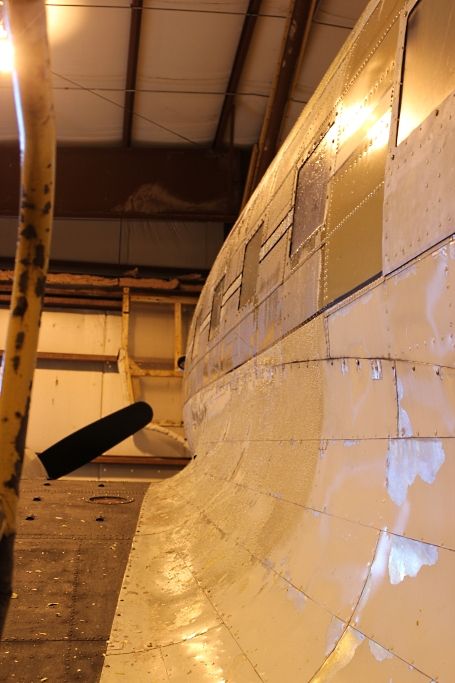

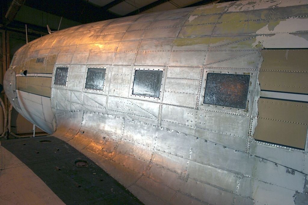

Just a few of the test patches I did with the new stripper and the paint sprayer. The sprayer allowed for a much more even application which I think made a lot of difference.
The paint was all lifted from the surface, but some remained after lifting the plastic sheeting due to it just not addhering to the plastic firmly enough. Either way, using this stuff, saves so much time, its rediculous, in a good way. If all goes to plan, I will have the entire plane stripped Next Thursday and Friday. I plan on applying it Thursday and peeling it on Friday morning.
Then I'm off on a long overdue week long vacation to South Carolina, with a stop at the Fighter Factory and Military Aviation Museum on the way down. Its been over two years since I have had a vacation!
Hopefully, this Friday I will be at the museum and will be able to take some more photos.
Application
About a half an hour after application and covering
The Next Morning....
Removal
AFter Being Cleaned up
Dont worry about the windows. We will be replacing them anyways as they were etched on the inside from the Spraying, so we didnt bother masking them.

Metal looks in great condition!
Magister Aviation
It's all in my book
PostPosted: Wed Jul 03, 2013 4:56 pm
Posts: 1574
Location: Northwest Ohio
Paint stripper, one of the best things ever invented. :drink3:
