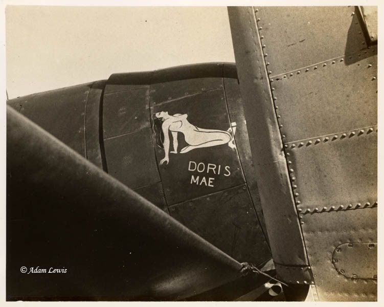

Looks like a relocated panel with the artwork on a new TBM. The complete '87' is missing.
Nice scheme.

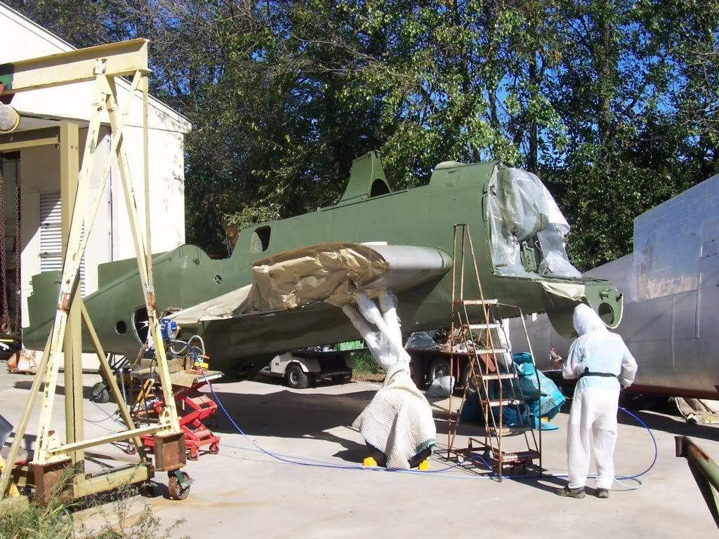

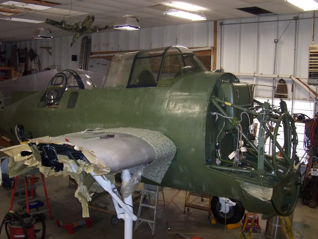

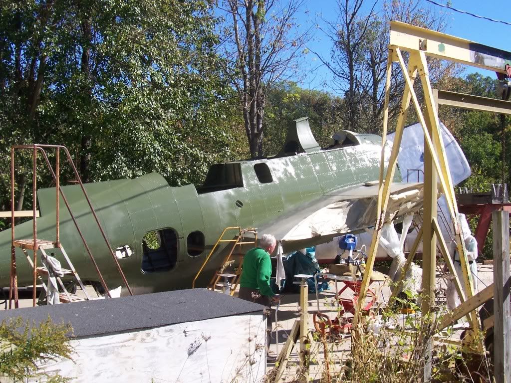

November 2010
Windscreen Installed
Engine mount and oil tank installed. Primer and some final coat paint in areas as previously noted.
Turret canopy and cockpit canopy Installed.
Work continues at Santa's Workshop a.k.a. Jack Kosko and his team of Elves!
Oh yes, Ray at Anderson Aeromotive tells me the engine has arrived up in snowy Idaho for overhaul !!
Happy Holidays!!!
