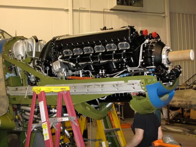

The -9A Merlin is out of Princess. Several components need to be transfered over to the -7 before it is installed.
It didn't take to much to clean up the firewall forward area.

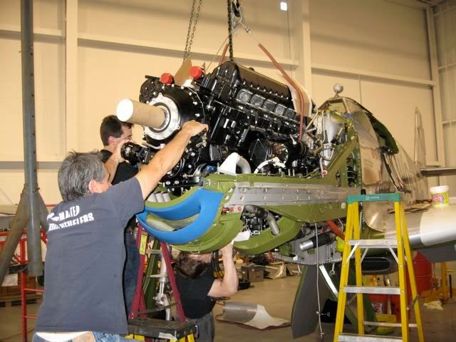

PostPosted: Tue Jun 03, 2008 4:32 pm
Posts: 392
inserting powerplant:
a little further:
and this relationship is consumated. Another satisfied female
Hopefully this one will talk to us the next day ....
