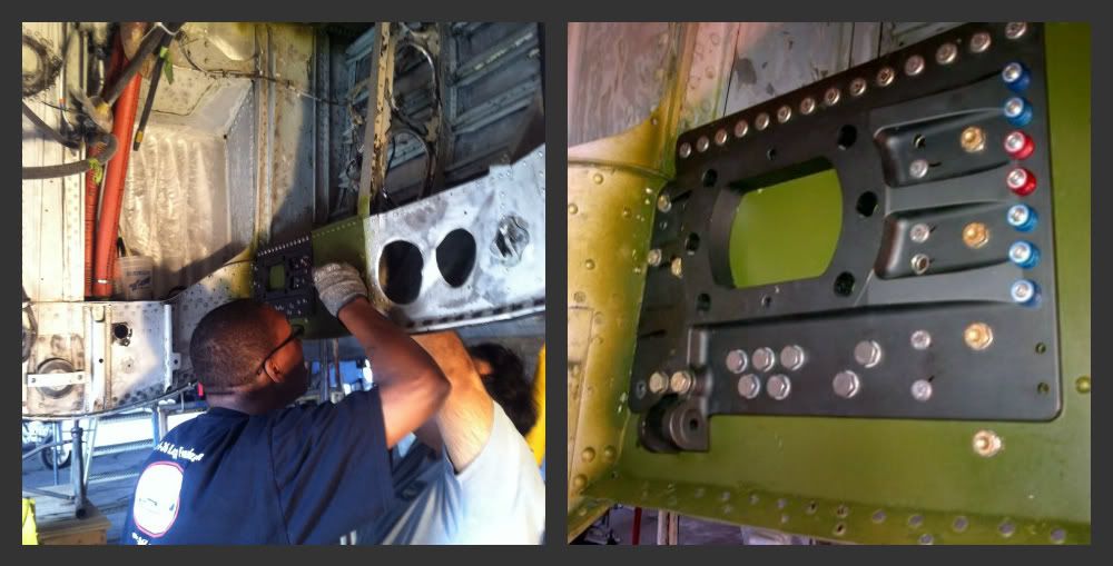

Our two AA guys are shown here about to finish up the trunnion support that was fabricated via our resident engineer, Jerry D. David and Felipe whipped out the ol torque wrench and actually used it. The usual method of just running it up until it smokes and then giving it half a turn was frowned upon by our resident DAR, that would be the real JR so we complied with his instructions about using the T wrench. As stated earlier, we need some tapered washers to finish 3 of the bolts and then it will be ready to start hangin the left gear back in as soon we finish the rest of the work in the nacelle and get the outer cylinder back from plating. All in due time... the other JR

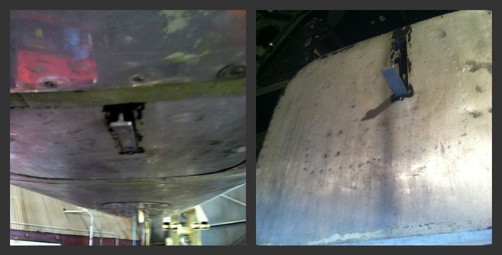

This is the door I referred to earlier, Randy, that leads into the avionics bay where the oxygen bottles are also stored at the top. Door is closed in the left picture looking toward the tail and open in the right. It has this pull down handle that pulls a latch tongue out of the slot. The spring that holds it normally in place is gone. Too bad you didn't have one in your collection. Forward of this door is where there was a machine gun turret in WWII that has been removed. Back in the 50's and early 60's, the airplane served as a target tug. Now there is a plate that covers up the door where the cable and sleeve was let out by the airman who rode in the back and controlled the winch. I bet that was a hairy job at times.. rookies coming in and shooting live ammo at the sleeve and getting very close to you instead, not to mention the risk of a midair collision. Sounds even more riskier than combat, huh? JR
