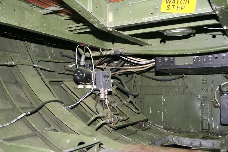

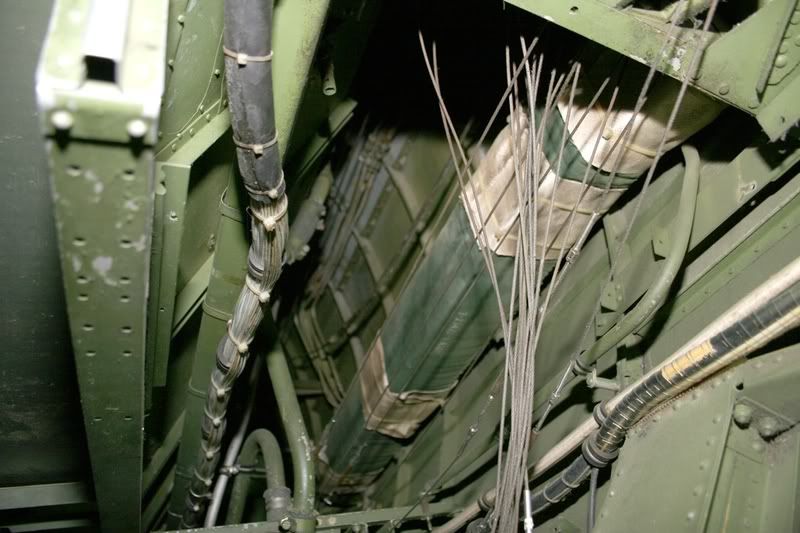

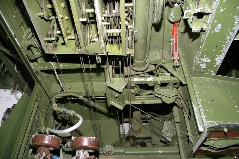

A WIXer asked for pics of the details under the Flight Deck floor, sooo...

Last photo, Hydraulic pump and pressure switch?????

Last Photo is INDEED the Hydraulic "Manifold" I think they were calling it.
And the switch or sensor is for reading the pressure???
I don't KNOW FOR SURE so please don't beat me up on it.

The hydraulic system operates the brakes and cowl flaps. The landing gear is electric, backed up by cranks. The turrets are electro- hydraulic with their own self contained hydraulic pumps. The pressure sensors on the main hydraulic system tells the electric hydraulic pump when to turn on or off when the cockpit switch is in the auto position.

SOOOO is that indeed the pump for the Hydraulic System in the bottom picture?

Without knowing much about B-17's, I can dang near assure you that the piece you're asking about is indeed the auxiliary hydraulic pump, with the pressure limit switch attached.

On the B-17 that electric driven hydraulic pump is the ONLY hydraulic pump unless you count the manual hand pump on the co pilots side which you can use if the electric one fails. Like the gear cranking, be prepaired to get a good workout.
