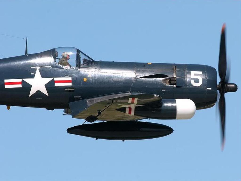

I think we can narrow down some variables. I don't believe this Corsair is a Night Fighter (-5N) variant of the Dash 5. Notice the lack of "Exhaust Stubs" over the exhaust ports. They're missing from both port and starboard sides of the aircraft. I
If you look closely at this pic you can just barely make out the exhaust stub I'm talking about. :D 8)
LOL Perhaps a better pic?
This would lead me to believe that this Corsair is a either a straight -5 or maybe a Photo bird "-5P".
Here's a picture of a Photo F4U-5P:
Notice the camera port on the lower starboard side of the aircraft. This causes the "Stars and Bars" to be positioned further aft on the Fuselage. If u'll look at the starboard side of the Sigonella Corsair in the pics Dusty Dog provided there might not be enuf rear fuselage left to see where the camera port would have been but the "Stars and Bars" are as far forward as the armor plate of the rear cockpit bulkhead. Which would have obscured the Camera port and when use with the port door open would have illegitimized the aircraft's nation insignia. So I'm highly doubting this is a F4U-5P.
Being able to eliminate all the -5N, -5NL and -5Ps hopefully gets us closer to the truth of the aircraft's identity. If this theory holds true then when compared to the chart I posted on Page 5 this would make this Corsair a USS Coral Sea bird. Maybe.
