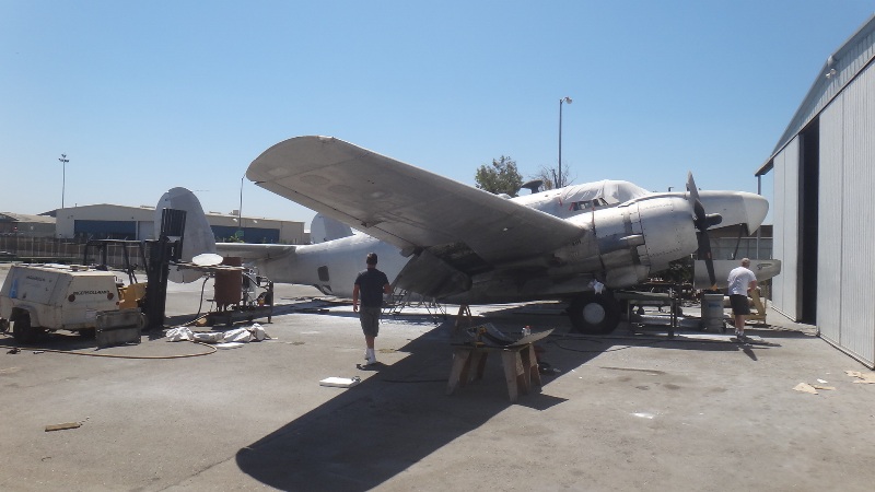

You have seen the end results but I'll back up a bit to show some of effort that went in to achieving the end result.
First the Harpoon was prepped for paint at home. This involved repair, dent removal, crusty screw and Dzus replacement, some body work and lots and lots of cleaning.

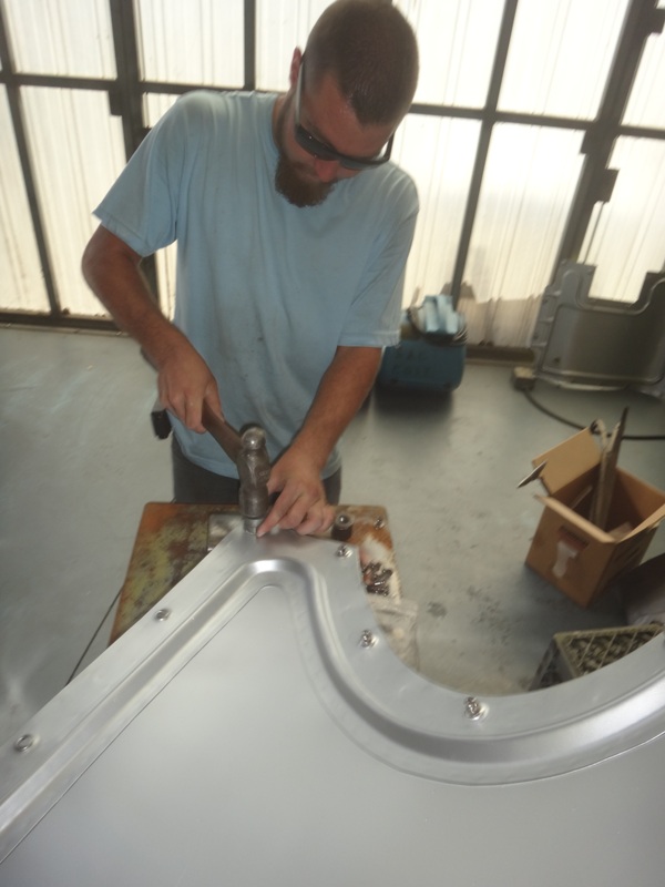

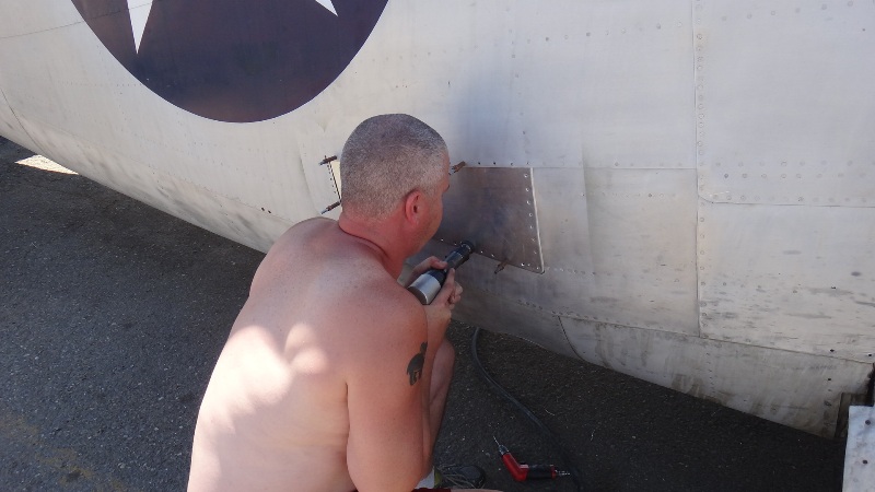

Here is Cade, and Ricky in the inside, finishing up the skin repairs that were started by the Colorado Boys a while ago.
Larry was removing dents and using body filler to smooth them out. The skins are pretty good on the Harpoon but there are a few places with road rash that needed his attention. You can see some of the rusty screws on the left that are some of the many in need of replacement. Lots of new screws to go in prior to paint

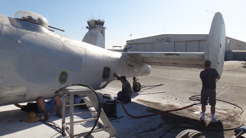

The old markings on other areas were cleaned off with soda blasting. Here is the gang on one of the work weekends going at the endless cleaning and prep work needed

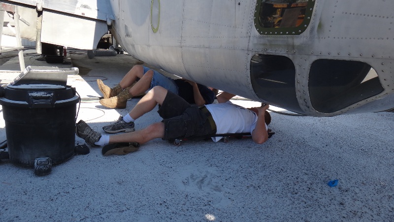

Scott and Ken working on the belly

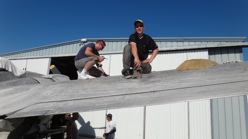

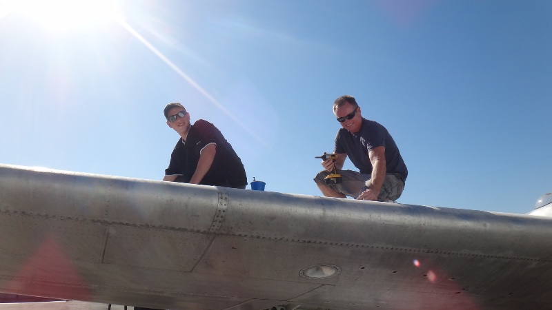

Mike and Ron changing hardware on the wings

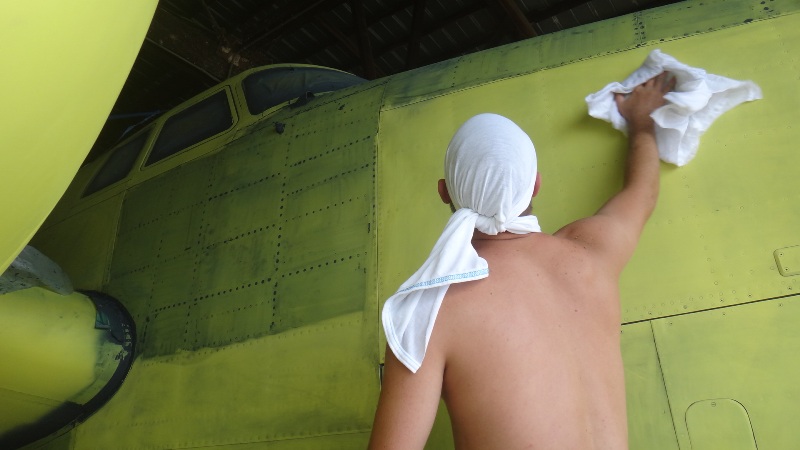

Ron scrubs the flaps with Scotchbrite. Pretty much the whole airframe was cleaned by hand like this to be sure it was clean and ready for primer
Larry and Jeana having a good time working on the Harpoon

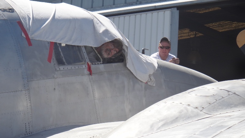

Ken was scrubbing the nose and replacing the old transponder antenna with a new one while Ricky was getting the new intercom up and running
Lots of cleaning and prep. Preparation is 90% of the battle.

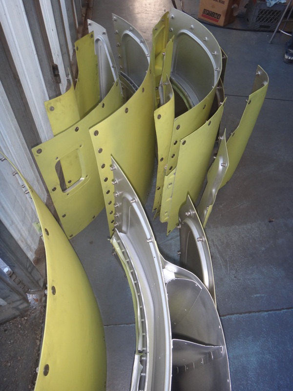

While the cleaning and prep was going on the cowlings came off for their own special attention. The old rusty Dzus buttons were replaced with beautiful new ones that I bought about 30 years ago from an old warehouse in Burbank. I have to wonder if they were WWII Lockheed PV surplus as nothing in that old warehouse was newer than 1945. They were the perfect size for the PV-2 cowling. I thought they would come in handy some day.

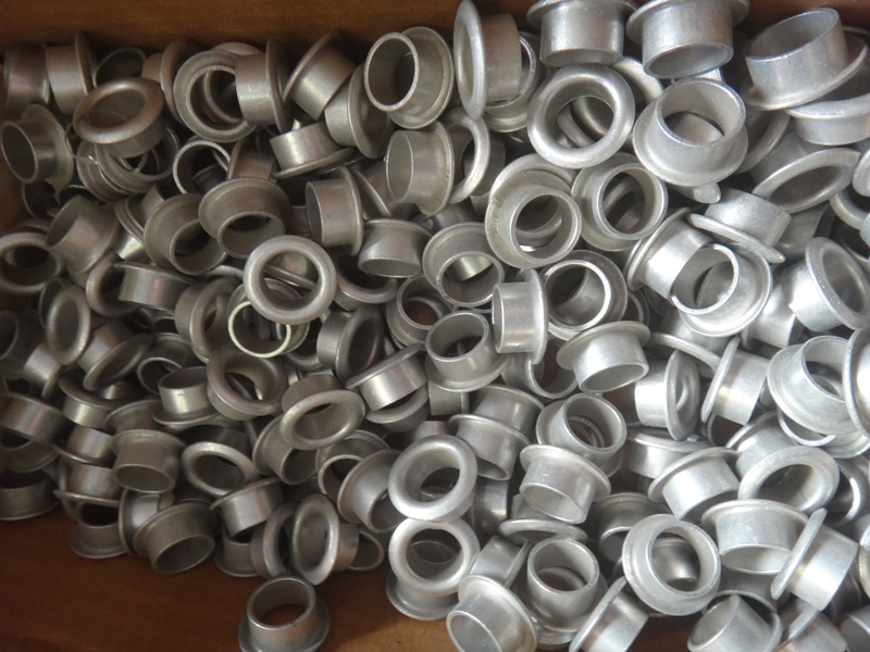

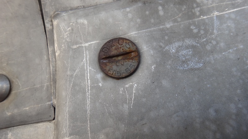

We hadn't replaced so many Dzus fasteners at one time before (over 500) so with a great idea for a removal tool from Rich Palmer we fabricated our own (since we couldn't find one to fit the portable drill) that worked great for fast production work and fast it was. Here is Jeff and Phillip going hard at removing over 500 old Dzus fastener studs by cutting out the collars with the new magical tool. Thanks for the idea Rich!
Here is a shot of one of the smaller Dzus fasteners to be replaced. Most of the 500+ were FA6 1/2's.
Unfortunately we had very few of the correct length collars in stock but a lot that were about 1/8th of an inch too long so we made a tool to hold them and shortened them up to the correct size. A lot cheaper than buying new ones

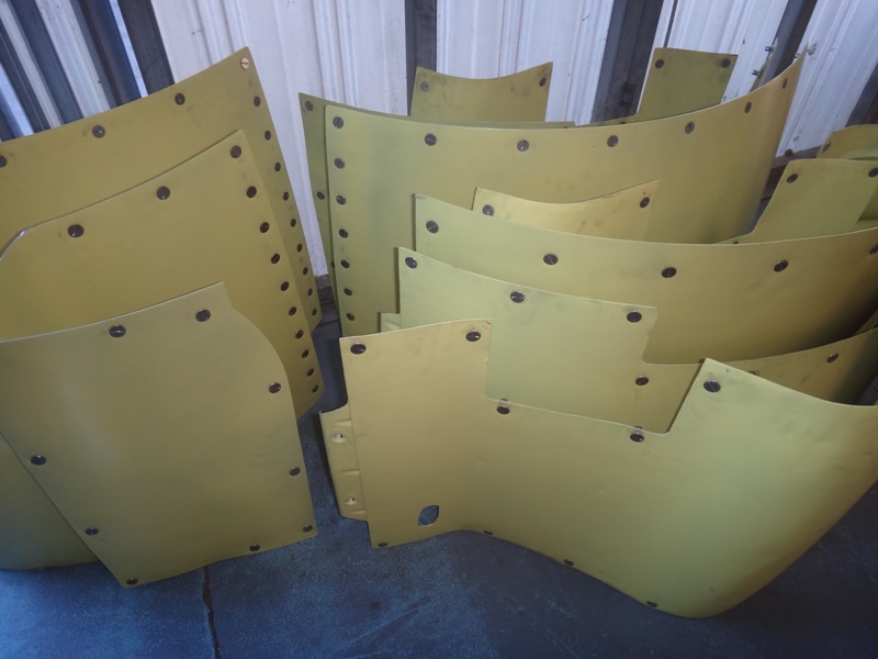

After the old Dzus fasteners were removed the cowlings were cleaned with soda blasting and then prepped with acid wash and alodyne. Then they were primed on both sides and the inside was painted dull aluminum. After this we would install the new Dzus fasteners.

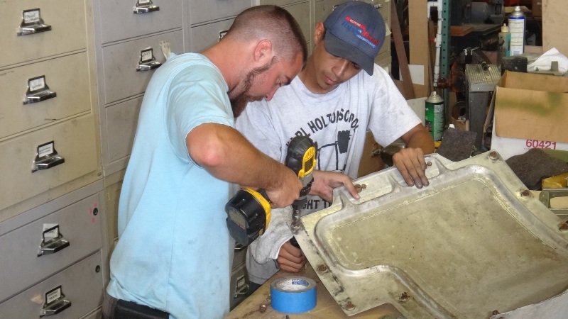

Here are Jeff and Phillip setting the new Dzus studs in the collars in the cowling. Jeez there are a lot of these to do but they turned out great.

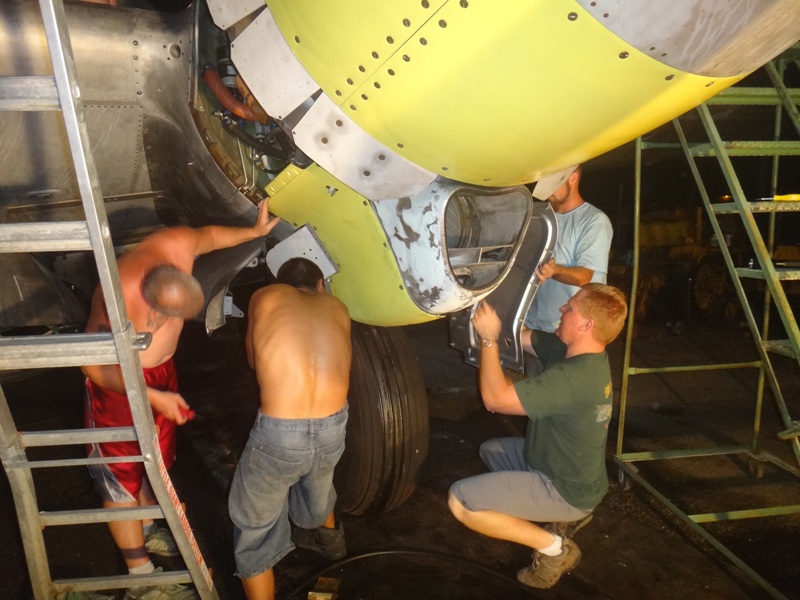

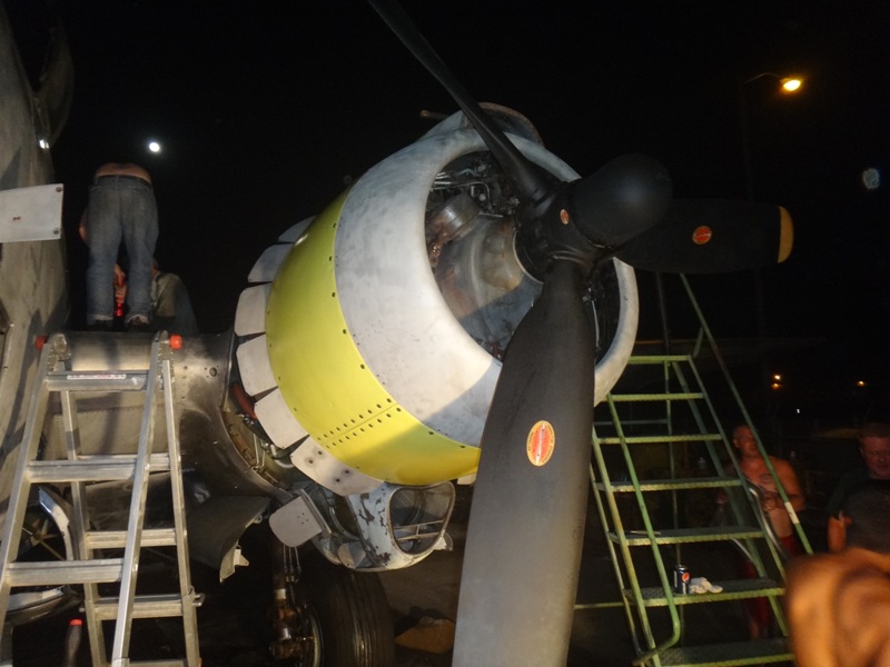

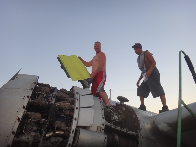

Now the cowling has to go back on so we can fly the Harpoon to the hangar where we are going to paint her
It was a late night getting her all cowled up but the gang pulled through and got the job done

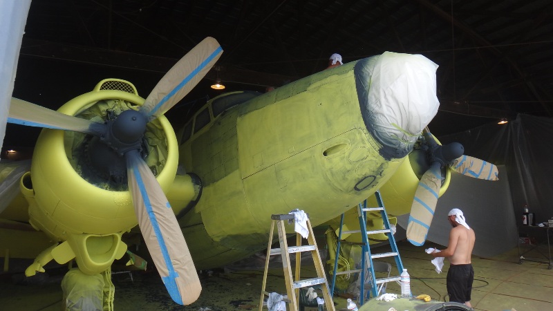

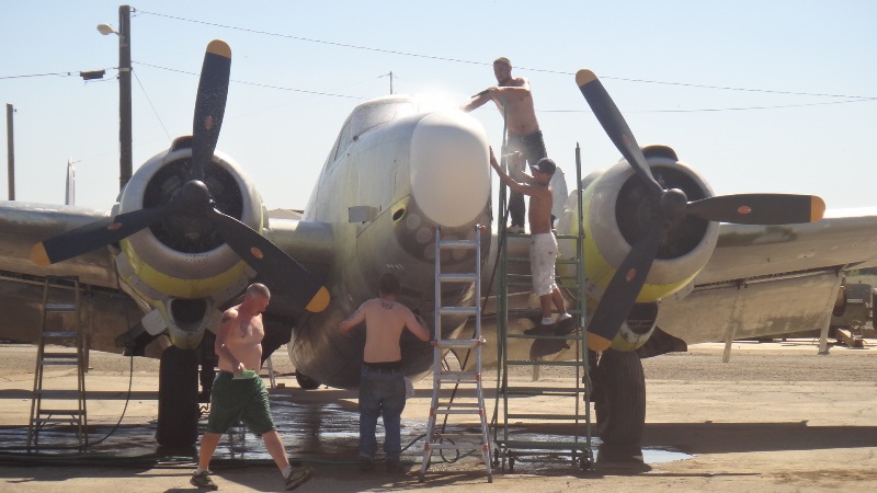

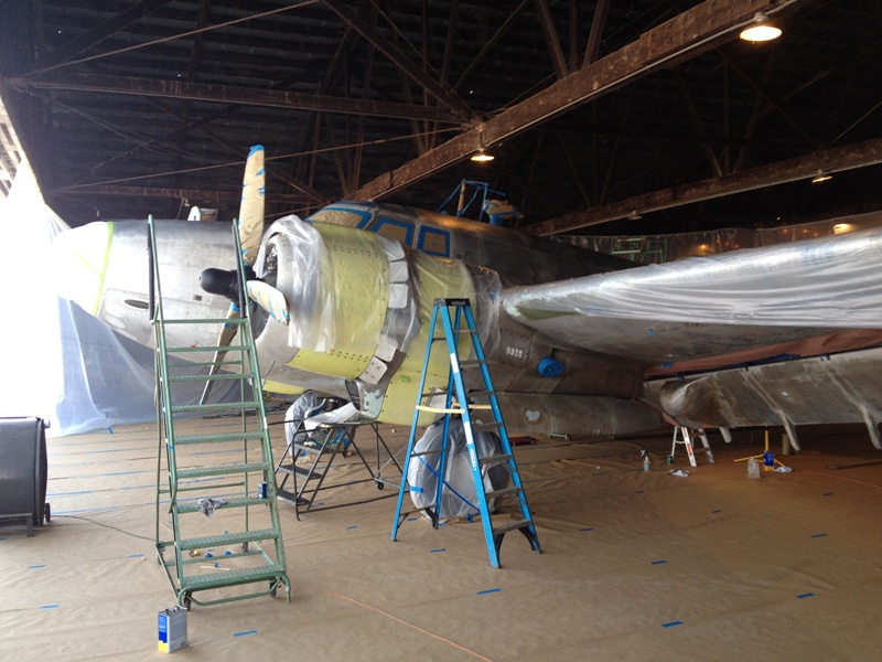

After landing we put the Harpoon on the WWII wash rack and began the final round of cleaning, prepping and masking of the PV-2.

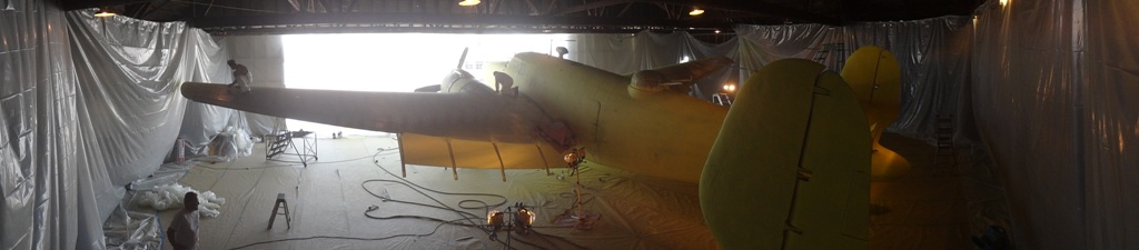

By that evening she was in the new paint booth and ready for more masking
Which happened the next morning

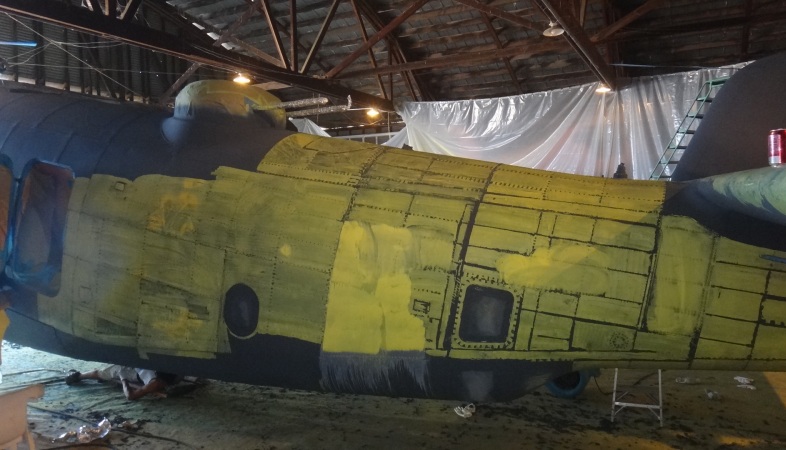

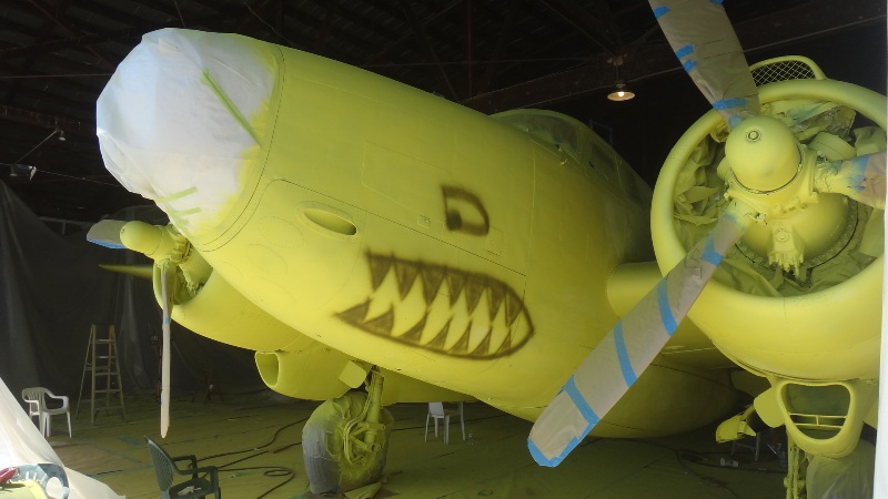

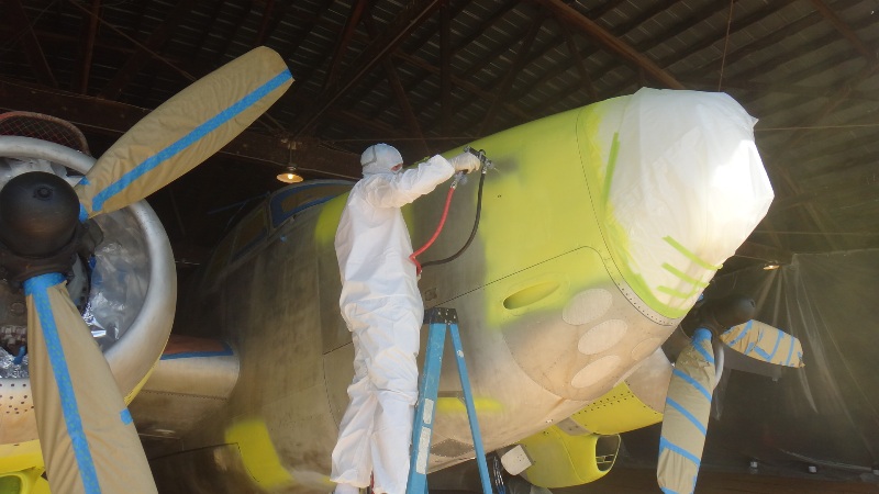

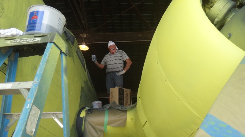

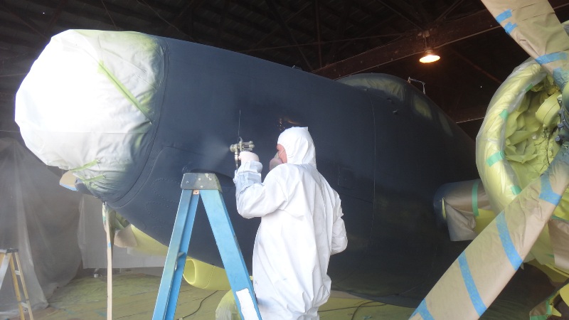

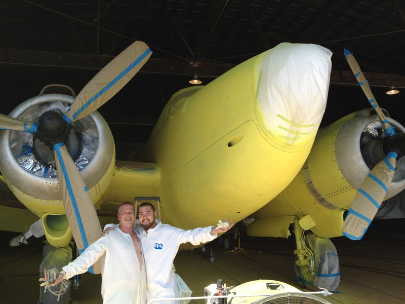

Let the priming begin.
Sherwin Williams was very kind to donate the primer and the paint. Don't much care for the color but the primer is a good one. Beggars can't be choosers...
Cade and Jeff; what a cute couple!

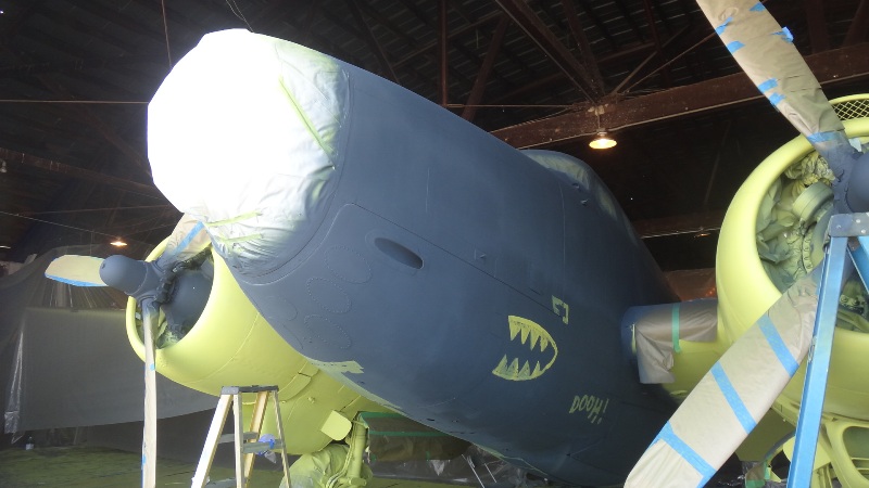

Cade came up with a good one especially for all of you shark mouth enthusiasts here on WIX

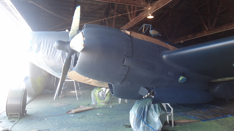

And then the paint goes on. The color looks good but it sure is flat. A bit too flat... Doesn't look quite right but tomorrow, after it cures it will be different, so be patient...

Chapter three of the paint saga. This is where it gets interesting...
After painting the blue on the fuselage and tail we had a wonderful dinner cooked by our own in house cook (he doesn't like to be called a chef). Since we arrived at our outpost a couple of hours drive from home Ricky has been cooking us three square meals a day. I can't remember having three home cooked meals a day, every day, in a long time. Wow how nice that was. We all were working hard and eating well and we all felt great and were loosing weight too.
Funny how the thought of fast food seems repulsive when you are content with home cooking. Thanks for that Ricky!

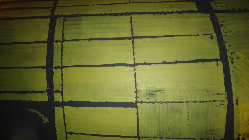

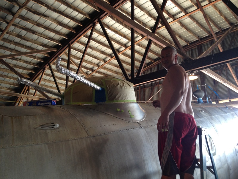

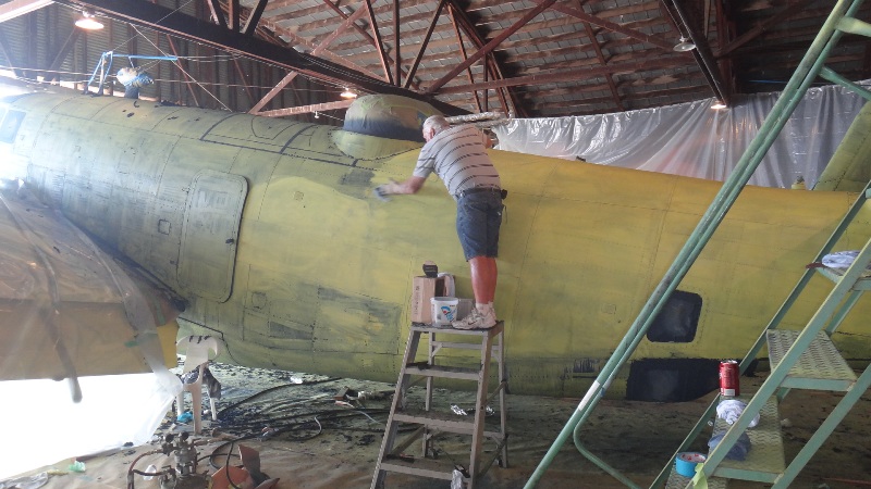

Back to the paint. The next day we came in to look at the new paint and it still looked too flat, if that is possible. The more important thing was that it was still very tacky when it should have been dry. Hmmm... WTF?
Well to make a long story a bit shorter; after a lot of phone calls it turns out that we had used the wrong hardener/catalyst and the blue paint that we shot would never harden.
How could this happen since we used exactly what Sherwin Williams sent to us. Well the folks that sent it said that the paperwork was cut correctly but somehow we were sent the wrong product. I had heard of this happening to other folks but never dreamed it would happen to us after all we received the paint directly from the manufacturer who should know best.

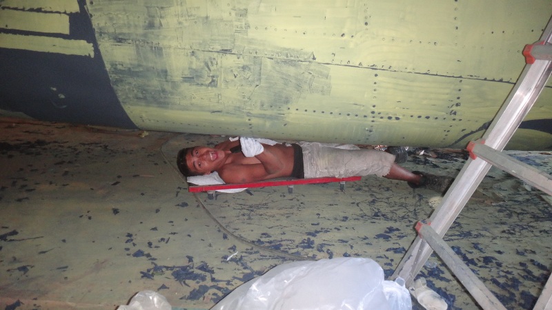

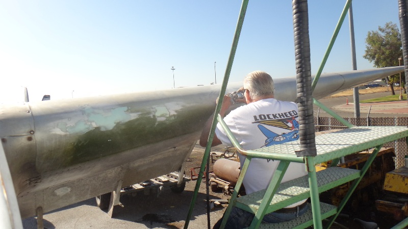

Now the fun part begins. The bottom line was that we had to remove all of the blue paint and do so in such a manner that we didn't damage the primer. If the primer had cured enough then we may be able to remove the blue and be able to still use the primer. How do we remove the top coat? Well the way that worked out best was to use razor blades to scrape it all off and then hand rub it with acetone and rags to get it clean.
Needless to say this was a real heavy blow to us all. Talk about taking the wind out of your sails.
The depression lasted about an hour and then the gang rose to the occasion and jumped back in to get the job done. I have to say that these guys are fantastic. There is nothing they can't do with the positive attitude that prevails.
I also need to thank Sherwin Williams for their support to help us get through this paint disaster. They arranged for me to go to a local distributor and load up on the cleaning supplies needed to remove the paint and get it back to where we could shoot the blue again. They also put together a new order of paint with the proper catalyst and then sent it to us overnight.
When we decided to paint the Harpoon we also set a goal to finish it and fly to the California Capitol Air Show in Sacramento. The idea was Capitol would give us the fuel we needed to make it to Reno for display on the NAHI ramp. We had planned to get the paint done with a full week to spare before the Capitol show in order to have time for any unforeseen glitches and to be able to paint other markings and apply decals etc. In meeting the schedule I made the decision to shut down the shop for a week and use all of the troops to get the PV-2 painted quickly and efficiently. One week of no income is a hard hit for our shop but it is a worthy project so off we went.
In planning for the extra week I figured we would have brought the PV-2 back to Stockton for the detail work but I had not planned on having to spend that extra week stripping and repainting and having to do so away from home. The extra week of hotels, food and more importantly the loss of income was a killer to not only the shop but on the museum's bank account too. The idea of stopping and coming back another time was out of the question so we pressed on and would just deal with aftermath later. LET'S GET THE JOB DONE! was the prevailing attitude. Once again the guys kicked butt.
Even though it looks like Larry is having too much fun it was not a good time. What a pain in the back side...The paint, not Larry that is...well sometimes Larry can...uh, oh never mind...
If at first you don't succeed...strip, clean and try again.

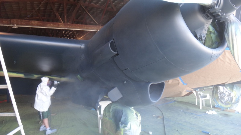

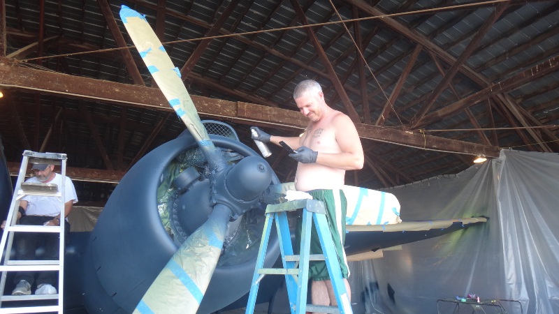

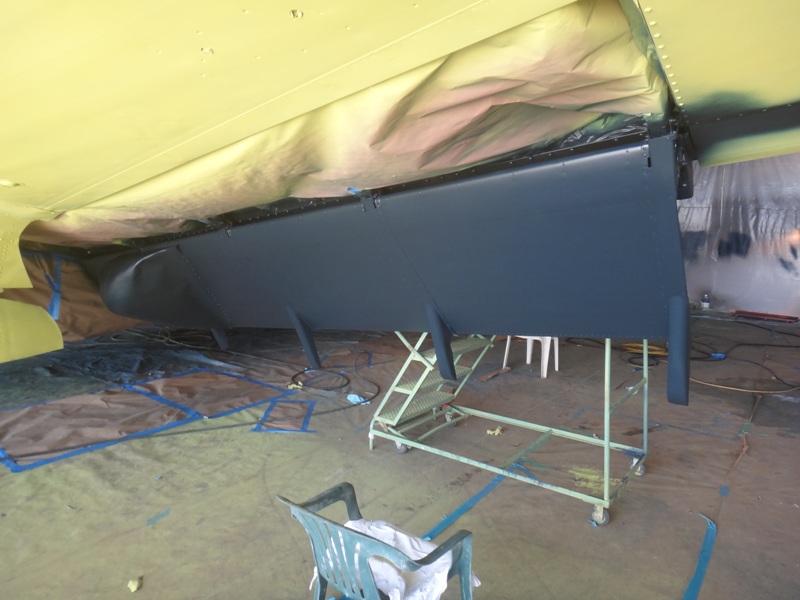

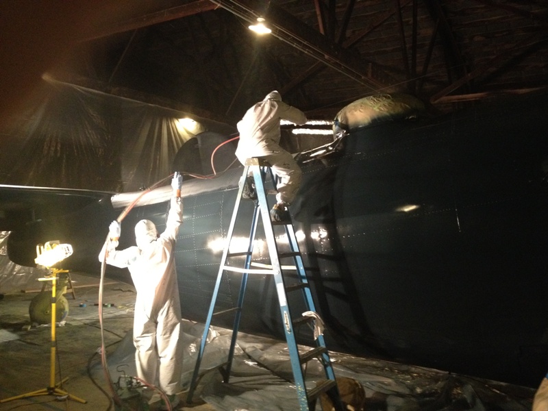

Later that same week with the airframe cleaned up we were able to start applying the blue once again and it was looking much better than before.
Mask the wings and nacelles first then shoot the tail and fuselage. After that is dry mask the fuselage and shoot the wings.
At one point we were worried about running out of catalyst so I called Chuck Wahl and he had what we needed. Larry Gaines (not the Larry pictured above) was kind enough to fly up in his Bonanza to Chucks place and bring down the materials quickly. Chuck also had shot this type of paint a lot so he gave us some great advice on how to get the flat; flat. Thanks Larry and Chuck for your awesome assistance! A lot of people have bent over backwards to help the Harpoon and we are very grateful for all of that help.
With Chucks help and the able hands of Larry (pictured above) and Cade we were able to achieve what we think is the correct finish as called for in the Navy specification SR-2E as amended. The wings and horizontal stabilizer are semi gloss and the rest of the aircraft is non specular sea blue.
Here is Cade, our in house painter, showing the highest painting standards to which he adheres to and his ability to multi task. You should see him paint Gangnam style!

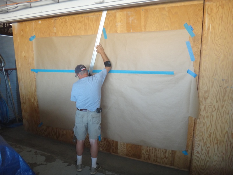

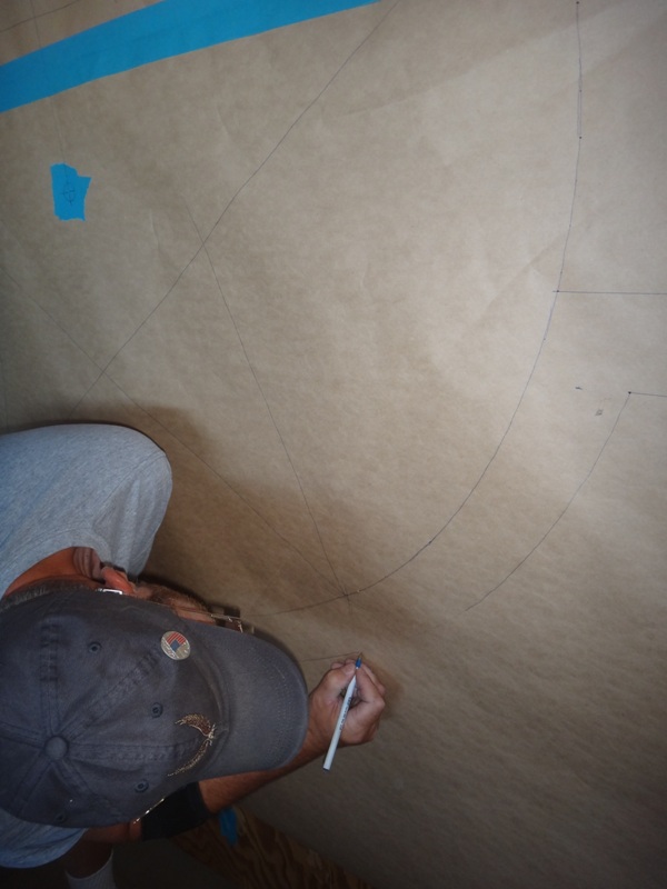

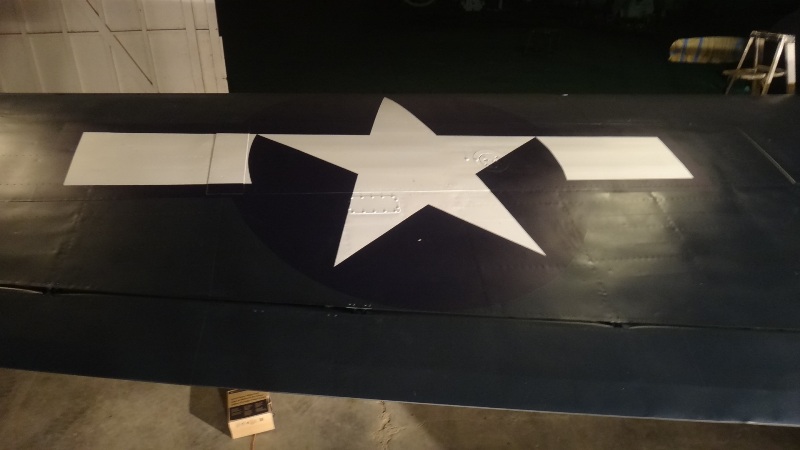

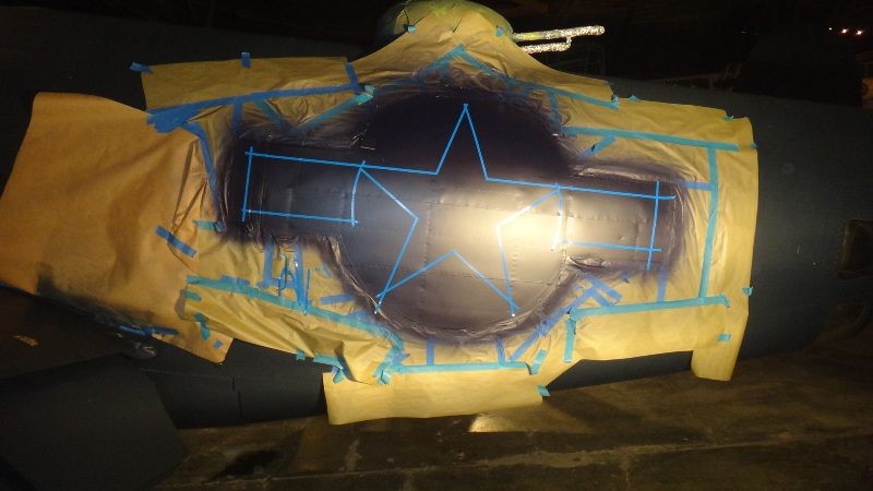

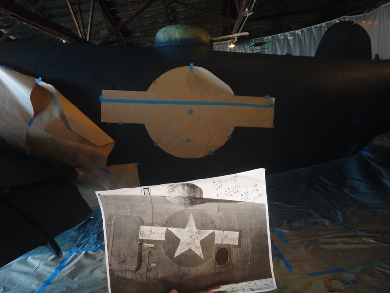

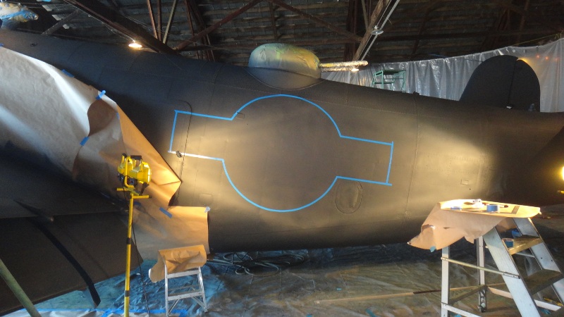

Here is Bernie drawing up the patterns for the national insignias and having fun doing so.

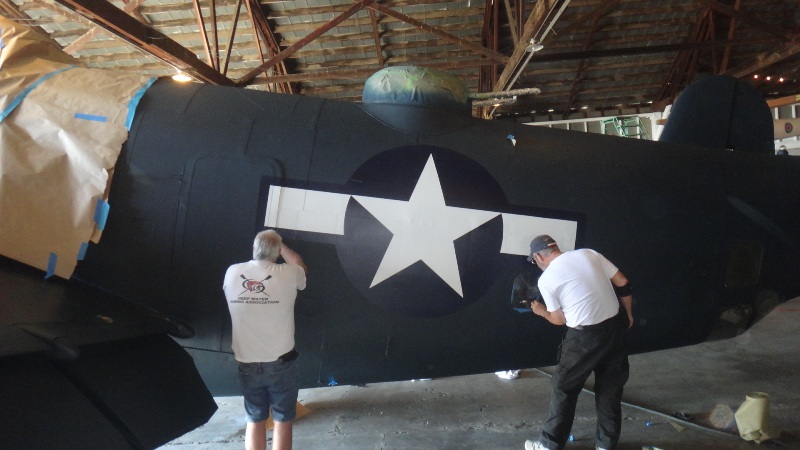

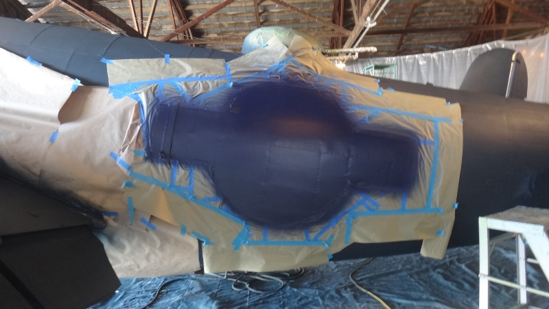

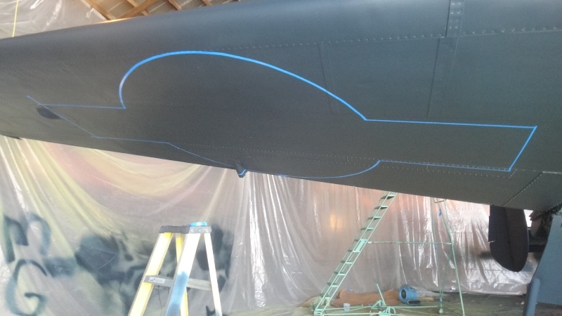

After the fuselage was dry enough to tape, the national insignias were masked and the fields were shot with non specular insignia blue and then the white.
We have a factory production drawing for the size and location of the fuselage insignia which is close but does not quite match. Thankfully we have a photo taken by Brian Baker of 84060 while it was in storage at Litchfield. This great shot of a PV-2 just two serial numbers away from ours gives enough detail for us to scale up the national insignia and determine its correct size and location. It seems the addition of the side camera window in the later aircraft made it necessary to re-size and relocate the insignia on the left side of the fuselage. You just can't have too many photos of these aircraft because the manuals, production drawings and photos all have clues and added together help to document the authenticity. If you do your homework and detective work then it makes it real simple to recreate the paint and markings accurately. This is the fun of it. Finding all of the clues and information and bringing it back to life.

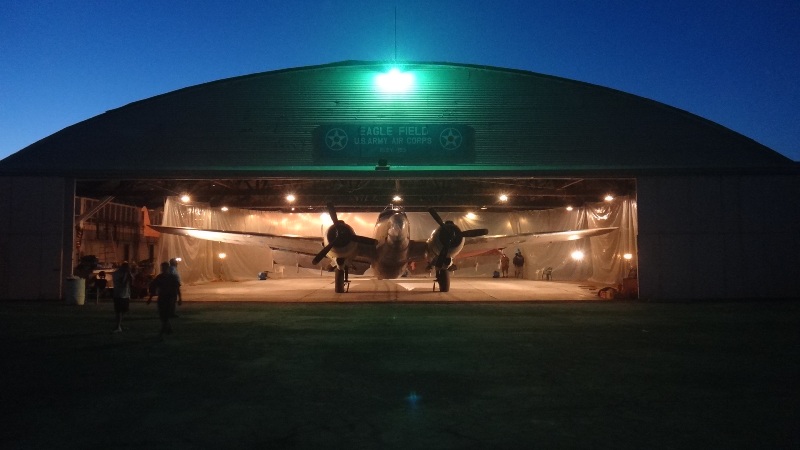

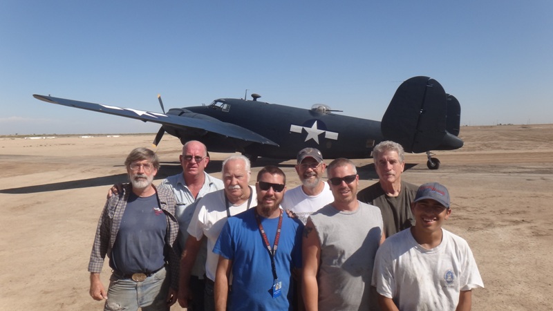

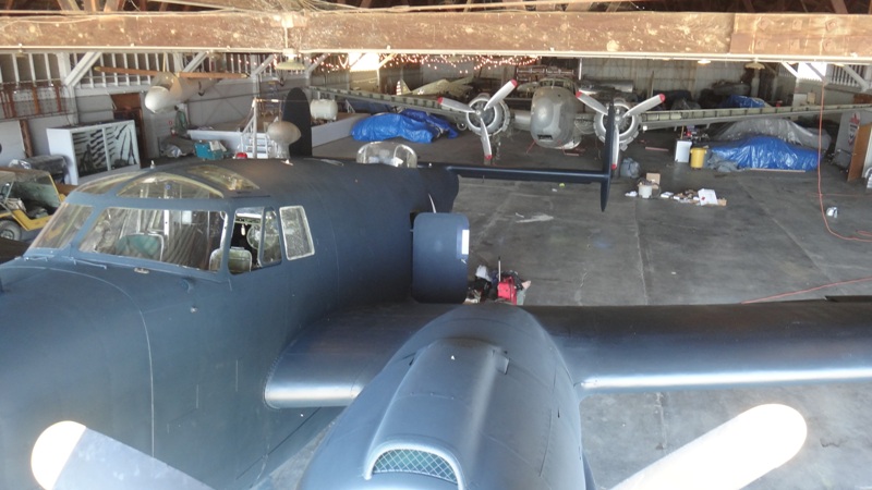

We were all worried how she would look once we pulled her out into the light of day and it was quite the roll out. She looked real good. After several weeks of long hours of back breaking work the end result was certainly worth the effort.
Well done guys and gals. Look what you did!

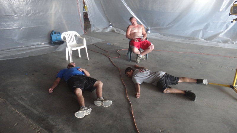

Just a nap. Just one little three day nap is all we need...
No time to nap we have to hurry up and get to Reno.
