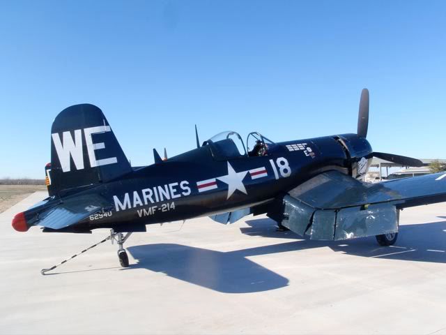

Nelson Ezell did the overhaul on this and it is really magnificent. It's also surprising how compatible the Bearcats are with it.

Posts: 392
It's like a big messy T6. It's very stable and climbs very well. No matter how hard (to a point) you hit the runway is still will be a good landing. The seating position is good for long flights but lots of rudder work gives your legs a workout. The gunsight works which is pretty cool, too. The Spitfire is faster and the vertical penetration is very similar to the Bearcat and the Spitfire. Neat airplane.
Trey Carroll wrote:
Jim, compared to all of the other fighters of the era, in your opinion, what are your thoughts on flying the Corsair?
Congradulations!
TC
Very cool. Thanks for the summary Jim :)

It's the ex-french owned Corsair ? (If I don't made a mistake)
Congradulations!
TC
Congrats on the rating, Jim! Looking forward to seeing you at Key West.
Regards
Yes, it is the former Christophe Jacquard Corsair.
