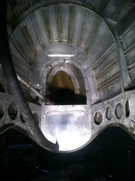

Here is a nice shiny left main wheel well that is getting closer to being finished so that we can get some paint on it and hang the gear again. Mark had this week off for spring break and has devoted a lot of time to stripping the paint.. all 3 layers... out of there. Still trying to get it on the rollers so we can tow it down to Spring Fling on the 31st at Meacham and everybody can see our handiwork. BTW, anybody know what that pulley and cable arrangement does in the picture? JR

Are the cables and pully for actuating a fuel or oil shutoff valve?

Sorta...Dewayne, real close... they run the fuel selector valve!! Kinda important. BTW, the Galluzzi mod on the fuel flow indicator... nobody has guessed "moved the gauge where pilots couldn't see it" yet. I really expected that from somebody like the O2 Ladypilot, aka, Duck Driver, but alas, I guess she is too busy getting her nails done?? But I digress... uh, oh yes... the FF gauge has a diaphragm in it that was the culprit of the wobbly needles. Galluzzi had the troops put a hole in the diaphragm and make it a direct reading gauge. Problem ... and mystery solved!! Many thanks to Jim G for explaining that to us. He now lives in FL and runs his own fine wine importing biz, but I don't think he bores any holes in those corks before their time! Come see us today at Meacham. We will be celebrating St Paddy's Day with the whole restoration team. Cheers, JR

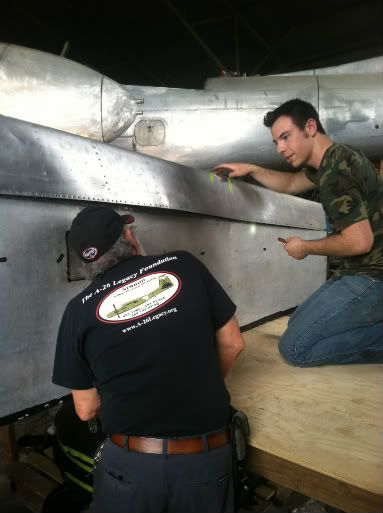

Progress!!! Clay and Miguel are doing some eyeballing on the leading edge to make sure the new rib that Clay made will fit properly against the skin. This replaced the old damaged one that fit just about where the 42 D patch is in the skin. Probably all damaged by the same impact, whatever that was. Anyway, it all lined up perfectly so we are going to shoot some new primer on all of the interior of the leading edge plus the forward spar. Might as well while we have it split and then can start shooting rivets to get it all back together. The elevators are ready to hang as soon we get some material to make the gap seals. The team celebrated St Paddy's day with a pizza party for lunch. Couldn't find any green pizza so we just "played like" it was green. Now that the sun has returned and we can open up the hangar a bit more, having the extra light sure helps to see what we are eating and hammering on the airplane. :-) Don't forget, Spring Fling is only two weeks away now. Looks like our DC-3 will be out of winter maintenance in time to give rides that day. The vintage airplanes, car show, bikes, vendors, food, helicopter rides, WWII vehicles and re-enactors, the Flying Musicians, are all just about lined up for the shindig. Hope we see yall there!! Going to be great fun. Ck out our website for information, tickets and discounts. http://www.gga1.org and also, http://www.pacificprowler.org on the Facebook page for pictures of some of the planes and cars etc that will be there. Cheers, JR

Mark and Denis got the left main wheel well just about cleaned out and alodined. Hope to shoot paint this week if conditions permit. This was one big chore trying to get all those layers of paint out. Kudoes to these two hard working guys for going the extra mile to git er dun. Thanks, JR

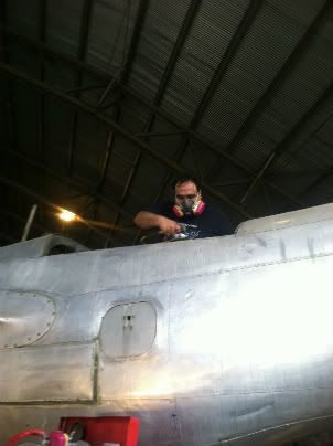

Felipe E. got started on cleaning up the doghouse and prepping it for paint. In doing some checking of the manual, we identified the pedestal that housed the controls for the recon cameras that would have been mounted in the bomb bay. They were probably removed long before the K was taken out of training service as the slots are covered by military installed panels. There are still nav radios and indicators back there so obviously there was a manned position associated with it at one time. This area was originally painted gray unlike the cockpit which was painted black. We will go back with gray on the interior of the doghouse. Once we get the interior all painted, etc, we will install the canopy frame with new glass. We are looking for seats to go in this section that are similar in action to Flight Attendant seats in airliners... the kind that automatically retract the bottom when the weight is off. It appears we could install two positions there in seat tracks so they would be removable for access to the tail cone and avionics bay. JR has so many great ideas!! Cheers, the other JR

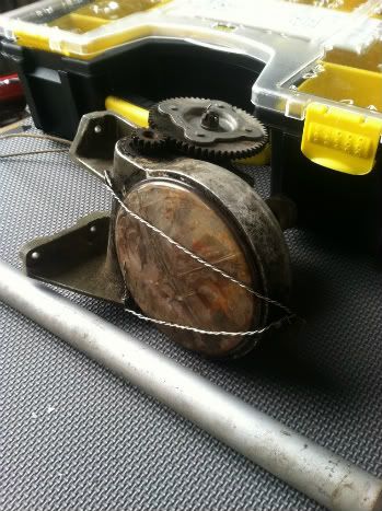

We were very pleased to have a package delivered this week with this gizmo from Houston. No, not from the space program formerly known as NASA before the current administration gutted it, but our little ol "funny bomb" replica maker, Jason, his own self. Seems he has been pack-ratting some A26 stuff for his art work and generously offered to share. OK, game on... what does the gizmo do?? PS, many thanks, Jason. This helped us out a bunch!!! Cheers, JR

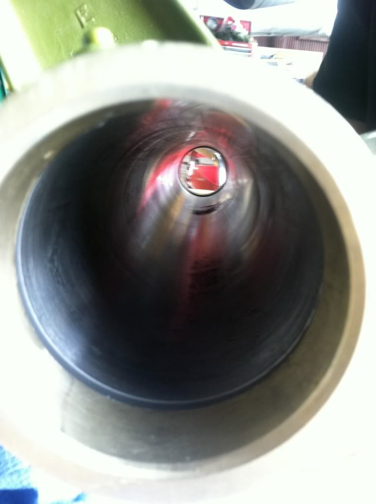

Another problem child... see the pitting inside toward the other end of the gear leg? This corresponds to a support arm that was welded on the outside during original manufacture. Looks like it finally caused this rusting. We will have to send it out for replating and boring. This will cost us some more time, but there are other things to work on for sure. JR
