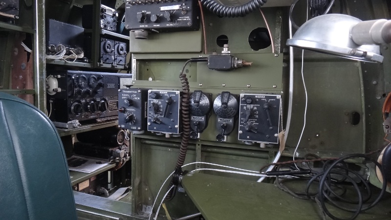

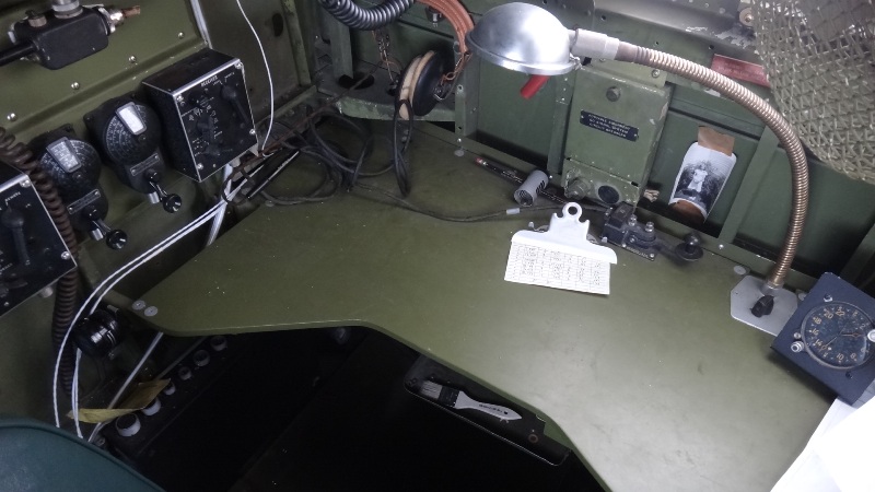

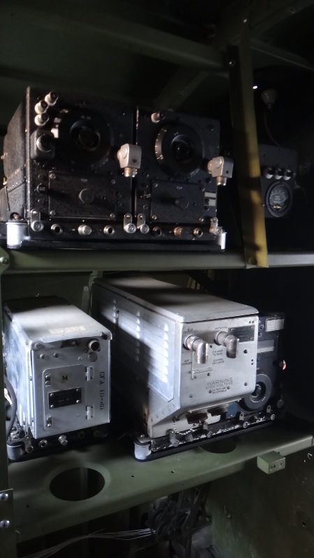

Its been way too long since I have been able to work on the PV-2. As I get back to work I was posting a series of before and after photos for a WWII radio group so I thought I would post them here too.
And a few of the radio room too
