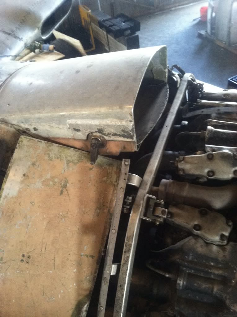

Here is another difference between the stock A26 and the K. The air intake for the carb was moved aft and placed on top instead of being in the leading edge of the cowling. Anybody know why this was done? Hint: Jim Galluzzi knows. JR

Cowling?
I know, I know, but I won't spoil the fun. It's not just because the sheetmetal guy was bored.
It is performance related. It relates to a deployment of the Ks before Vietnam...

Would it have something to do with "propwash" affecting it?

Location: Waco, TX
Didn't the K-model have R-2800-CBXX models vs the -71/79 models of the original models? Did the carb and/or carb location on the blower change? Maybe the different props and reversing feature might have messed up the original intakes' flow. Would love to see the engine differences on SpecK vs the old SofW. It was pretty room-wise tight to begin with...but I'm 6'5", so I had to work from the 'outside' anyway, couldn't get 'inside' with it.

Actually the carb intake was on top, center leading edge, the alternate air filters were inside the cowlings.
I would expect that the CB carb was mounted differently that the standard engines. Did they get rid of the alternate air filters from the Ks ?

Wasn't that part of the "congo mod" for hot weather deployment?

I was going to say, the standard CB location is on top of the engine, so I would suspect that the change had as much to do with any hot weather deployment as it was stupid to have to deal with all that duct work to feed the intake.
