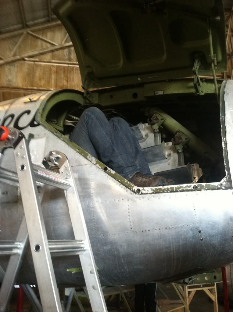

We got to wondering where we might be able to store some pig meat once we are done out at the ranch so one of our illustrious volunteers got in the nose to assess that compartment. We also looked at the bomb bay and rear compartment. All in all, we think we are good for more than 4000 lbs. If we could just figure out how to put some containers on the wing racks, we could triple our load. I mean, if the Spitfires could be modified to carry beer kegs under the wings for the hop over the Channel during the Big One, why can't we figure out how to hang pigs under em?? Dressed out, of course... well, whatever is left of em after the 50's get done. You get the idea. I guess if Dean finally delivers on the keg, we could hang that in the bomb bay to cool. We might have to climb up a bit to chill the meat so why not? Love it when a plan comes together!! :-) JR

PostPosted: Fri Mar 09, 2012 11:31 pm
Posts: 329
Location: Loris, S.C.
That shot of the feet in the gun bay brings back a memory. I once had to get up in there to change out a relay. We once had a case of what they called "runaway guns". Pilot said when he released the trigger, the guns kept firing for some time. After some communication back to the states with someone,(have no clue who) it was suggested that we change out a relay that's up in there somewhere. Wasn't a real pleasant job as I recall, having to change it on the flight line in the sun. I think they called it a gun firing relay or something. Only thing I recall is it having a lot of wires on it.
Wouldn't be a problem for me today, as I doubt seriously if I could fit in there anymore!!
Randy, what Denis is actually doing in there is trying to take out the remnants of the canvas curtain that separated the gun compartment from the cockpit. It had a zipper on part of it so it could be opened to access the back of the instrument panel and radios behind it. There are some electrical components in there as well. We have to replace this curtain, and the way it is mounted, the nose will have to be removed to get at it. There is a plan to do this depending on whether we get new radios donated since we will have a lot of work to do on the panel. More about this later. Cheers, JR

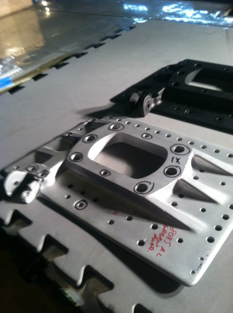

Time for a new game: "What is wrong with this part?" Any keen eyes out there?? We have the old trunnion support and the new one (black) for comparison. If you spot the main problem, what does that section do? Game ON!!! JR
Cracked and missing portion of the attach fitting on middle L/H photo

Posts: 2561
Rick... sharp eye, you spotted the problem, but what goes on this attach fitting? Any idea?? Jerry D. delivered this newly fabricated support (black) today and it lined up perfectly. Nice to have an engineer with connections!! Thanks, Jerry. JR

PostPosted: Sat Mar 10, 2012 4:24 pm
Posts: 2561
This is about where the support will go in the wheel well.... just a little lower than shown. Clue, the attach fitting will be on the lower, forward side of the support. What will be attached there to this fitting?? It is so nice to think about parts going back on instead of taking them off!!! The wheel well should be finished and ready for paint by next Saturday!!! Yea!!! :-) JR
