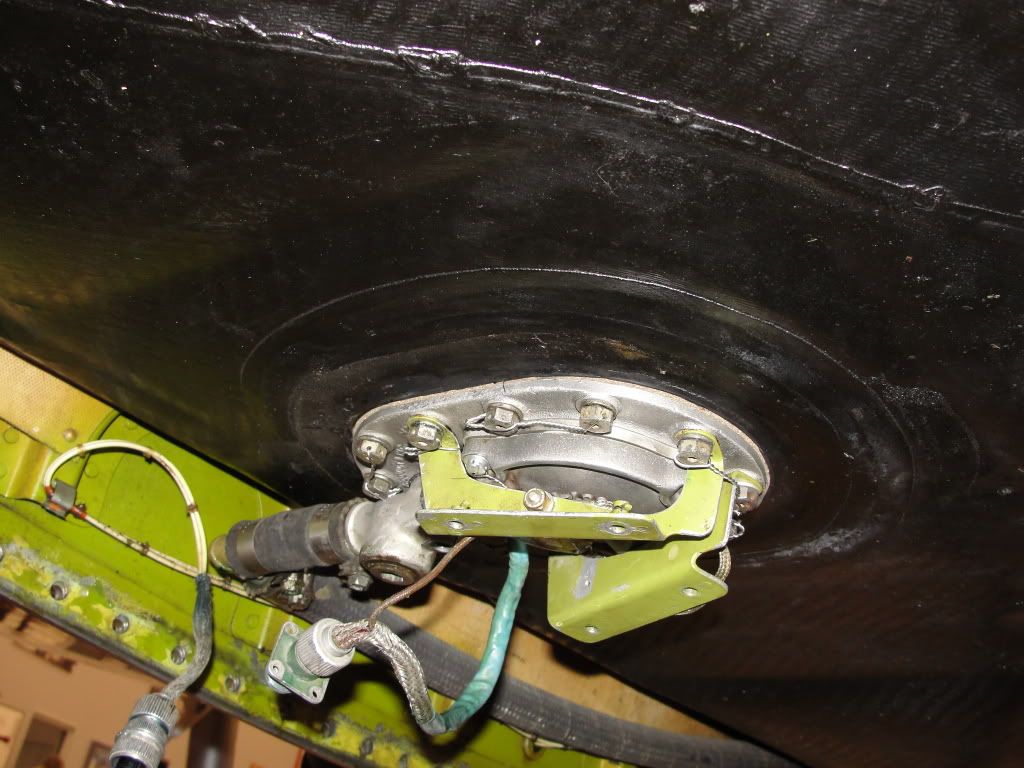

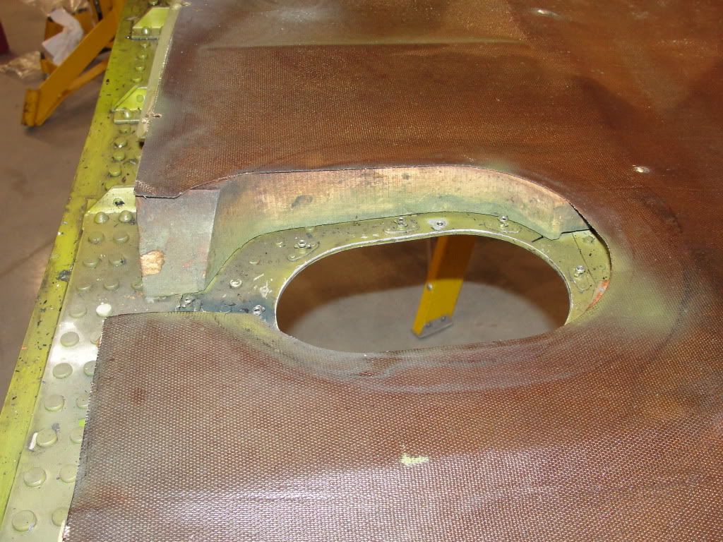

We are progressing here-

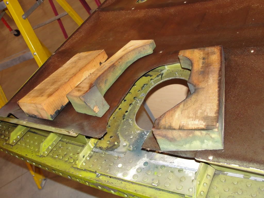

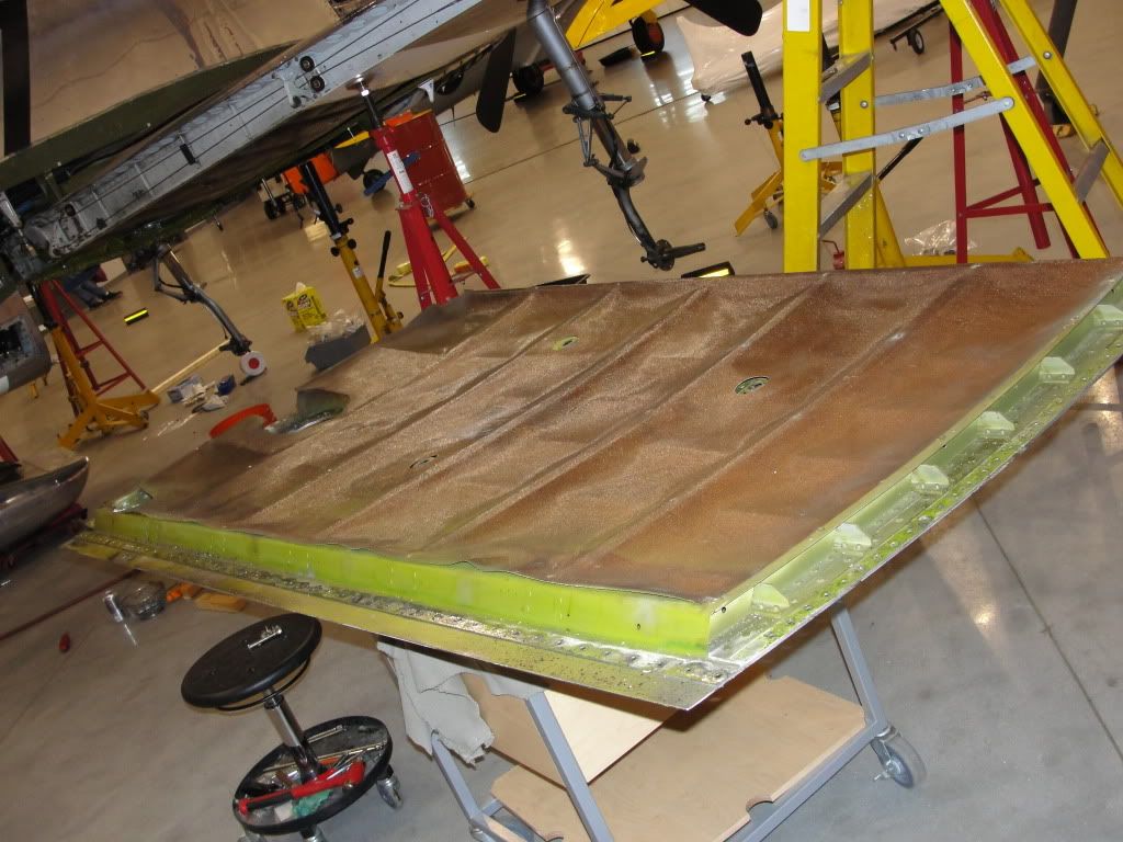

The stress door that covers the fuel cell and bolts the lower wing joint together.
Inboard view of the boost pump area. Note wood blocks between the inner liner and skin.
These wood block are Balsa Wood.
View of the boost pump mounted in the lower, inboard fuel cell.

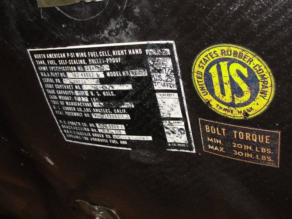

92 gal Fuel cell.
Markings on the fuel cell.

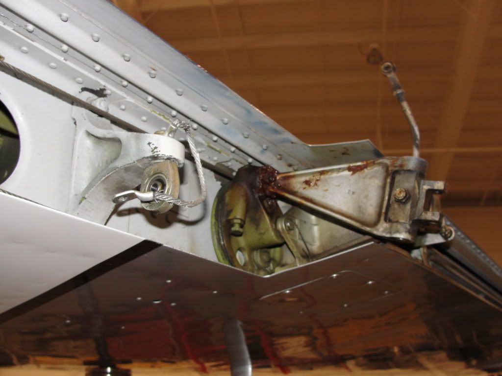

Rear Spar with the Flap removed. Aileron inner sector pulley. Fork attached to a rod hanging is what moves the flap. Large tubes with hose and hose clamps are coolant and oil lines.
Outer Aileron Sector that actuates the aileron. Out board flap mount visible.

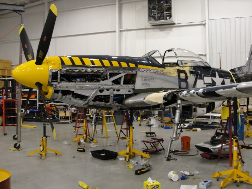

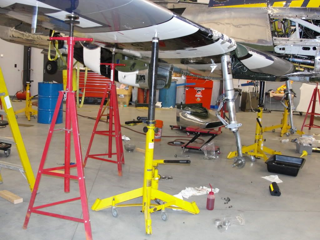

Just curious Rich, how did you find the wear in the main gear trunnion bushings? Was it noticable when you took the weight off the mains or ??
http://www.heritageflight.org
http://www.bravo369.org
PostPosted: Tue Nov 03, 2009 10:52 pm
Posts: 3160
Every time I jack the A/C I check the amount of play in the MLG.
Wear has been increasing.
It was also used by Hoover many years ago along with a couple other wild rides.
It is time to take a look at some areas not seen for many years.
Rich

Thanks fpr posting these Rich - some nice original details on the fuel tanks there - can I ask what the size of the data panel is on the tank pls?

Posts: 3160
Data stamp is 6 1/4" x 5 1/2"
Round is 3"
Bolt Torque is 3 1/4" x 1 7/8"
Rich
Rich Palmer
Remember an Injured Youth
benstear.org
Don't Be A Dilbert!

51fixer wrote:
Round is 3"
Rich
Thanks for taking the trouble to check those for me Rich :)
BTW - are they all decals (or is the data block perhaps a paint stamp?). I am guessing the torque placard and Rubber Company logo are.

Technically, the fuel cells are self sealing and not bulletproof.
Bulletproof is more Supermanish.
Self sealing is technology that included a gel substance sandwiched between the inner and outer layers of rubber. When fuel contacted the gel it would expand sealing the leak off.
