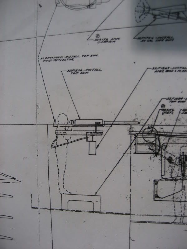

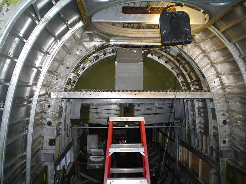

As to the top gun position, I think they will have to reroute some control cables to do this job..not terribly easy.
You can see the top gun ring location in this pic of the B-24A.
This is the only drawing that I have seen of the gunners position....

One of the major problems with the B-24 was its weight and balance. The B-24A was even worse and the nose extension was primarily to help resolve this. It didn't help much, but it was something. No one I ever talked to with the squadron, including Gary, had any desire to ever return the nose to its original length because they were concerned that the loss of what CG envelope they do have wouldn't be worth the cost. As it is, the aircraft will already have to be put into a jig to be able to put the bomb bay doors back on, imagine the jig required to hold the airplane true while you removed the entire nose.
As for the control cables - the original runs are still in place, so the re-route shouldn't be too bad, but it was low on the list.
