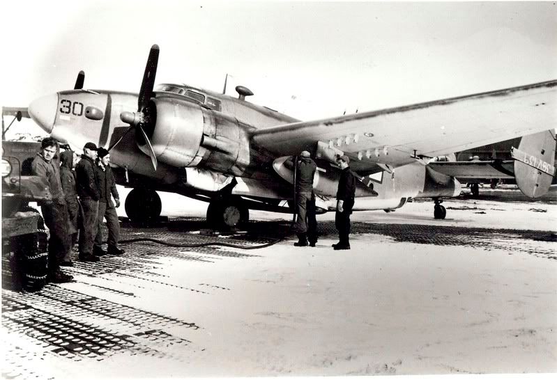

Here are "the conditions that prevailed" on Attu. VPB 139.
Pretty much the same mixed bag of weather in Indiana.
PJ

PostPosted: Mon Jan 12, 2009 8:52 am
Posts: 4343
Except there are trees in Indiana. During the war the guys posted in the Aleutians joked that "there's a woman behind every tree." Of course, there's nothing there but rocks, volcanic ash, and tundra.
Great work guys. I've seen Hot Stuff at several shows..she even flew up here to Battle Creek a few years back. Beautiful bird!

PJ has had those pictures on the wall back by the coffeepot for a year or two at least, and I just purely love them. Those poor guys. Wet feet, chilled to the bone: must be working on a Harpoon!
We need to make us a set of rudder battens like the ones they have installed in the top photo. The manual has a depiction of it in the tool listing, but we'll have to deduce the dimensions.
