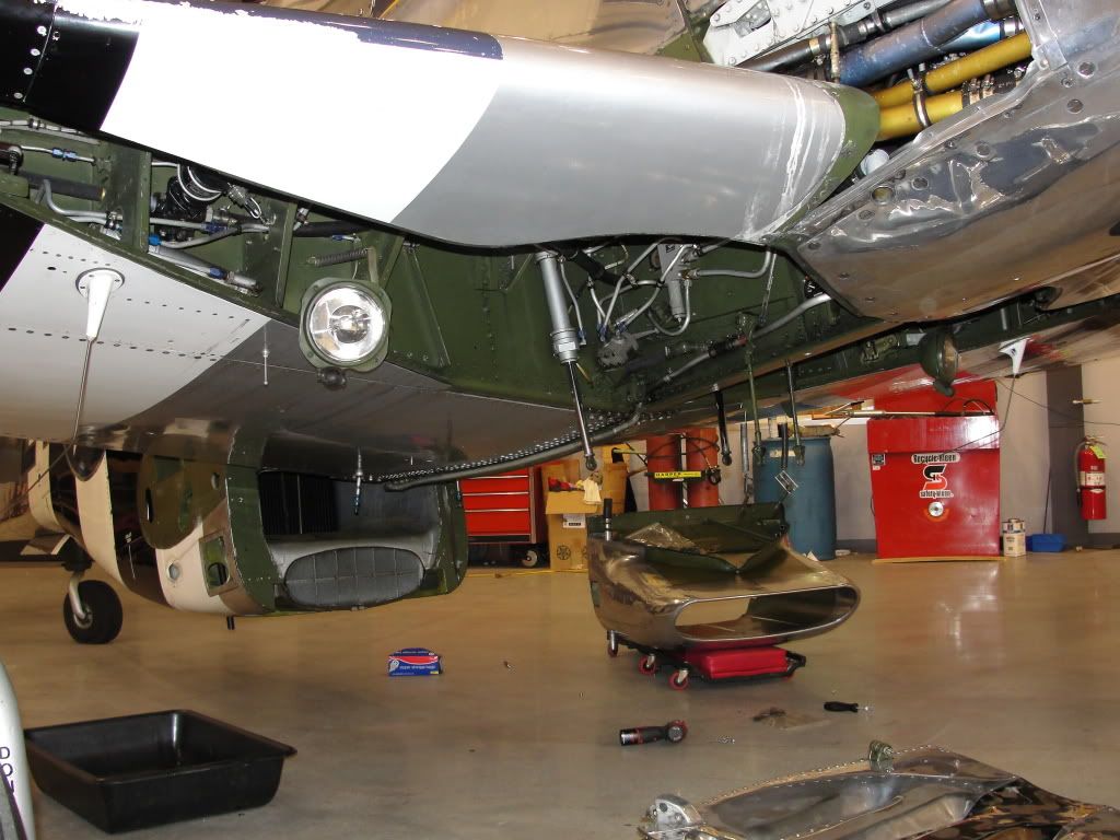

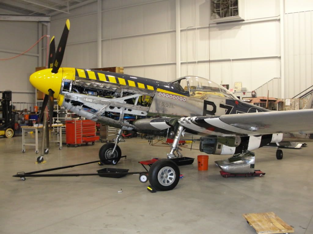

The current hangar project for the winter is to replace the MLG trunions in the wings of Bald Eagle.
I'll try to keep you updated as we go through this process.

Maybe a dumb question Rich but I'm full of those. What prompted the trunnion change? Anything special I should look for next time SUSU comes up for annual?
Rich
It's usually just the bushing bores that enlarge/wear. Is there another problem?
PostPosted: Sat Oct 31, 2009 9:12 pm
Posts: 3160
Glenn Wegman wrote:
Rich
Glenn,
That would be a more exact description of what I am doing. No other problem noted for the moment.
Rich

51fixer wrote:
Glenn Wegman wrote:
Rich
Glenn,
Rich
G'Day Guys,
Here, in the land of Oz, we have a CASA AD that requires the MLG trunnions, P/N 17-33163 or 66584, (yes, I know that these are CAC part numbers) to be mag particle inspected every 250 landings or after a heavy landing. See http://www.casa.gov.au/ADfiles/under/mu ... NG-002.pdf .
I don't have the NAA equivalent part numbers to hand right now, but I do know that there is a later, strengthened trunnion produced by NAA that doesn't require this repetitive inspection. Worth keeping in mind.

mightyauster wrote:
Here, in the land of Oz, we have a CASA AD that requires the MLG trunnions, P/N 17-33163 or 6658.
