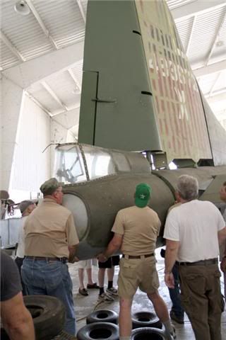

Well Dang!
The right wing extension accidently jumped up onto the airplane yesterday.
Kudos to David Carr, Chuck Conway, Ken Hyman, Randy Wahlberg, David Winchell and anybody else who left before I got there after work.
(timed it PERFECTLY, I did! :D )
Pictures as soon as I get some.

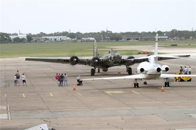

Something worth posting.
Another engine run, this time with Wings On!
Everybody lift now... No Comedians!
I thought YOU had the fasteners!
(Photo Credit- Col. Kevin Hong)

During the runup the pilot had to be saying to himself........."brakes don't fail me now". Maybe the guy in the Falcon was saying the same thing. Good to see her coning together.
PostPosted: Thu Jul 16, 2009 9:22 am
Posts: 1275
Location: Houston, TX
Looks are a little deceiving but YES, if the brakes had failed the SOP was CUT POWER or go differential if only one side of the brakes failed, and to stand on the good brake and swing her around all the while slowing down.
There really was more space between the Falcon and the B17 than appears in the photo due to perspective.
And Steve that is indeed a static wick. All the CAF heavies are supposed to be IFR compliant in case they get caught in the weather on long transit flights. I am sure someone will correct me on this, but that was what the intention was, as explained to a poor misinformed American Down on his Luck! (Better have some beans, gonna be mighty rough country tomorrow!)

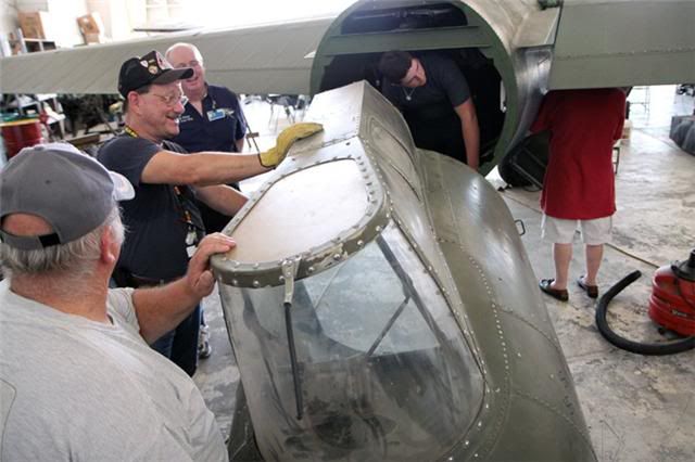

I have the top turret cuppola mounting ring "almost" finished. I ran out of hardware, but trusty Bud, the Supply Officer has an order in for just what I need.
