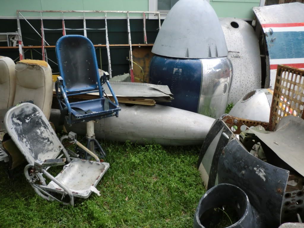

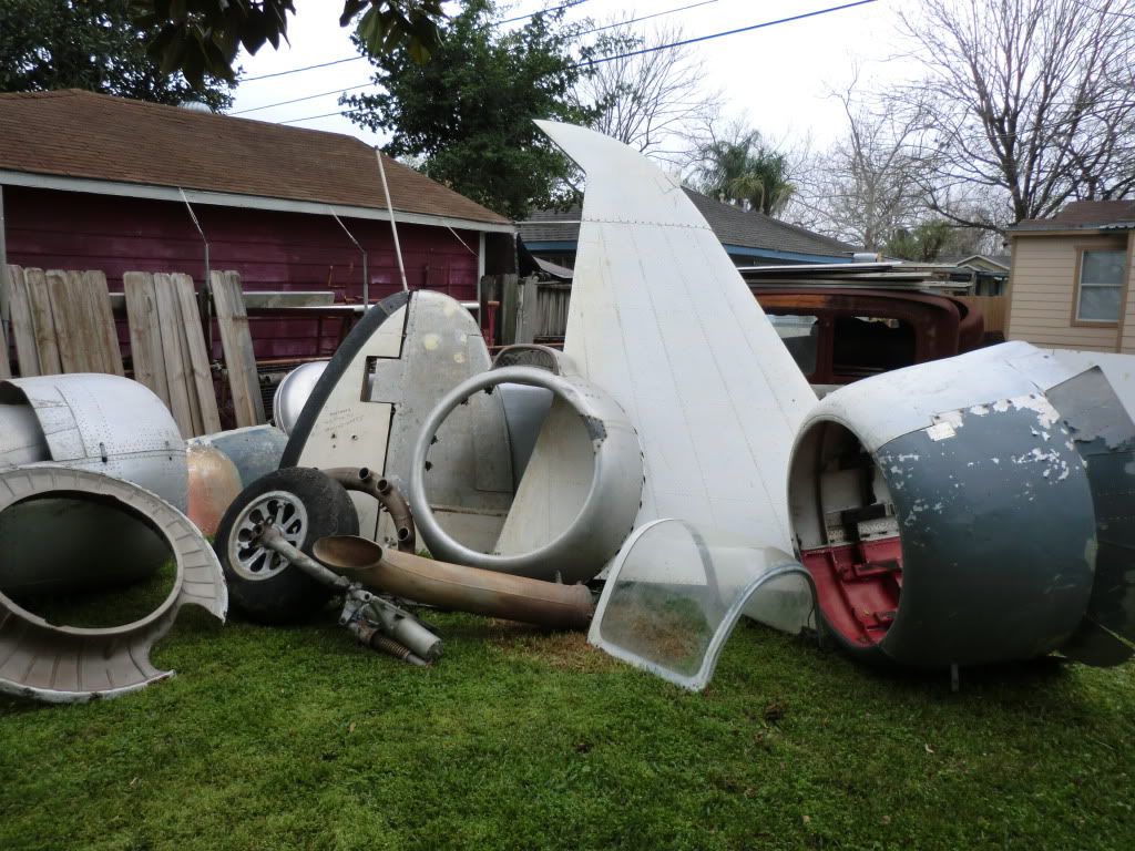

Rick,
I never would have guessed it was an A26 rudder when I bought it. I was told it was off of DC6 when I bought it and I never gave it a second thought. If it makes things a little better, the rudder still had much of the tattered covering on it and about 80 lbs of raccoon mess in it. Some of the ribs are badly corroded about midway up. Naturally I had to destroy the one part that could have helped someone out. There is no magic garage full of A26 parts by the way. If there was I would load it up and bring it to y'all just to say that I helped out.
This rudder was one of the pieces that I hauled home from Tradewinds after it closed down. This is probably the only A26 part that I am lucky enough to have. Here is a glimpse of the pile in the back yard that is all scheduled for art work use. Almost all of it has some form of massive corrosion damage or it wouldn't be in my possession.

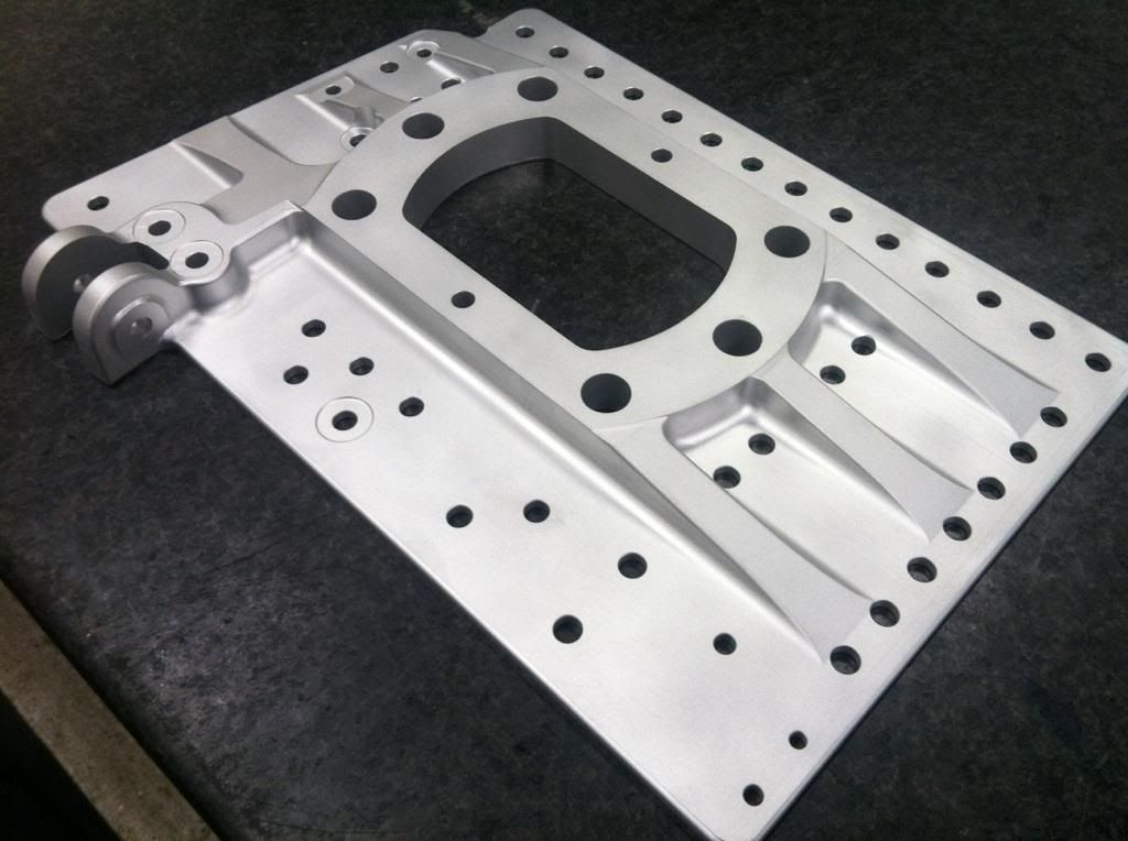

PostPosted: Fri Mar 02, 2012 6:29 pm
Posts: 2563
New Mystery Part for the week.. and I mean new... just delivered. Ain't she grand?? So what is it and what does it do? I like it better when I get to ask the questions!! Note to Randy... Tim is working on the reunion date and it may take awhile for him to get back to us. Also, Randy, the two Nimrods in the picture awhile back. You said you had one for sure and a probable on the other. Can you give us some initials?? If it helps, you can refer to the http://www.a-26legacy.org website and look at Nimrod pics. Don Vogler has a bunch of them there. Don and his organization continues to help us BTW. He has redesigned his Tshirts so that the logo on the back shows 679 instead of his dad's airplane, MM. Note to Jason... thanks for the help with the rudder trim mechanism. Solves a problem for us looks like. It amazes me how we run into a need and out of the clear blue, a solution pops up to help solve it. The Mystery Part above is one of those examples. Our good buddy, Jerry D., pulled this rabbit out of the magic hat. Of course, we wouldn't have met Jerry D. had it not been for the real JR. Thanks guys!! The other JR

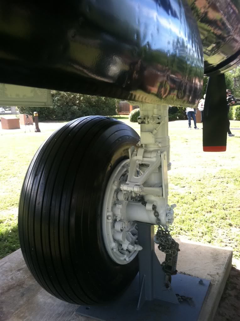

PostPosted: Fri Mar 02, 2012 7:03 pm
Posts: 2563
This shot is from AF 666 at Eglin in the Memorial Air Park. Want to show another difference between our K and stock A-26's in that she uses anti-skid, multidisc brakes that came off the early KC-135's. These were needed for the higher gross weights. So now, we have taken the brake assembly off the left side of 679 and found that it is in dire need of life support so we sent it to the clinic for rebuild. Keeping fingers crossed that Dr. JR can save this one with the right surgical team. Failing this, if anybody knows where Uncle Sam parks old KC-135's parts where nobody is really looking too hard, please let us know and we will send over a requisition one of these nights. :-) We have one already filled out and in the tool box.... uh, I meant mail box. Everybody come see us Saturday. The weather should be perfect and we will have a fine time. Meacham Field is really getting active... kinda like a Montana Griz wakin up from the winter snooze. All of the team will be anxious to get to work and then chow down at lunch. I am beginning to wonder if that is their favorite part?? :-) Nah... they love working on old airplanes and having this opportunity to be in on the ground floor of restoring a very unique warbird. This is an example of the last piston twin engined bomber delivered to the AF. The last On Mark rebuilt B-26K delivered and the last one flying... how's that for a lot of lasts? Cheers, Jim R

PostPosted: Sat Mar 03, 2012 12:06 am
Posts: 3418
A26 Special K wrote:
...So now, we have taken the brake assembly off the left side of 679 and found that it is in dire need of life support so we sent it to the clinic for rebuild. Keeping fingers crossed that Dr. JR can save this one with the right surgical team. Failing this, if anybody knows where Uncle Sam parks old KC-135's parts where nobody is really looking too hard, please let us know and we will send over a requisition one of these nights.
Just out of curiosity, even though you're wanting to remain as "authentic" as possible, have you considered changing over to the DC-6 brakes that On Mark used for their Marksman conversions? There are more of those available out there than early KC-135 packs. Alternately, have you looked into maybe seeing about getting 707 packs?
BTW, just for FYI, the KC-135 packs, while maybe suitable for the A-26, are kinda funny to see offered an increase in gross weight since the KC-135's brakes were actually pretty puny. They were designed to stop the plane when coming home with no fuel, not fully loaded, which is why the aircraft required such enormous runways, not because they were underpowered.
PostPosted: Sat Mar 03, 2012 12:39 am
Posts: 2563
CAPFlyer... good questions about the KC-135 brake being adapted to the K. The difference in effectiveness on the K might be a matter of the tremendous disparity between the landing weights of the two aircraft. The KC-135 had a whole lot more momentum. It's brakes might not have been very good against something over 100,000 lbs, but held up rather nicely against 35,000. In fact, our experience with them on the ferry flight down from Montana was very pleasant because we have been wrestling against the B-25 brakes for all these many years. Nice to have anti skid as well since the main tires costs over $3500 each now. We figure that every landing costs about $80 per tire just in replacement costs. Now that brings me to the next point. We will not use the brakes until absolutely necessary on each landing. We plan to roll out long just like we have practiced in the B25 operations. If there is a 6000 ft runway, we want to use 5900 ft of it. Other than a brief test of the brakes after touchdown and rolling out to a slower speed, we hope to save some brake overhaul costs as well. Can't figure a cost per landing until we see what it will cost to do the first overhaul. About your question of going to a DC-6 system.. well, if left with no other choice, it would be next best. Anything is better than the old WWII expander tubes, right?? The thing about DC6 brakes is that they ususally refuse to really get with the program until they sense the airplane is in the overrun of the runway. If this is so, then I suppose we could engineer a box of rocks to drop out of each wheel well to fool the airplane into thinking NOW. After all , isn't that how they use to fool the F-105 into rotating at take off? It would not rotate until it sensed the roughness of the overrun and then flew off just fine. A quick thinkin crew chief devised a bag of rocks to hang in front of the nose wheel and when the pilot thought it was time, he pulled the lanyard and the rocks spilled out to simulate the overrun. That man was a genius and should have been given a medal and a promotion. Does anybody remember the name?? Why of course, it was Sgt Rock. And now you know the rest of the story!! :-) Goodnight, JR
