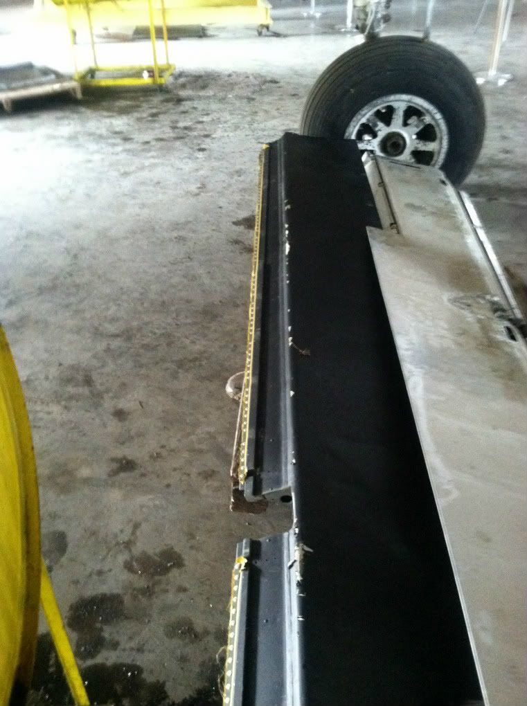

Well now, here is a shot of the forward end of the bomb bay area. There are several things missing, but the major thing is________________? This is a fill in the blank quiz!! :-) I have discovered there are a lot of sharp guys on this forum who know a lot about A26's. So have at it? This will probably be a another stumper. The last one.. the smiley face with Amy... nobody got that one. She is holding a template for making a doubler for the carry thru structure of the horizontal stab spars. Purty Kewl, huh? This was a repair done for some small areas of corrosion in that section. Manual called for this doubler to be built and installed. Amy took on that project and spent a lot of time in the tail section measuring, cleaning and making it ready for the installation. If fact she spent so much time in there, we told her she needed to give the Post Office a change of address form when she moved out.... :-) Jim R.

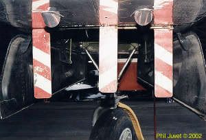

If I remember correctly, (and probably don't!) I remember that there were some sort of "spoilers" that came down into the airstream in front of the bomb bay when the door were opened, to, as I was told, disturb the airflow so the stores would fall out cleanly. I don't remember seeing them on 679 when I was down there. Seems to me that they were called "Strakes" or something. I think it was 3 flat pieces of aluminum, maybe 3" wide and 18-24" long. Probably not what you're talking about, but just a guess.

For clarification, this is what I was referring to. This pic was taken of 666 at Hurlburt years ago when it was on a concrete pedestal. I sure don't recall these ever being extended when the bomb doors were closed though.

Ding Ding Ding... we have a winner... Randy, just shows experience counts!! Yes, strakes were added in front of the bomb bay to create turbulent air flow in the bay. They extended when the doors opened and retracted automatically when they closed again. Above a speed of 240, the airflow might just keep the bombs stuck in the top of bay instead of letting them drop out. The strakes corrected this problem and allowed the release of weapons up to the redline airspeed. These are missing on 679. What is really unusual is that the strakes are designed to come out of slots in front of the bay, not from it. 679 does not show any evidence the slot was ever there. To read more about this, may I suggest looking at the most complete A-26 website out there.... http://napoleon130.tripod.com/id839.html
The above picture is from this site along with a complete explanation and illustrations from the parts manual. Would be great if we could figure out how to make this happen on 679, but it appears to be a major undertaking to create the slot in the structure. Jim R PS.. Thanks for the kind comment, Dwayne!

There are valves that direct fluid into an actuator that works the "BLADES ". They are sequenced so that the blades deploy prior to the doors opening and retract prior to the doors closing. Two blades are linked together so that they only require the one actuator for one side. If the regulator valves aren't set right they will not work in the correct sequence. I have seen some slots that were sheet metaled over that looked pretty professional.
When I get back from Heli Expo I'll try to get some uninstalled pictures of the blade components.
