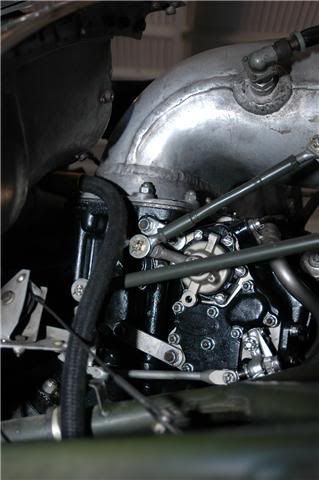

Hokey Dokey... Just got my pictures from Kara...
ImageNow WHY could that test club be on Engine 3??? hmmmm

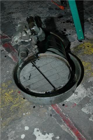

Image Oil cooler ready for sending off to be serviced.

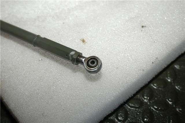

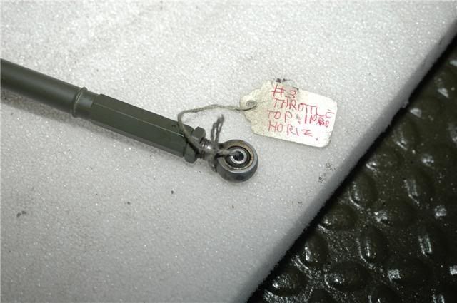

Imagelovely Heim bearing about to fall out of its race
Image This might have made (trying) to use the throttle exciting if it had fallen apart at that MAGIC MOMENT!

That bearing is EXACTLY why we say to put a large area washer on rod ends. Had that failed, the washer would keep the rod attached and you would still have some control.
and yes it looks better......
