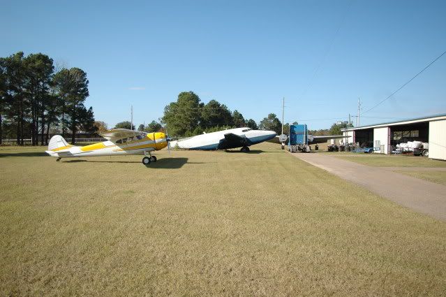

The boss...Mac, his Dad, Aubie,...and Potus...the 195

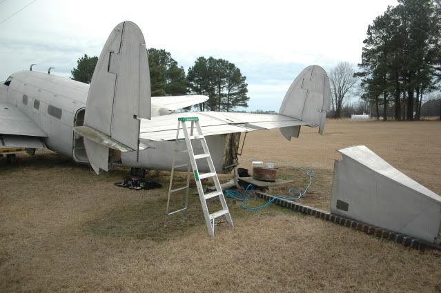

The rudder comes apart in two pieces...Lower portion removed...
Note the two trim tabs still on the upper rudder..

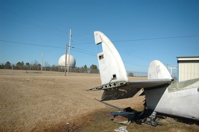

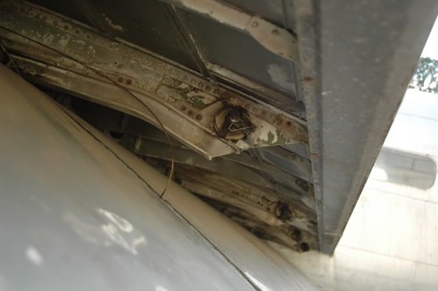

The stubborn flap tracks and rollers...

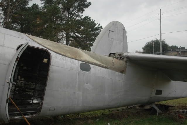

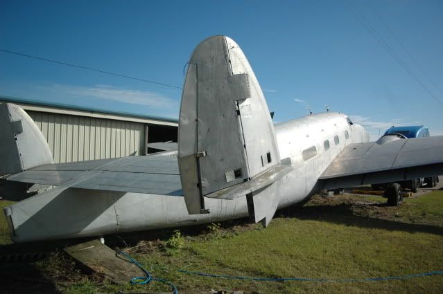

Sunday...I managed to remove the large fiberglass streamlining fairing from the upper rear fuselage and horizontal stab.
This was a Howard modification that was done sometime in the 50's, I believe...although this L-18 wasn't a full fledged Howard conversion...

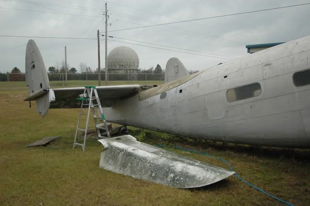

In this view from the port side, you can see the outline of the fairing I'd just removed, and also the outline of the original, smaller fairing that was removed way back when...

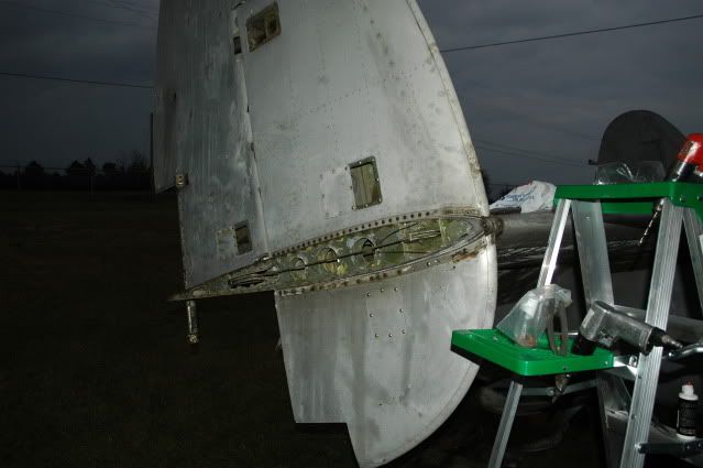

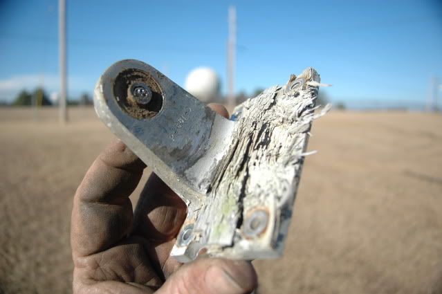

Rained Saturday, so got a lot of reading done....Sunday I removed the stbd upper rudder and the lower verticle fin..and did a lot of drilling on rusted stainless bolts....
 Post subject: Re: Just aquired L-18
PostPosted: Tue Jan 19, 2010 6:12 pm
Posts: 1425
Location: LONE JACK Mo.
This is the lower rudder hinge....kinda nasty looking with the massive corrosion....unfortunatately, both sides look like this..Hope this not a major problem with all L-18/C-60's
