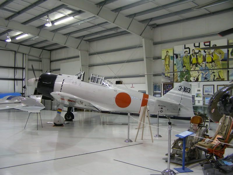

I got in late on this thread but I really like Brian Reynolds Zero replica up at the Olympic Museum in Washington

Not bad Chris, is it a Texan conversion? What do you know about it?
PostPosted: Mon Aug 24, 2009 8:02 pm
Posts: 972
Location: Mesa, Az
I think it's based on a Harvard. Brad or the Inspector may know more

Posts: 1132
CCF-4-16
Harvard IV
Built 1952
Owners: 20th Century Fox 15 July 68
Tallmantz Aviation 23 Feb 71
Gene Fisher 17 Feb 87
Zeke Inc 12 June 1992
Olympic Flight Museum 1997 or so
11-7-68 Converted to A6M2 at Cal-Volair. Airframe had 6,843.3hrs
4 Dec 68, 10.4hrs flying time for Tora Tora Tora at El Toro and USS Yorktown
2 July 75, wings removed for transport to studio
23 July 75 reassembled for filming of "Midway"
6 Sep 87 Flown 7.0 hrs from Midland to Pensacola FL by Ken Shugart
7 Sep 87-1 October 87 Flown in "War and Remembrance" from Pensacola and USS Lexington
3-6 Oct 87, Pensacola to ERI to N94 Total time 7109.1hrs

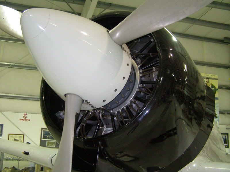

10 Mar 89. P&W 1830-92 installed from left side of ex-Canadian DC-3 # 12957. Cowl flap linkage from C-47, Spinner and backplate form Howard 250

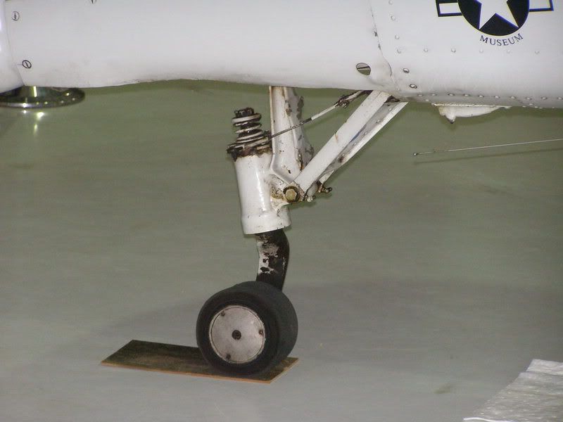

The landing gear is part T-6, part Aerostar, part 421 Cessna, part homebuilt. The panel is laid out like a real Zero, complete with gun buts sticking through. The tail wheel is a BT-13 unit converted to retract. The Oil tank is in the rear fuselage, the back seat is mounted facing aft. The leading edge of the wings, rudder and elevators are modified, it has high speed ailerons and wing tips have been added. It will outrun any airplane in the Olympic Flight Museum up to 4,000ft. Then it slows down considerably! It starts easy, runs great and is one of our most dependable airplanes.
Glory shot of me running it up last June.
This wasn't taken with a zoom lens
A video I took a couple of years back.
http://www.youtube.com/watch?v=AugLcN6ZTd8

Why go to that extent on the landing gear? Not knocking the work, but is the result worth it? It looks kinda funky to me.

Thanks for the input Brad. Great info. As for the question, why would someone go to all that trouble on the gear? To make it as visually accurate as possible. I heard that it can be a little tricky if pushed backward into the hangar-is that true Brad?

That is true Chris. We push it back about three foot beyond where we want to park it and then pull it back into place. The geometry of the gear causes it to try and spread apart when the plane moves backwards. Three feet forward gets the tires back the proper distance apart. It's a little weird but after you know what happens it's not a big deal.

Gene Fisher left the airplane in Conroe, Tx, for a short period back in the 80's, and I did a bit of work on the airplane and had many conversations with Gene on the airplane.
The gear was made that way to ensure that it would fit entirely in the wheel well, and with the inbd gear door, it resembled a Zeke a little better than a stock T-6/Harvard/SNJ does. It needed the twin Cessna brakes because of the heavier landing weight with the larger engine installed, due to the kinetic energy at the landing speed and weights.
