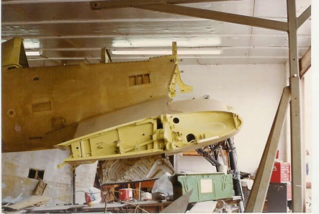

Did you take any pictures of the F4U’s at Ft. Lauderdale?
To Nick “ozyfuryfan”:
Did you guy find any ID plates in your aircrafts?
Can you take a close-up pic of the little ID plate located at the 2 o’clock position of the outside wall of the main fuel tank?
In the following picture (front view) you can barely see it at the 2 o'clock position..
Thanks to everybody for your help,
Lone Eagle / Seagull 619

PostPosted: Sat Jun 27, 2009 5:38 pm
Joined: Mon Apr 02, 2007 1:25 am
Posts: 57
Via FAH 619;
F4U-5N poss Buno 123168 at Christchurch AB, NZ Oct. 1991." ??? Via RNAF Museum.
Al, Rob; the following info via Seagull 619;
Deep within the C/w.com archives is a letter dated Aug 1991 from the Christchurch RNAF Museum which clearly states the following:
"Unfortunately the main id plate in the cockpit had been previously removed, but a data plate attached to the mid-fuselage section reads as follows:
Airplane Model---------------->F4U-5N
Dwg or Part No.---------------> VS- 55210
Contractor No.----------------> A (S) 9771
Serial No.--------------------> A10-353 "
p.s Rob, according to your F4U Buno's the F4U fuselage currently in Australia is the poss Buno 123168. I hope that they are able to send us a picture of the mod plate to compare notes.
PostPosted: Sat Jun 27, 2009 8:22 pm
Posts: 1536
Yep, it looks like the numbers line up (A10-353 = BuNo.123168).
BuNo.123168 is shown as "603" in the sales receipt below. This is FAH letterhead directly to George Heaven of Hollywood Wings. That, plus the data plate info mentioned in the previous post should dispell all doubts as to the plane's true identity. "603" is in fact 123168, and 123168 is the airframe currently in Australia.
This is fun stuff! I love a good bout of research. 8)
