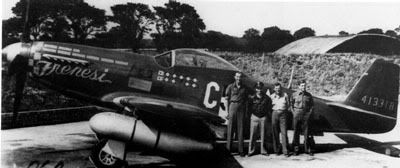

So am I allowed to remove the dorsal fin from the D we're doing if Rich and I go back to Frenesi (it's originally a D-5) after a stint with the Iwo look? I'm not worried about her falling apart in the air without it.
