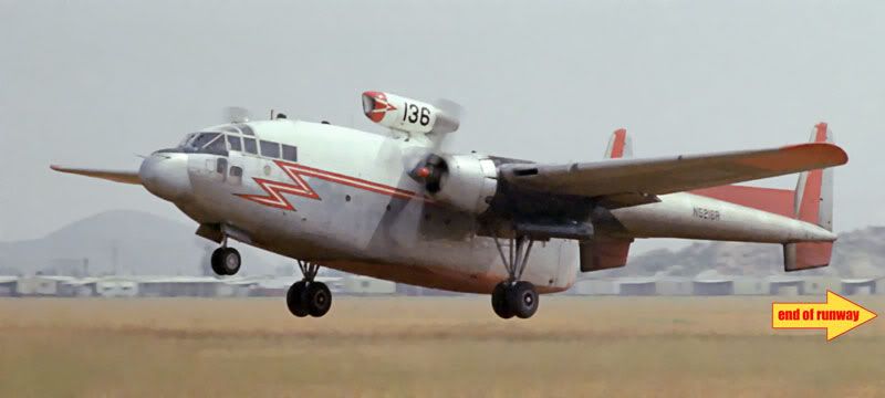

....Using ALL the runway at Hemet...31 July 1977....

....Using all the runway at Hemet...31 July 1977....
Oh crap!

Larry;
I remember when #122 blew the tire on take off at Ramona and went off the runway, my dad and I went down to Ramona in HVFS J-3 a little while later and the only thing left was the wing center section. I was crawling all over that thing, I remember it being at Hemet week or two earlier, now if I remember correctly wasn't there an old derelict B-25 at Ramona about that same time frame? I can remember on some hot days in Hemet when they get a dispatch to a fire and on take off they would wipe out the fence on end of the runway with the box, thanks for the pictures of Hemet and Ramona, sure brings back memories. It’s too bad they don't look that way anymore. I was talking to my dad yesterday about your story and he remembered when it happened (you know how stories travel around in the tanker biz).
He told me he had run into you a couple of years ago when he was flying for Minden Air in #55; I guess you guys got stuck down at Ft. Hoochie Coochie (Ft. Huachuca) working a fire together. Keep the pictures and stories coming I’m reliving my air tanker youth!

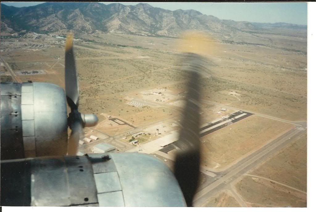

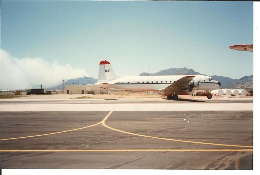

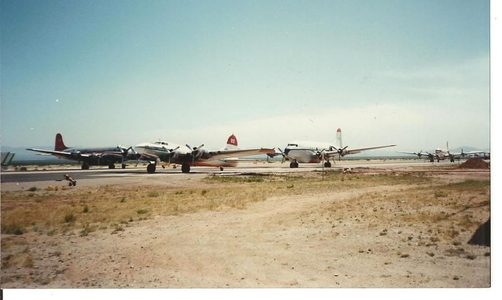

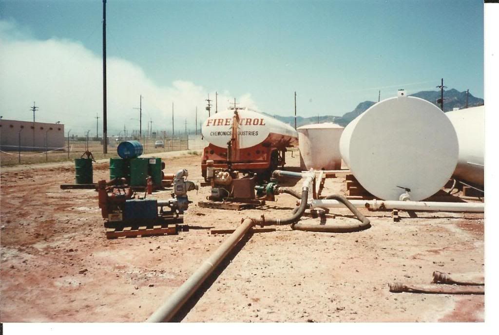

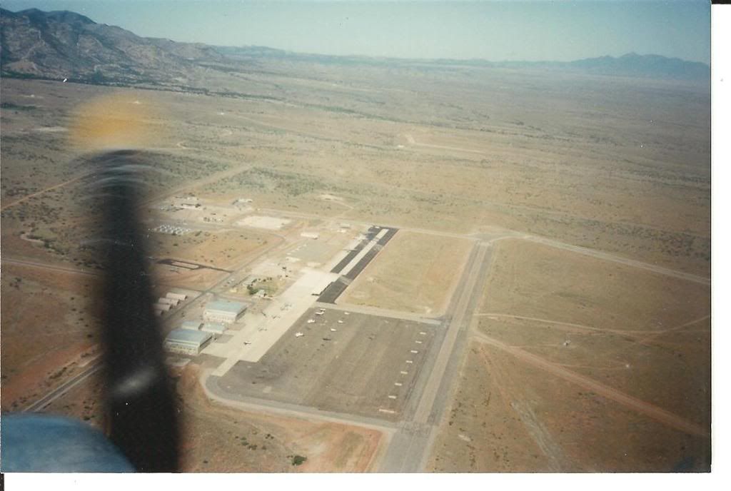

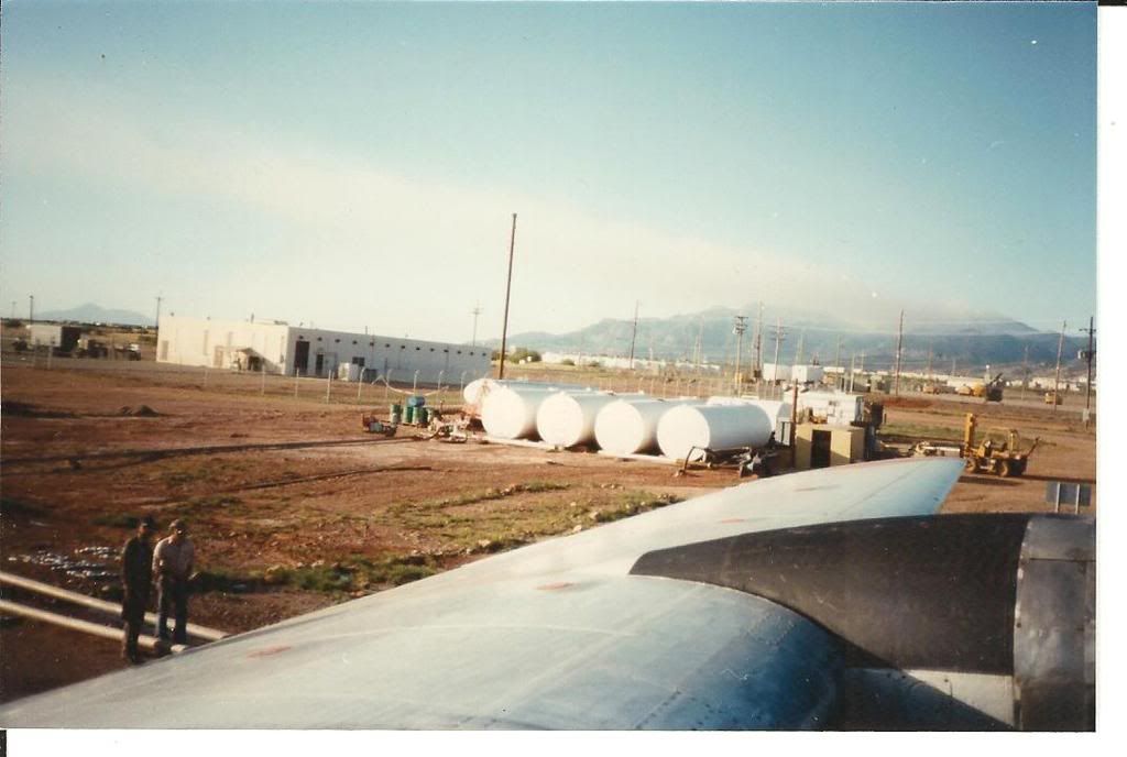

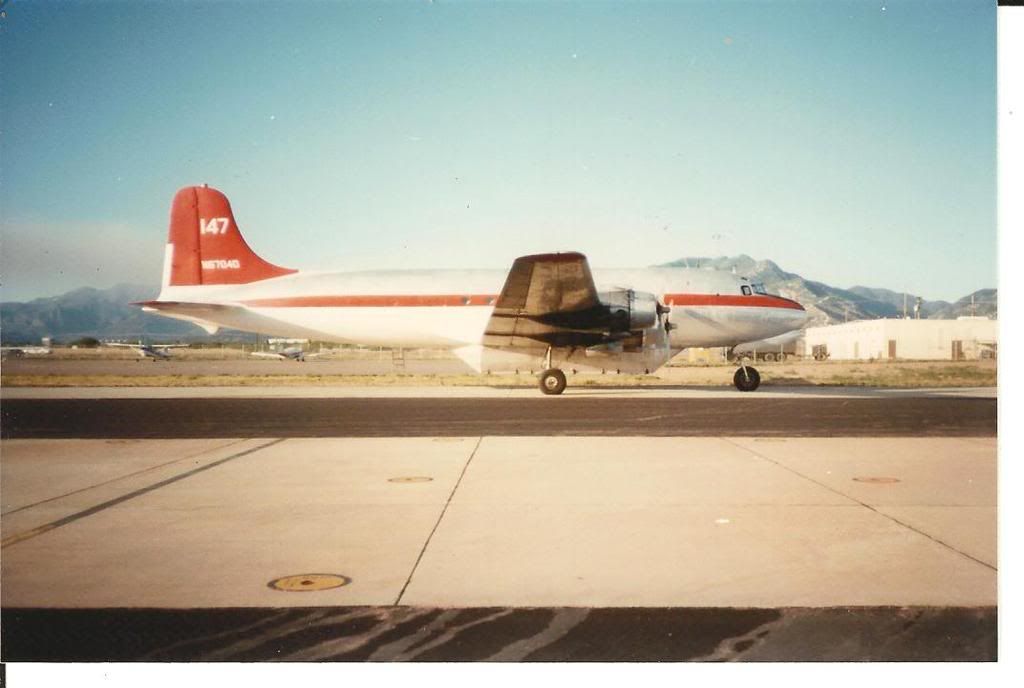

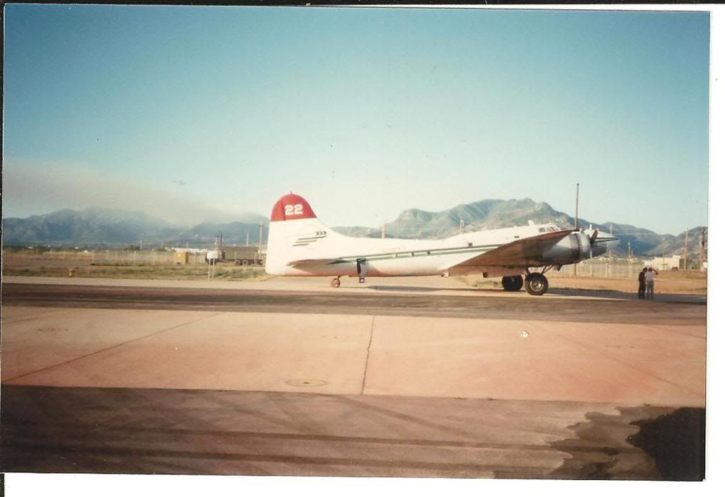

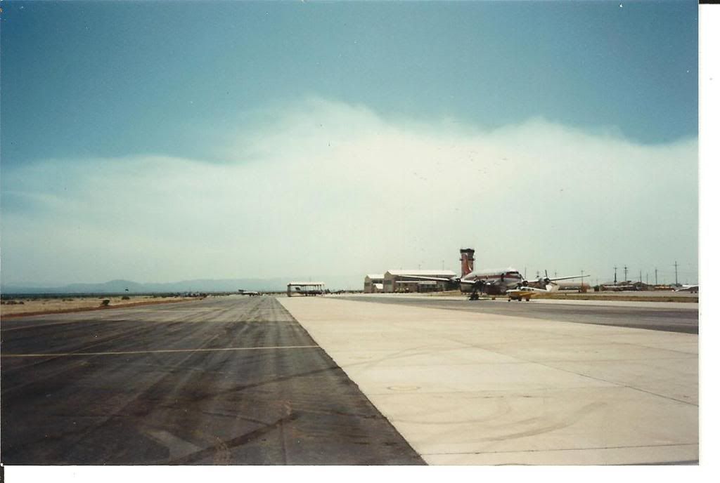

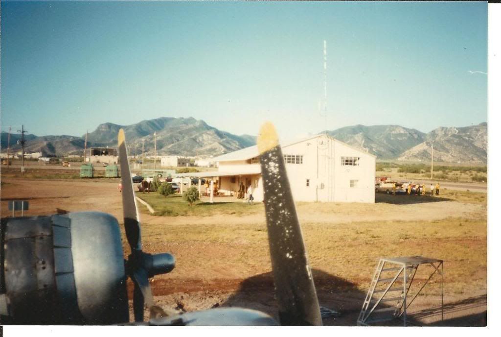

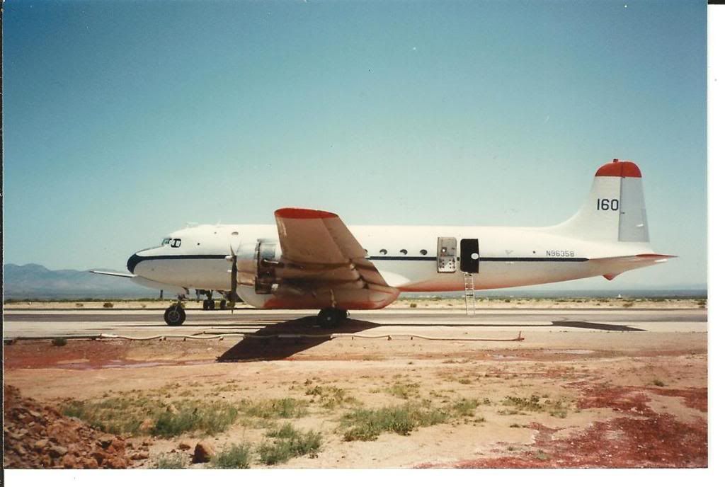

Scott,I have some pictures from Ft.Huachuca in 1983 from a trip there in Tanker 22.The overhead shots show that the long runway hadn't been built yet.You can see smoke from our fire,which was just north of the Mexican border.I have a story about this episode,but I'll have to post a little later.I just spent 30 minutes typing it out and something went nuts either at WIX on on my end and it disappeared somewhere.No big deal,but I'll post some pictures,then try to get back to the story.
1&2 Libby Army Airfield at Ft.Huachuca,AZ. from B-17 Tanker 22 while decending from the fire area
3. The FHU Tanker Base Office and standby area
4-6 The retardant plant at FHU with our fire in the background
7. The loading pits at FHU
8. Looking south over Tanker 22
9-12 Some DC-4 tankers at FHU.The bottom picture is looking east toward the control tower and the Army ramp.

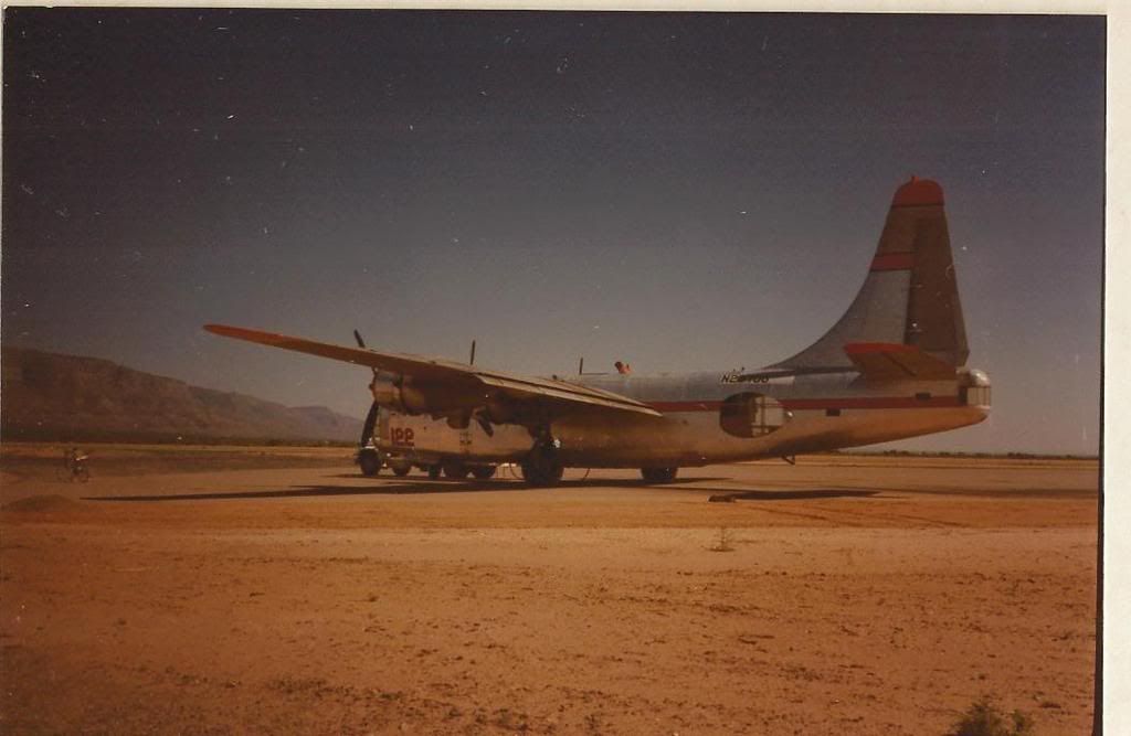

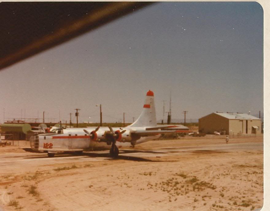

I was scanning some more pictures today and realized that my timeline on the take off accident with Tanker 122 happened in 1980.That airplane had passed through Alamogordo and I'd taken some pictures of it.I was impressed with the highly polished finish on the airplane.I heard about the accident either while I was still at ALM or after moving on to West Yellowstone in 1980.The wreckage was still there when I staggered out of Ramona two years later,but it had been there a while.Thanks to Scott on the info about a blown tire being the cause.I hadn't ever heard any details.I'll post the pictures that I have of Tanker 122 when it passed through Alamogordo.I'll also add a picture of Ramona Airport from Tanker 65 from a different day in 1982.

Tanker 122 was the very first PB4Y-2 I had seen as kid, I think it was the the cleanest 4Y in the H&P fleet, That was back when #121 was painted up like a loaf of Wonder Bread I think.

There are a couple of stories that pertain to the Ft.Huachuca posting above.One now,and one later.Back in 1983,there were two runways at FHU,both of which were relatively short.I checked the back of one of the photos and it was dated as June 4,1983 as the day that we worked the fire near Mexico.
That was the first time that I'd flown a tanker out of Ft.Huachuca,but I'd been there a few times in a Twin Beech.We hauled explosives under an exemption to the F.A.R's and one of the items that we flew around was rocket motors for ejection seats.These had to have periodic inspections and we often picked them up at Air Force Bases and Naval Air Satations and took them to Indian Head,MD. where the inspections took place.Later,we'd return them to the users.At that time,the Army had a fleet of OV-1 Mohawks based at FHU.
Every time that I tried to take off from Ft.Huachuca in the Beech,the wind would be blowing from what seemed to be 4 directions at once.The tower would ask which runway we wanted to use and I'd look at the wind sock and head for the one that was closest to being into the wind.By the time I'd get to the end of that runway,the wind would have changed by at least 90 degrees and was blowing at least 20kts and gusty.So,I'd head for the next most favorable runway.The same thing would happen,so I'd just take off and figure that at sometime during the take off run,I'd probably end up with a headwind component.
Nothing much had changed in that department when my c/p Chuck Ott and I arrived at FHU in Tanker 22.Other than having to struggle into the air in unfavorable wind conditions,FHU is another one of those places where everything is uphill no matter which way you go.It's lower to the north,but the fire was south southeast of the airport.I figured that the FAA should throw in a free Sailplane Rating with the B-17 Type Rating because you needed to know all of the tricks of soaring to go anywhere while loaded.I used to joke that the only aircraft with a lower rate of climb and a lower roll rate were hot air balloons and open parachutes.
It took almost 20 minutes to climb up to the fire and it took 5 minutes to get back to the airport.That part was even problem because we had to lose so much altitude in so short a distance.The pictures showing the airport from T22 were in a descent from the fire.All that we could do was to drop the gear and bring the props back to 1600 rpm and 20" of manifold pressure and take up a spiral orbit to lose altitude without building up too much speed.

We called Tom Hammond at Evergreen.He said that the pumps were interchangable an that I must be doing something wrong.We checked the ignition booster and mags and found that they were okay.I was stumped and went into the standby shack and asked the other pilots and mechanics if anybody had any suggestions.John Elgin was flying Tanker 160.He said that he had a similar problem with an H-34 helicopter once,except in reverse.
What he came up with was that there are two types of boost pumps.Normally,the B-17 uses the one with 15 psi and the H-34 uses the one set for 25 psi.While it's true that they can be interchanged,the primer nozzle also has to be changed to match the pump output.In my case,the primer (which primed the blower) had too much pressure to atomize the fuel.In his it had too little.
