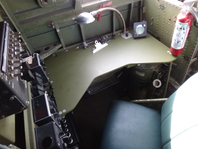

Sorry for the slow updates lately. It hasn't been for a lack of work it's just that I have been traveling a lot and other business crap sucking up the time in the day. I know; lame excuse so here goes:

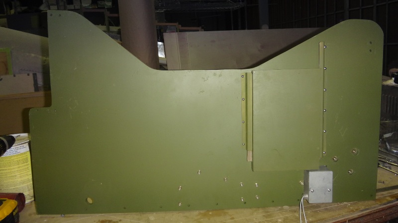

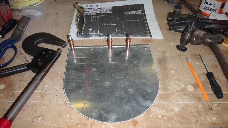

The radio table had to come back out because I finally dug the table light out of the parts storage hangar. The light has a fitting on the box that will only allow it to slide in the slot from the rear. It worked out great as I had a bunch of other parts to bolt on to the table anyway. My daughter Sydney came out to help on a Saturday and she hit the deck so to speak. Here she is under the radio ops seat turning the nuts that hold the table in place

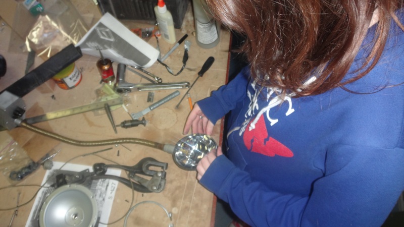

Here is Sydney fixing up the table light. This is the same one used in several other WWII aircraft including early B-17's. The light is in great shape and only needed wiring added so we can hook it up when we get power in the area.
This is the radio table on the bench and you can see the silver table light box and the newly fabricated drawer added to the bottom of the table.

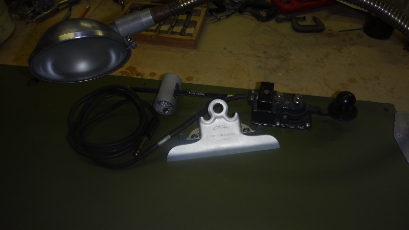

The table all ready to go back in with its compliment of gadgets and doo da's. The aforementioned explosion proof Morse code key, original Globe Wernicke clip board clip and a Lockheed made pencil holder complete with pencil. Maybe I should clean up my work area as it is starting to look as bad as my desk in the office...naw, nothing is that bad!

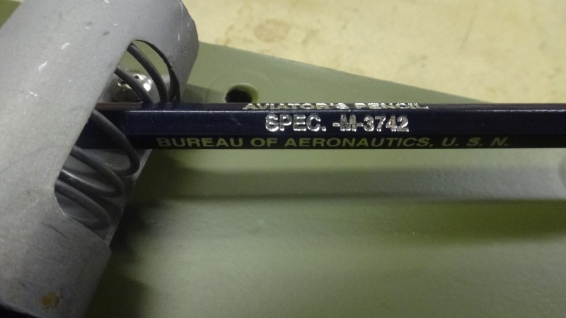

Ken gave me a Christmas gift of 5 pencils that are reported to be exact replicas of original Naval Aviators pencils. Too cool! The Harpoon thanks you Ken.
The table goes back in hopefully for a longer time

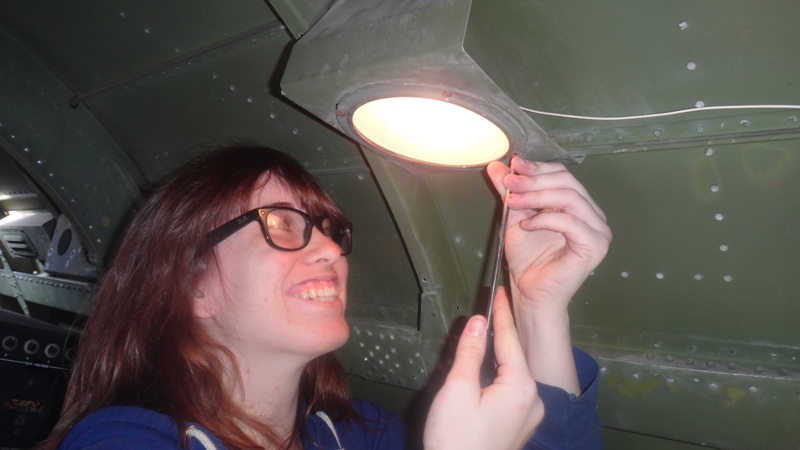

Syd also got one of the cabin dome lights working again. It will need the hokey wiring replaced but along with the two other dome lights we installed we can now work better at night!. The lights are hooked up to the battery hot bus with a switch at the main door for easy entry lighting. There is even supposed to be one in the cockpit which is sure handy. Boy Lockheed thought of everything. I wonder if the toilet seat is heated...?

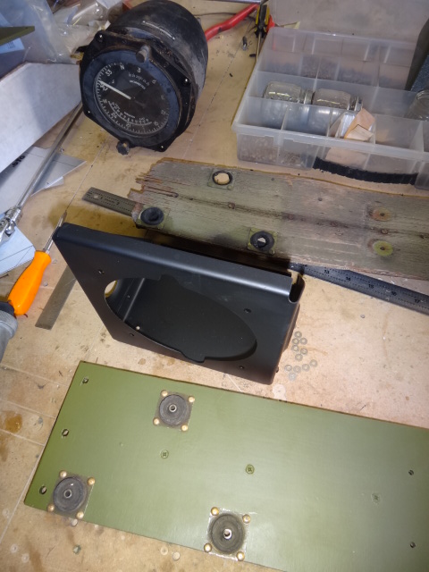

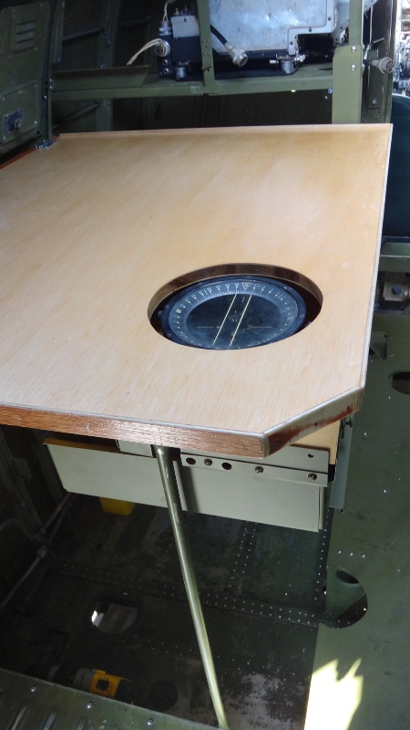

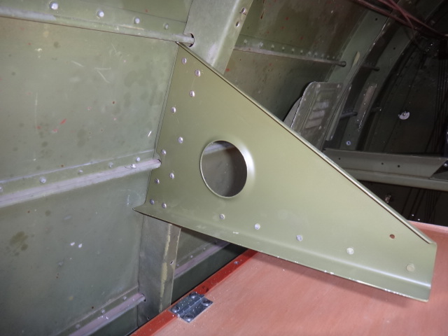

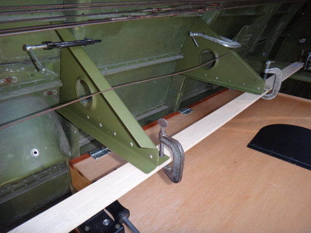

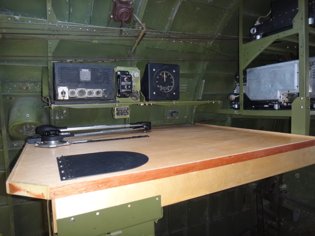

I found the D-12 compass in the storage hangar so here it is for a fitting. It lined up nicely with the new shock mounts but I will not bolt it in quite yet as the whole Nav table still has to come back out for paint after the table top material comes in. The top gets a layer of material so the Nav can write on it and the protractor will ride smoothly.
The cover for the D-12 compass is fabricated and fit

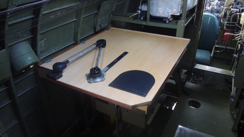

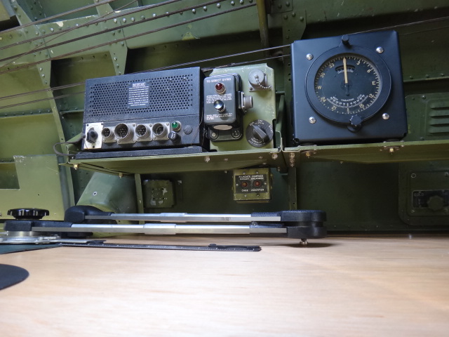

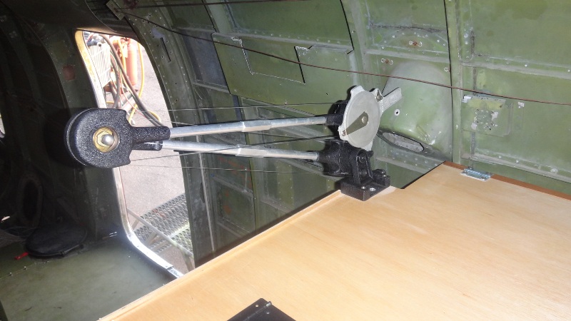

Here is a shot of the new Mk 3 Aircraft Protractor (Navigators drafting arm) from eBay installed on the nav table along with the compass cover.
The Protractor was $25 band came new in the box. The only problem is it was for an Army contract but I found the correct Navy one and the gentleman was very kind and donated it to our worthy project. I have a special fondness for the Navigators station as my Dad was a B-29 Navigator. He and I would collect navigation gear a lot of which is going in to the Harpoon when the time is right. The Nav station will be darn full of gear just waiting for a navigator to sit down and get to work.
Interesting how the arm will stow and pivot out of the way.

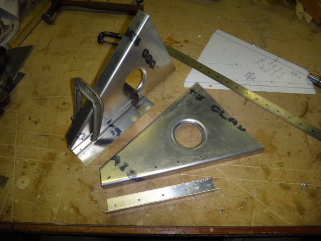

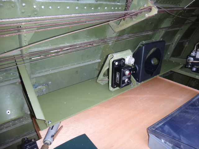

The next project at the Nav station is the equipment shelf above the table. This shelf mounts the Flux Gate Compass amplifier, caging switch, master indicator and dynamotor. It also has supports for circuit breakers, controls for the instrument lights and heated suit plug. The first thing was to bend up the brackets. The lightening holes are then punched out and flanged with dies.

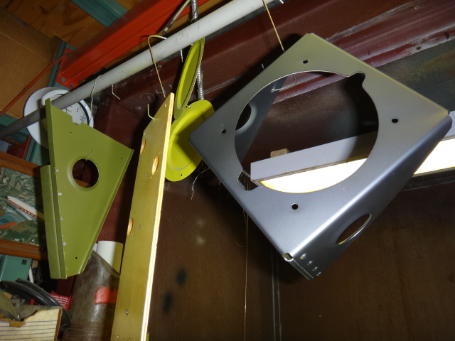

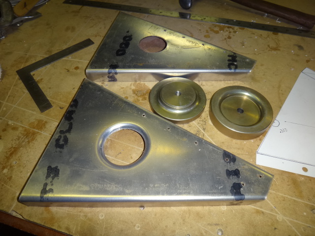

Then the angles are bent, clamped in place and drilled

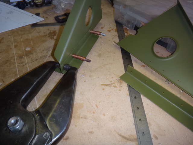

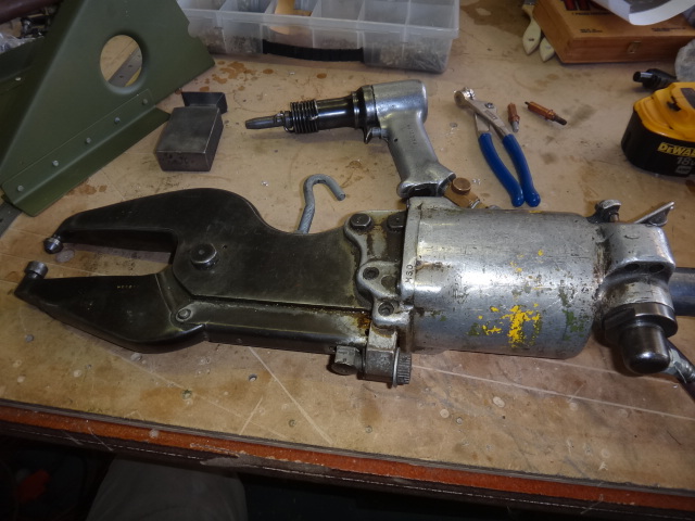

After paint the parts are riveted together. I love the big brute rivet squeezer. It can rivet better than I can!
Best $50 I ever spent
The parts are clamped in place, leveled and then back drilled through the original holes
I had one of these original shelves for the PV-2 that I picked up at the Pima Air Museum back around 1978 or so and I dug it out. Who knows it could have been removed from our very Harpoon. Here is one of the brackets being cleaned up. The paint is in decent shape and is full of part numbers and inspector stamps so it is going to keep its original paint. It matches the rest of the interior pretty well. It's only original once

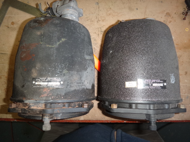

The flux gate master indicator mount also came on the old shelf I picked up at Pima 30 plus years ago but it needed some new paint.
The old shelf can be seen in the background and the new one is ready to assemble. Interesting how the shock mounts are riveted right to the wood shelf

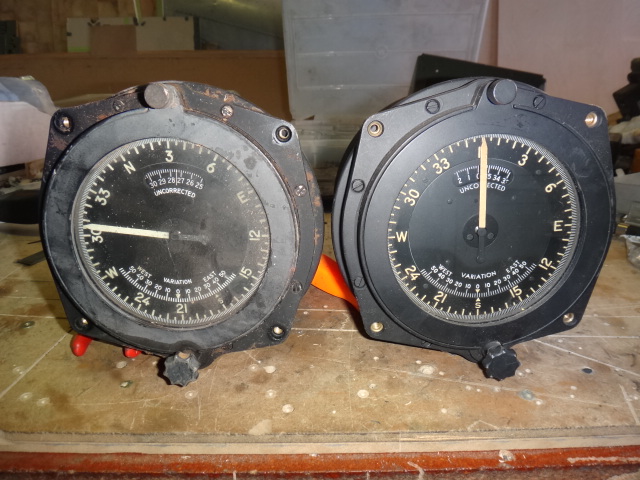

Final assembly begins

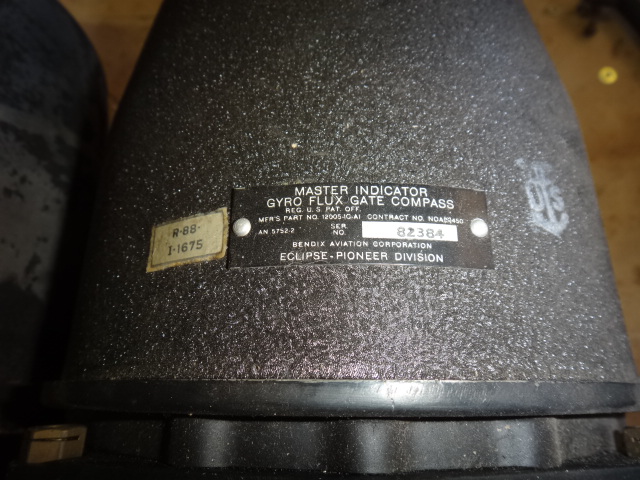

The old master flux gate compass indicator on the left which is not bad but the one on the right is new old stock so it in goes
Gotta love the Navy anchor stamp too. Army contract parts in a Navy aircraft makes for bad juju!
Oooh the nav shelf is nearly complete
The flux gate compass amplifier still has the QA seal. So if it doesn't fire up then is should still be under warranty!
The Flux Gate Compass is a fancy magnetic compass system that has a remote transmitter out in the wing as far away from magnetic interference as possible. The magnetic compass in the remote transmitter is also gyro stabilized to prevent wandering during maneuvering. The amplifier takes the signal from the transmitter and and powers the master indicator. There is also a slave indicator for the pilots panel. Its a standard 3 1/8th instrument that is not as precise as the master. This same system was used in most all Army bombers too.
