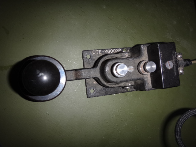

Coupla silly questions:
1. What kind of lubricant are you using for your dynamotor bearings? I have several dynamotors that need to be overhauled properly and I'm open to suggestions for some kind of modern lubricant that's readily available and doesn't cost a fortune.

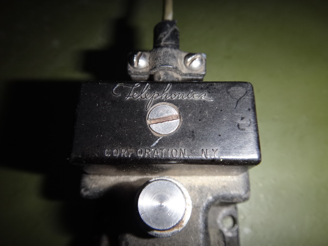

2. Just out of curiosity, who made your flameproof key? It's a Bendix design, but they were made by various companies including James Bunnell (CJB26003A), Moulded Insulator Company (CMI26003A), Telephonics (CTE26003A), and others. I have a whole box of those keys, but they're in really rough shape. The JB and MI keys are common as dirt. They must've made a gazillion of 'em. They were still in use on P-3's at least as late as the 1990s.
Rock on, guys 'n gals! (and cat!) :supz:
Thanks again for the donation!
Sorry I forgot to reply to your questions.
We use Aeroshell grease 22 for the bearings in dynamotors. 22 is a great high speed aircraft bearing grease that works great through a wide range of temperatures and has other desirable properties. If you want some send me your address and I will mail a vial to you.
Cool information on the explosion proof key. The key I found is Telephonics (CTE). Here are a couple of photos.

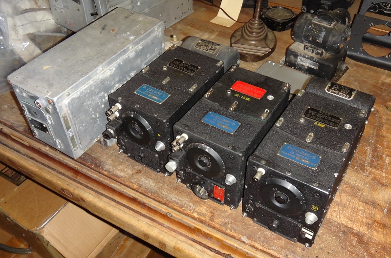

Here is a shot of the transmitters and receivers of the ARC-5 in our harpoon:
There are two of the three receivers on the top shelf and the third receiver and two transmitters on the lower shelf. This set also has the VHF transmitter and receiver (silver radios) installed which was used later in WWII. The ARC-5 used its own long wire antenna on the Harpoon from the mast above the radio room to the top of the left vertical stabilizer.

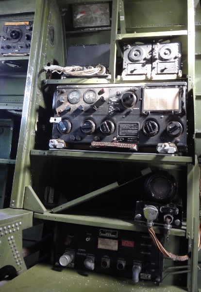

Long range communication was through the Liaison radios namely the ART-13 transmitter (Airporne Radio Transmitter) and the ARB receivers (ARB was from the early Navy designation system). The ART-13 was a technological wonder at the time. Designed by Collins is was compact when compared to the other transmitters of the day and could be remotely used. It had an autotune system that, through a motor drive, would automatically change the frequency by moving all 5 tuning dials to their pre assigned settings. This set was so successful that it was used into the early 1970's.
Here is a shot of our ART-13 (the largest radio) in the right hand mid body rack
The dynamotor below it is used to generate the high voltage power required for the transmitter.
The unit in the upper left in the photo above is the modulator for the ARC-5 system.
The ART-13 used either the long wire antenna from the mast to the right vertical stabilizer or the trailing wire antenna that ran out of the belly on the right side just aft of the radar operator.
The unit on the bottom shelf is the APN-1 (Airborne Radar Navigation) or radar altimeter. This unit would bounce radio waves off of the ground or water for accurate altitude above ground. A great set especially for Navy aircraft trying to let down through the clouds trying not to smack the water. There was a control and an indicator on the pilots instrument panel. The APN-1 used two T shaped antennas mounted on the bottom of the horizontal stabilizer.
On top is a frequency meter used to accurately set the transmitter and receiver. It actually mounts in the forward radio rack and an ARN-8 marker beacon receiver goes in its place.
The ARN-8 (Airborne Radio Navigation) receives 75MC fan beacons used for instrument let down procedures. It is the same system in use today for ILS or instrument landing systems and the fan beacons are called marker beacons. The ARN-8 used a wire antenna mounted to the right bomb bay door.
The control box for the ART-13 and the two ARB receivers are located on the radio operators bulkhead.
On the bottom row of the control heads from the left is the control for the ART-13 then two sets of ARB receiver controls (4 total) with the two coffee grinders in the middle. Coffee grinders refer to the crank to tune controls that resemble coffee grinders.
Above the radio operators table on the right upper side of the photo is the Automatic Direction Finder or ADF receiver. It is actually an Army BC-433 (Basic Component number 433 in the Army designation system) which was a part of the SCR-269G (Set, Complete Radio in the Army system). It is very unusual to see an Army set installed in a Navy aircraft. I still haven't seen the official documentation as to why this was done but my guess is that this was a superior system to the Bendix ADF installed in earlier Navy aircraft including Harpoons. The Army had been using the SCR-269 for a while and the Navy procured the system under the designation ARN-7. The ARN-7 became standard equipment that was used well after WWII and it was essentially the same exact set as the 269. I think that until ARN-7 sets were available the navy installed the Army sets. This is true for other aircraft as well like the PB4Y-2. Anyone have any documentation about this to share?
The ARN-7 used two antennas namely a loop antenna or football shaped antenna mounted on the top of the Harpoon and many other bomber aircraft. The loop was a directional antenna that could be rotated to home in on a signal. The other antenna was a simple wire that was called the sense antenna. The two signals were used to compare and determine the direction to the signal. On the Harpoon the sense antenna was the straight wire from the forward mast to the aft mast.
The other gear is the radar and IFF. The APS-3 (Airborne Radar Search) was a search and targeting radar that could be used for IFF work as well. IFF stands for Identification Friend or Foe. It is the early version of what we call transponders today. The IFF set or APX-2 (Airborne Radar Identification) would send out interrogation and receive responses from other gear. Used with the APS-3 radar the operator could see on his scope if a target was friendly or a foe. The code for the reply was changed daily so if you used an old code you were treated as a foe. Ships, submarines and of course other aircraft had the IFF gear. The IFF was also quite secret as you didn't want the code of the day falling into enemy hands. The transmitter/receiver had explosives installed to destroy the insides of the set during a crash through an impact switch or could be manually set off with a destruct switch. IFF gear is hard to find and we are lucky to have a full set to install in the Harpoon.

Thanks for the pics of your key. I love the "Telephonics" logo on the terminal cover! Most of the 26003A keys that I've seen (ones that appear to be unaltered) have had a heavy duty, rubber-jacketed, two-conductor cord, 3' to 5' long, with a PL-55 style plug on the end. The cords are about 1/4" thick o.d. I've seen a couple with WW2-looking ring lugs on the ends of the conductors, but I don't believe they would have had an aircraft use. These keys were used in aircraft and aboard ships, and probably for other purposes as well. Strangely, all of the Bendix keys I've ever seen were marked "Bendix Radio Corp. Type MT11B" on the terminal cover, and don't have the "Cxx-26003A" stamping on the base.
EDIT: I found a good photo on the internet showing a Bendix key with cord and plug:

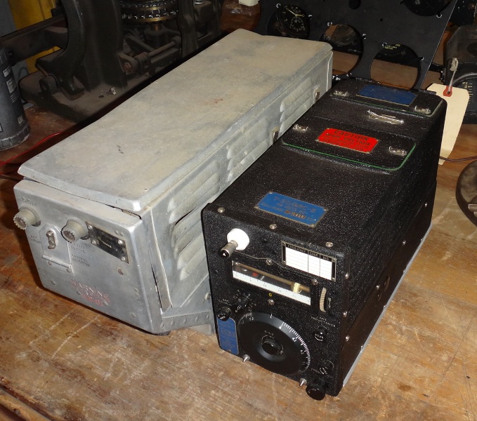

The VHF gear was very different than the rest of the transmitters and receivers. They slid into the same racks but had some extra connectors and control heads. The control heads had special switching to select one of the crystal controlled frequencies. I believe there were crystals in the other receivers that were used as a harmonic but that is getting way over my pay grade when it comes to electronics. I can wiggle a tube and clean relay contacts with the best of them but above that I need to call in the experts!
Here is a shot of three ARC-5 LF/MF receivers next to a beater VHF set. You can see that there is a big difference.
Trying to make the set fit in the rack and spill out in an acceptable direction was a chore.
The Army adopted the SCR-522 set which was a lot larger and from what I have read was a pain to keep tuned especially when compared to the ARC-5 VHF. During the war VHF was becoming standard equipment in both the Pacific and the European theatre.

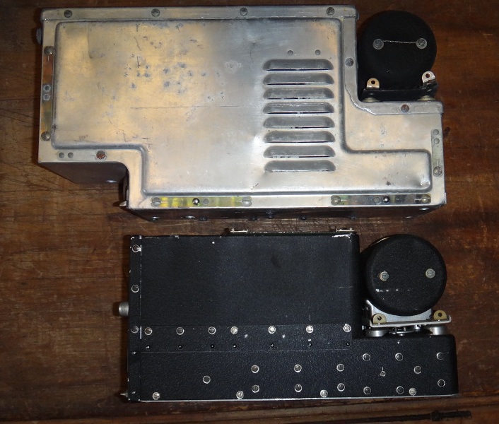

Here is a beater VHF transmitter for comparison to a nice one
Two of the ARC-5 receivers are now stowed in the Lockheed built (as opposed to the Aircraft Radio Corporation or radio supplier) storage racks in our Harpoon. Cool more boxes back where they belong. More and more stuff to bash your head on or have to wiggle around in the Harpoon to make her more complete. Most WWII aircraft were crammed full of gear.
