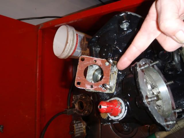

Rich, what kinds of signs did you all see that made you pull the pump??

Failed a couple air compressors due to lack of lubrication. Also has had an oil leak where you can't access it.

PostPosted: Sun May 03, 2009 5:15 pm
Posts: 392
With any luck we found the problem. A gasket on the vacuum pump didn't have an oil feed hole in it, and this is the feed to the air compressor that was blocked. The vacuum pump has a spacer plate and it has a gasket between the bottom of the plate and the gearbox. Considering what it took to get the spacer plate off, and then what it looked like, it was done long long ago and was probably not apart since the 1980's. This plane had to have had a dry (unlubed) air compressor since this gearbox was rebuilt, presumably by the Arnold folks.
follow the finger to where the hole should be on the gasket, and where the air compressor oil feed hole is on the gearbox:
This may also explain why this plane was flown so little in the 80's and 90's and then stored. We figure it was routinely lunching air compressors. Anyone remember why SM969 was parked after the initial rebuild and then after it flew in 1992?
