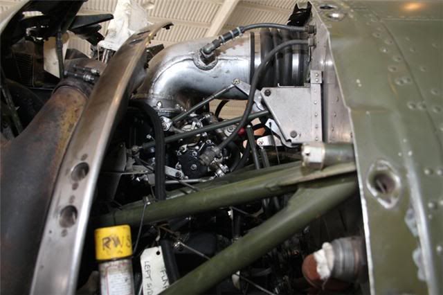

Getting close: fixing the #4 air box...

Heading out to the hangar in an hour to start up engine #4... wish us luck!

Had to scrub the run today because of a pesky fuel leak. We eventually got it tracked down but by then it was already dark. So is life.
Next try will be Friday or Saturday...

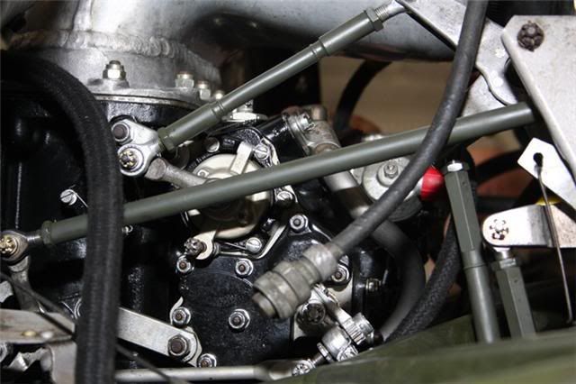

Freshly cleaned and painted throttle linkages on #4.
Subsequently I removed and replaced the rusty hardware on the mounting bracket (upper right corner) when I discovered those bearings were not as free as the discerning Warbird Operator would care for.
It was all tested for function and is now cotter pinned and ready.
We fixed the carb dribble... loose base nuts... and additionally John S. from LSFM found a cracked fiiting on our pet cock- no, not the rooster, the fuel drain!

SPANNERmkV wrote:
Great work Don. Now, if you don't mind doing me a favor......please go back and install large area washers on those carb linkage rod ends. Thanks.
Gary

Gary,
I just replaced the washers with shiny new versions of what was on the bomber to begin with.
On the few places where there were large pattern washers (the AN4 sized brackets) they seemed to hold the dirt and the skank onto the bearings quite nicely.
I don't mind changing them again... It is only CAF money for cotter pins and my knuckles. :roll:
Is it standard practice to cover those lolly-pop style fafnir's with a large sized washer?
This is going to come up again in other areas.
One place I can think of right off the bat is the mixture linkages on the throttle quadrant in the cockpit. That appears to never have been molested (or lubricated) and it has small pattern washers.
SPANNER the chastized
PostPosted: Wed Jan 14, 2009 4:07 pm
Posts: 4468
First of all, I meant no harm on that e-mail. No chastizing going on here. I very much value the hard work y'all are doing.
Second, it's my standard practice to put large area washers over exposed rod ends. This is merely a safety measure for in the rare occasion that a rod end fail, the washer will keep it in place to where you can at least retain some control of whatever it is that the rod end is actuating.
My apologies if I somehow embarrassed you with my previous comments.
Gary
PostPosted: Wed Jan 14, 2009 4:56 pm
Posts: 1275
Location: Houston, TX
Don't worry Gary...
I'll just go over and have meself a good cry in the corner.
:bs:
:wink:
Actually makes good sense to cover the exposed lollypops so if they do let go the bearing innards will at least be encouraged to function somewhat until the plane gets back down.

Two things,
1. I still don't see the air box you were talking about.
2. We had a throttle linkage break on FIFI one time on final, WFO! and 75 inches MAP for about two seconds. :shock:
