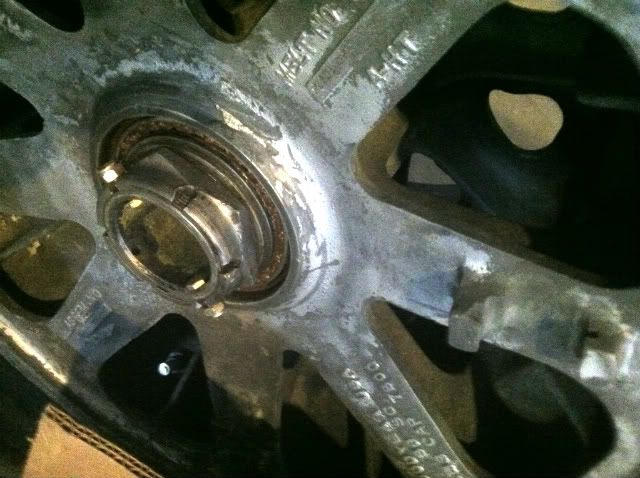

New game. This time, who can name the "Missing Mystery Part"? Careful you are specific because there may be more than one answer, but only one is correct. This is our nose wheel on the K and we are looking for one of these. They seem to be scarce as hen's teeth as they say over in East Texas. JR

It's the wheel hub of an Acme model 26B roller skate.

Muddyboots, you are so close, but nope... keep trying!!

If its the missing bearing cover you are looking for then I might be able to help. I recently came across one but I am not sure it is the correct size. Please let me know what the measurement is for the inner recess and the next time I am there I will check to see if it will fit.
Your nose wheel is a 36SC isn't it? [edit] Actually I can see that it is by reading the casting marks. I have a couple of 36SC wheels for a B-29 so I can get the dimension from those but to be sure send me your wheel measurement to be safe.

Taigh... sharp eye. It is a 36SC. This wheel was shared with the B29, B24 and P38 that I know about. Could have been others. There are two manufacturers though... This is a Goodyear which actually had at least two styles and the other was by Bendix I have heard. We have the style shown in the pic while the CAF A26 here has the straight ridges but still made by Goodyear. There are two styles of caps that I have seen. Don't know if it was a mod, but there seems to be those that are held on by spring clips that go across the top and others that are held on by some other means. Since we don't have a cap, can't tell what was there originally for certain. I don't think it was the clip though like on the B25. We would appreciate it if you could send a picture of what you found though at your next opportunity. Thanks, JR

Jim, it should be a snap ring. Is there a groove in the wheel ? I can't tell from the picture.

Well, between Taigh and Rick, you guys got it. It is the bearing cover and it is held in by a big snap ring. It is a Goodyear 36SC rim. Oh, if anybody knows a good source for 36SC tires, please let me know. Don't want the diamond tread. Need the straight tread. Anyone? Anyone? Bueller is on TV tonight. Onward and upward to Infinity and beyond!!! :-) JR, smilin in TX

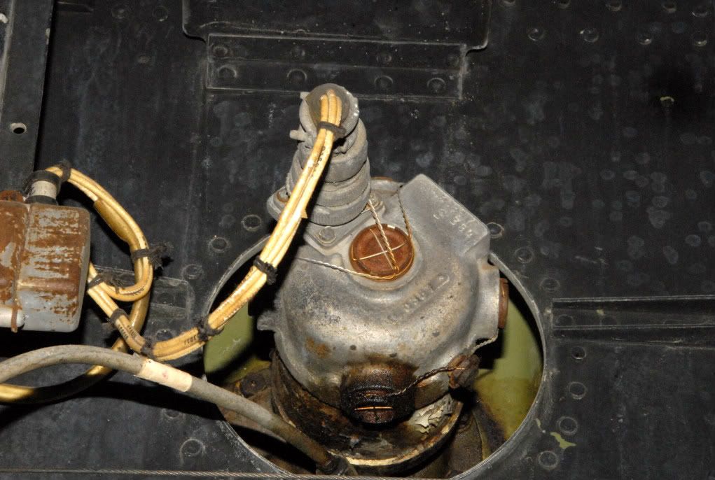

New Mystery Game. This time we play by Muddyboots rules. To win, you have to invent a name for this "big silvery thingee with the cannon plug coming out of it" part that is anything but the real name! Got it? Game ON JR

Fuel probe?

easy peasy. That's obviously the detonator on a thermonuclear bomb.
