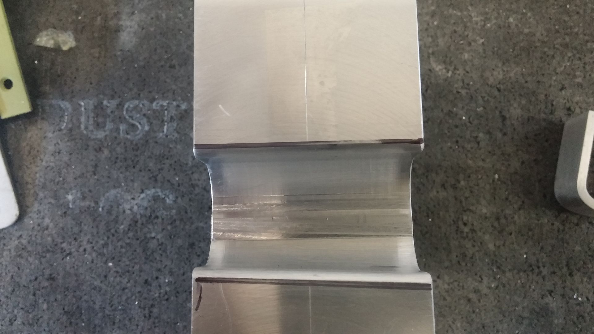

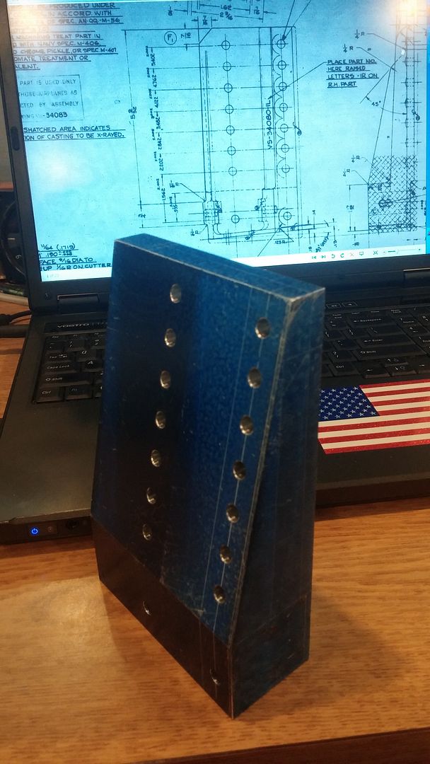

How involved can it be to make a little bracket? This is the oil cooler door position sensor mount tab. Either a link to an electronic sensor or an actual hard cable to a mechanical gauge indicates to the pilot, the cooler door position.
There are multiple versions as I have a Dash 1 door and a Dash 4 door. I have used the Dash 1 version. The drawing does not show the lack of parallel but the two real world samples I have are the same. So, female form die.
PVC form block using annealed .125" 2024
Couple holes and some massaging, ready for heat treat and assembly. Simple :?

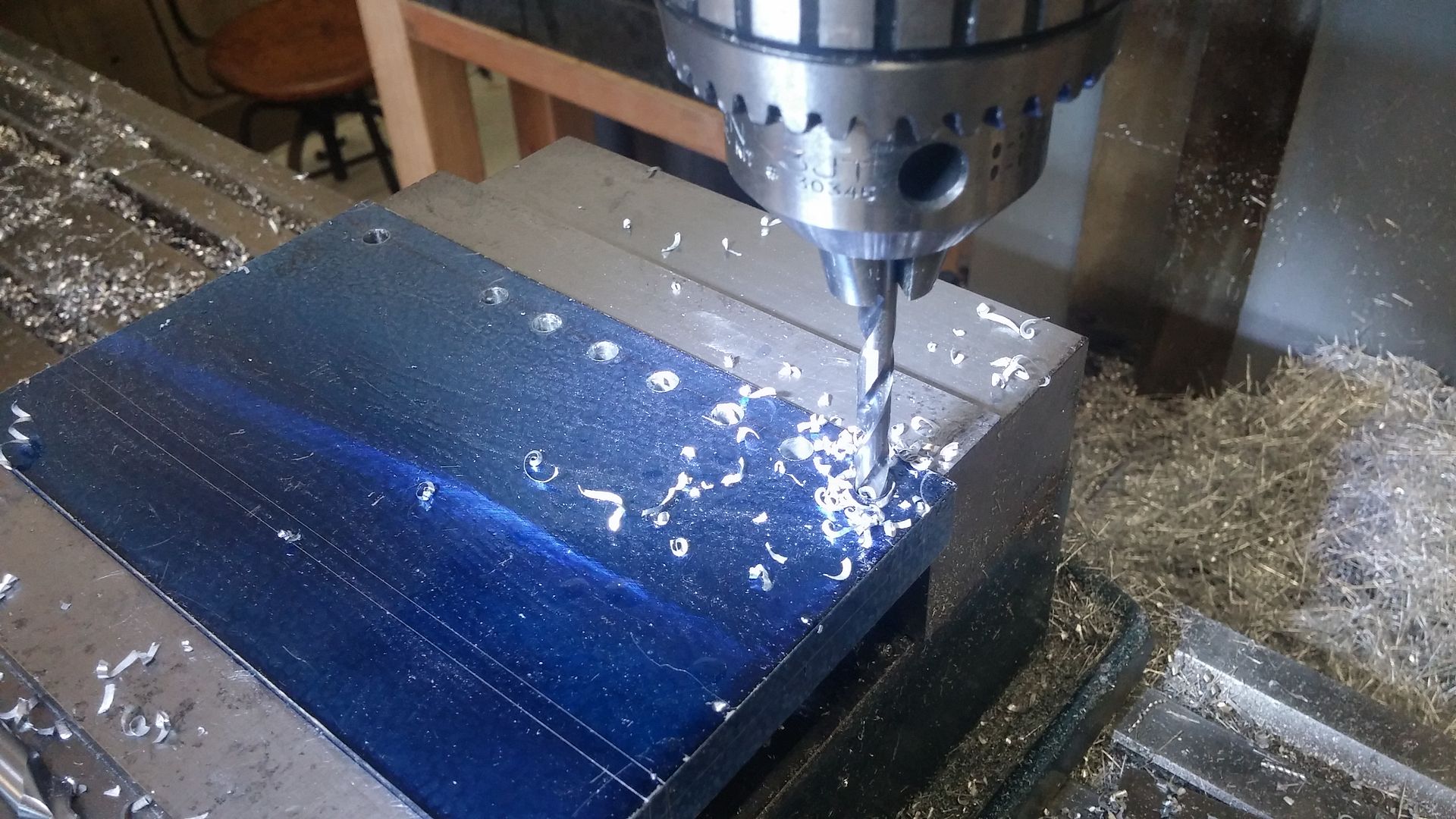

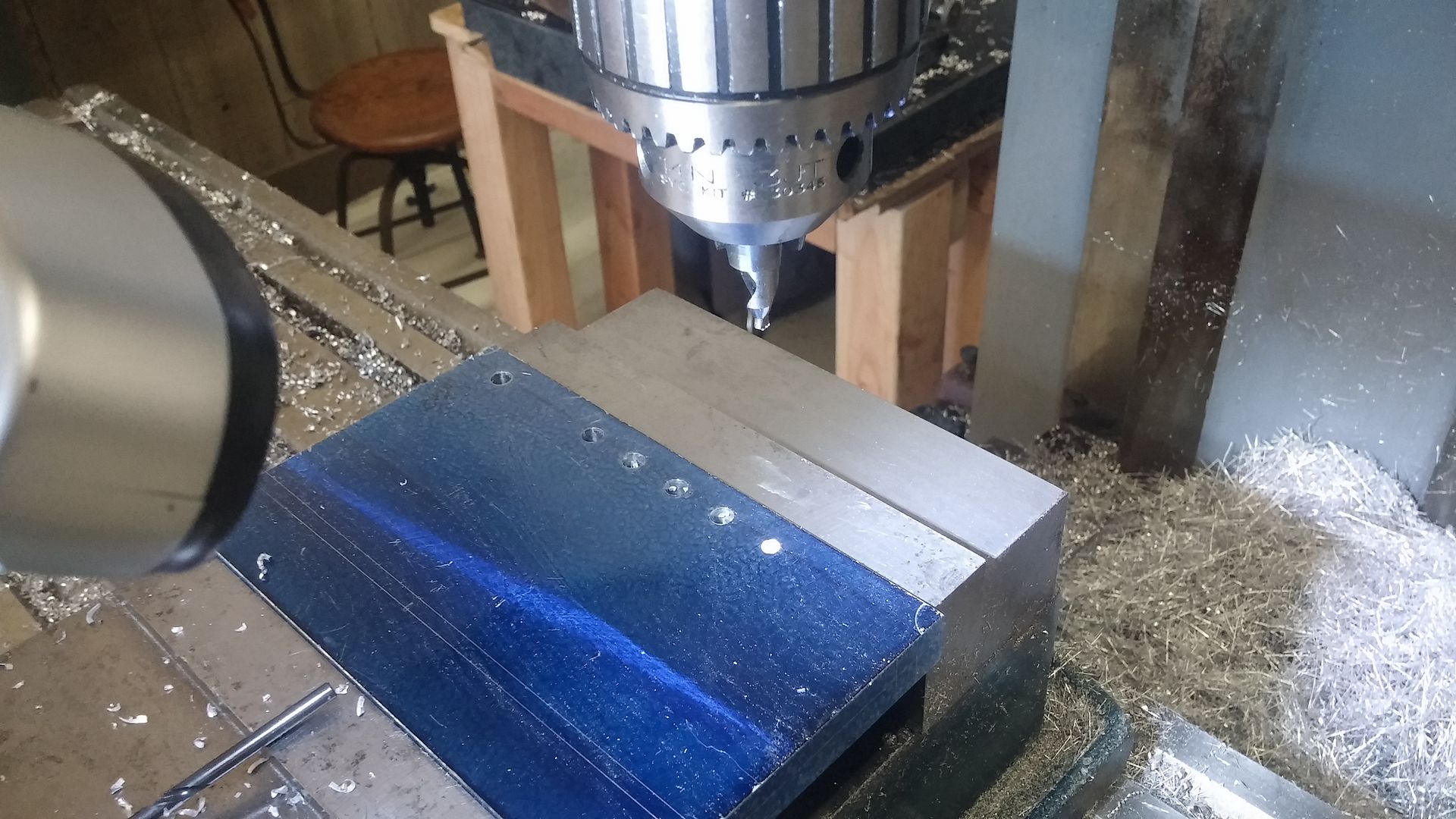

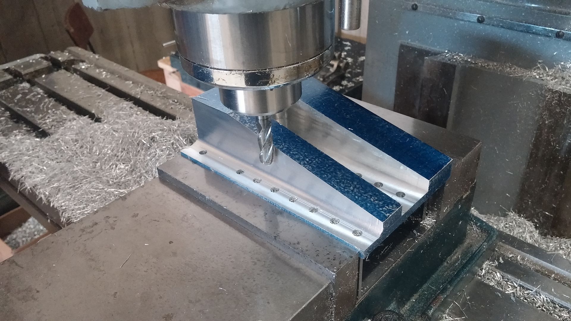

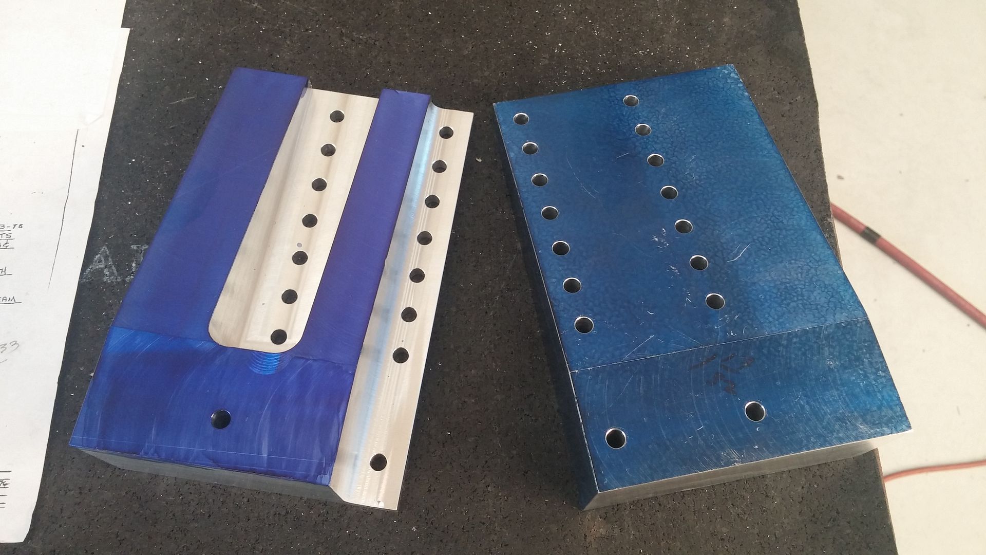

Here is the beginnings of the drop tank and bomb mount reinforcement fitting. A piece that ties to the forward side of the main spar along with a larger forging that ties to the rear of the main spar providing a secure mount for the drops and bombs. In the race mod, these were removed. I need it because it also is the lower mount for the center section main rib and the aft elliptical tube. It's a pretty convoluted part and will take some planning to decode the drawing and figure out the missing data.
Center drill
Pilot drill
Size drill
Will get final size ream later
PostPosted: Tue Mar 17, 2015 8:03 pm
Posts: 2184
Location: Waukesha, WI

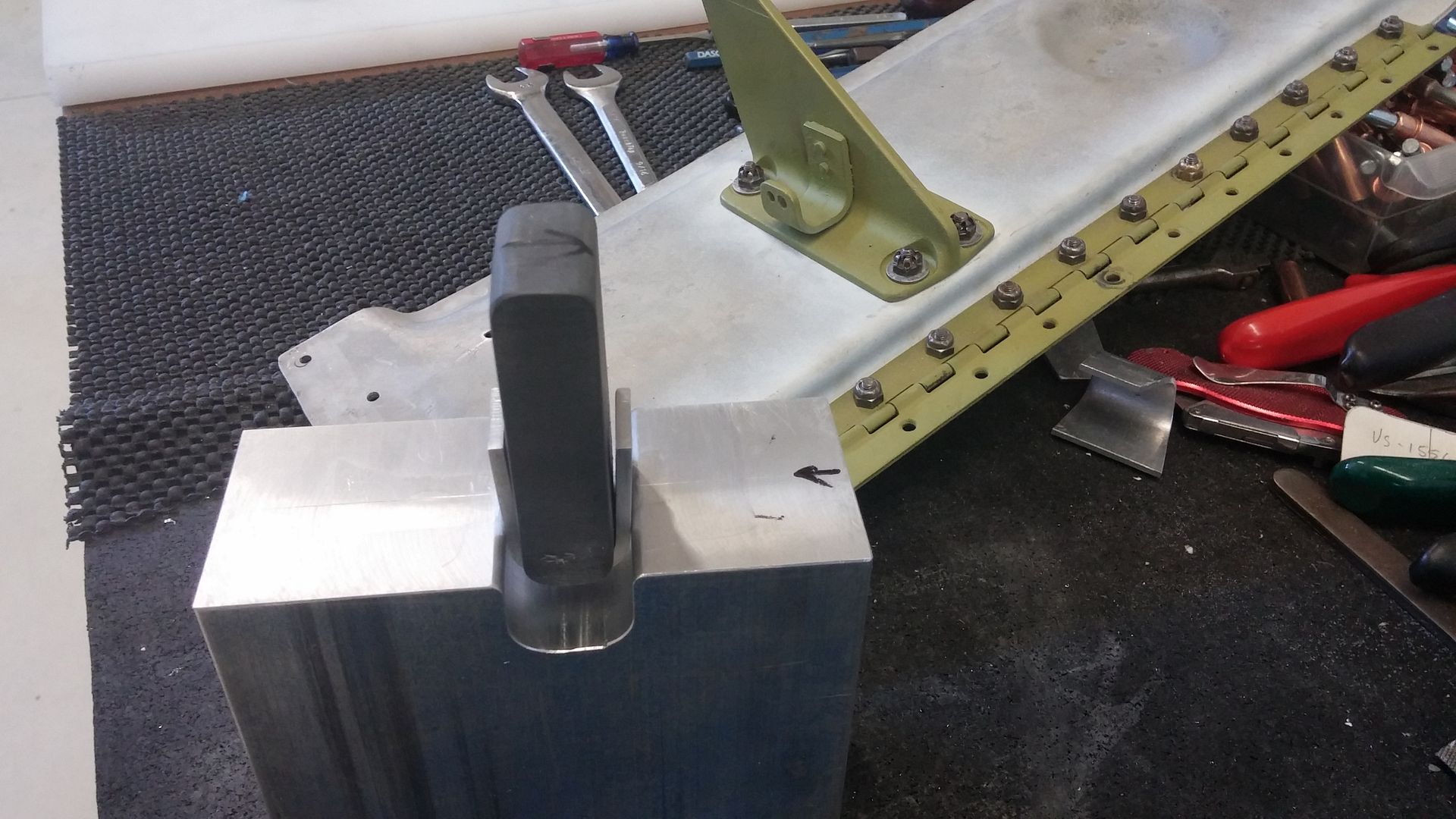

Chips, chips everywhere. Still roughing these pieces and dreaming at night how the heck to finish and fixture all the operations needed. Gonna take them to the plane as soon as I finish this operation on number two. Want to confirm the bolt fit. This better be one where the plane matches the print.

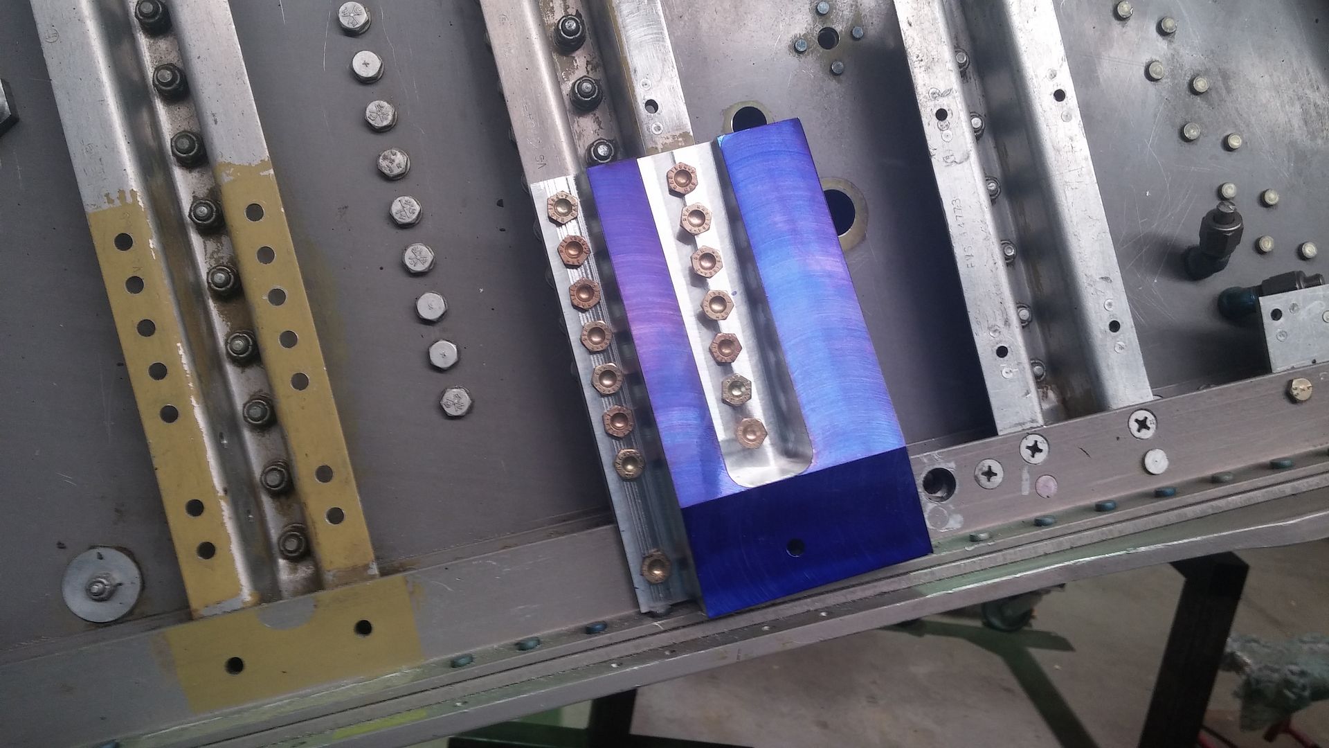

So, before I got too much time in these pieces, I figured I'd better take them to the plane to see if the drawing dimensions of the holes actually fit our plane. Haven't developed much confidence in that so far. Quick trip to East Troy and I win. Fit perfectly so now on to trying to figure out the rest of the operations to finish these. Really need to think in 3D.

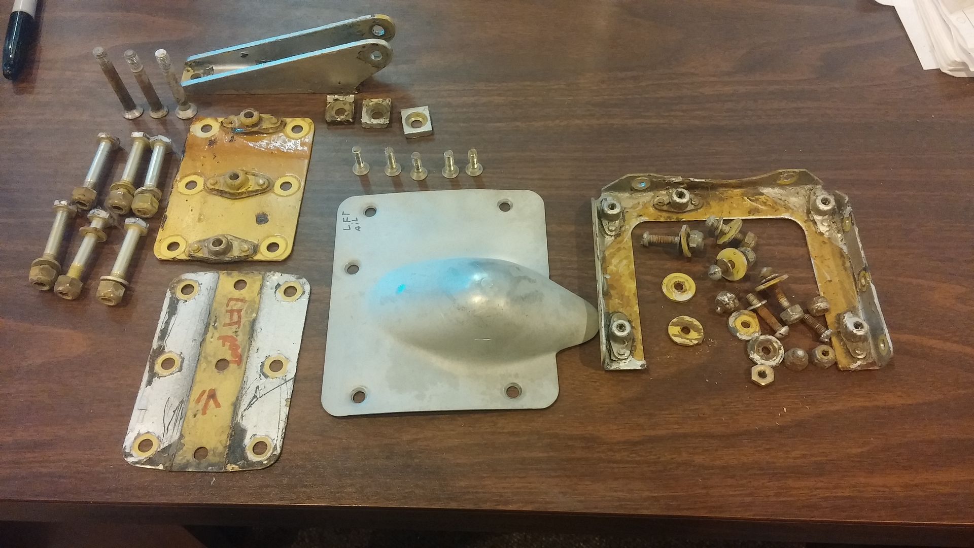

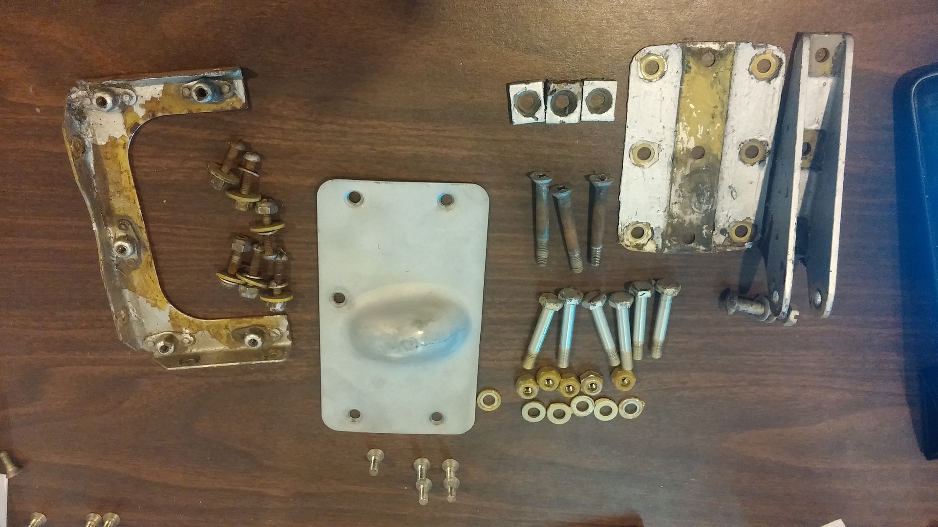

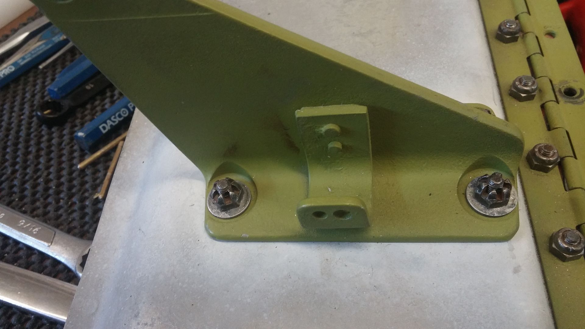

Wooden ailerons are being replicated by Max Aero in Hartford WI. Mark is the producer of Howard wings, Pitts Model 12 wing kits, Waco wing kits, Wittman wing kits and many of the spars for WAG Aero. The Wood God, a good friend and the right guy for this project. So, guess what, there are metal bits in these as well and I have been tasked with reconditioning the existing hinges and manufacturing the new third hinges. The racers cut the wings down and obviously, the ailerons. They were cut just outboard the trim tab on the LH side and matched, of course, on the RH. Also, the balance tabs on each wing were modified so the linkages and pivot arms all have to be remade. The goal is to have all these completed by the time the wings return to East Troy mid-year.
Inboard LH hinge
Center LH hinge
Center RH hinge
Inboard RH hinge
Both side balance tabs pivots were drilled and pinned for a solid mount. Pins removed, pivots and linkages will be restored.
Number 16 in your parts manual, number 1 in your heart... :lol:

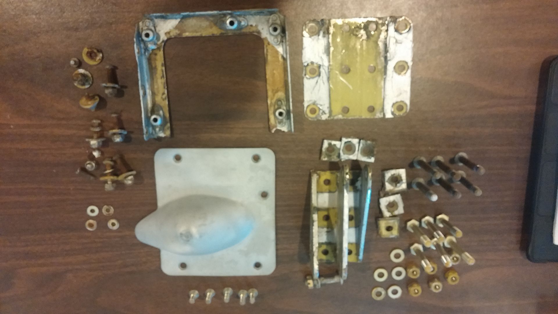

A little stripping today... 8)
Before
After...ohhh I hate that stuff but it sure works.
