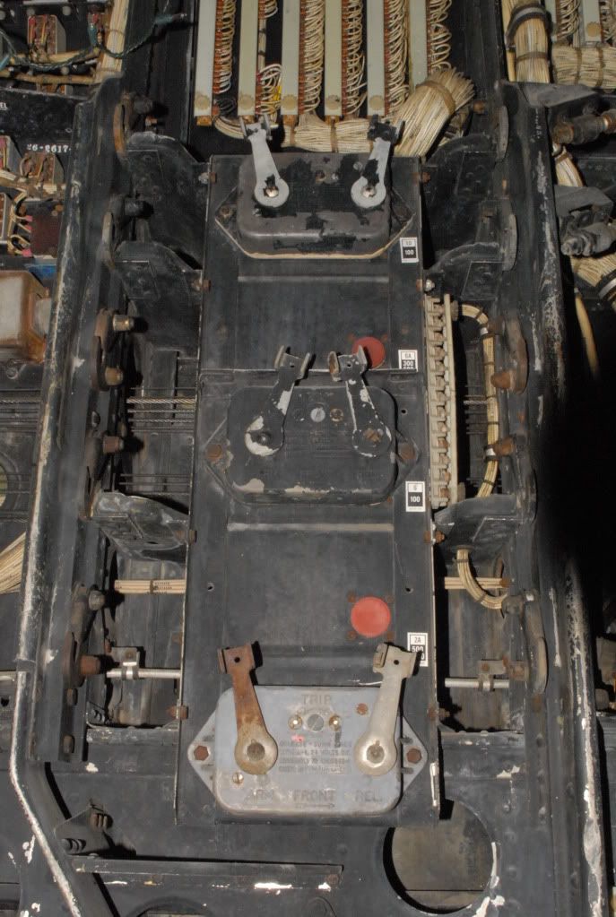

This is the aft left side of the bomb bay racks. The shackles will be removed and cleaned before we start stripping paint and prepping it for new. All placards will be preserved as much as possible and for those we can't save, we have replacement potential. JR

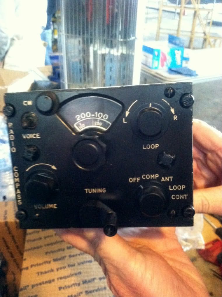

Rand is hammering out the restoration of the cockpit and radio panels. He is an old AF crew chief and he knows how to make these things pretty again. Just part of the makeover we want. Not too new looking, but just like it might have been for the A26 guys a year or two after coming out of rebuild at On Mark. BTW, I have been engaging in quite a few conversations with Bob Denny who is the son of the founder of On Mark. As a 17 yr old, he got to fly the first of the K's off the assembly line. What a heritage he has from his father who flew for Chennault after the AVG was disbanded. Kudos to Rand and Bob. JR

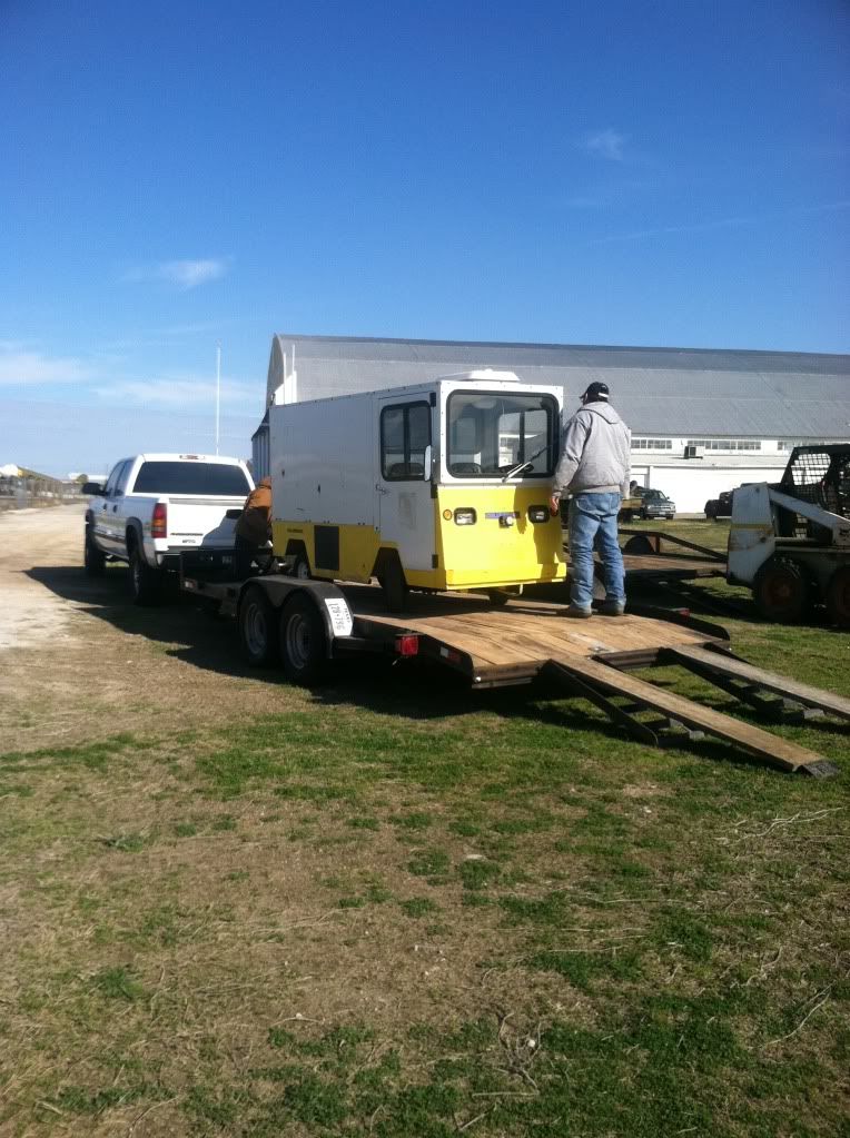

Yea!!! Arnold and Randy delivered the "Ice Cream Wagon" on this fine, crisp Texas morning. They figured out how to use the 48 V batteries that run the cart into an instant, presto chango, engine start cart for the airplanes on 24Vs. Just drive up, plug in and you got power!! Can carry tools in the back if needed on the ramp. Our hangar is now getting pretty full with the CAF A26 in the front. The B25 is still up on jacks at the front also, so maneuvering around it gets a little tricky, but Bill G and the CAF guys seem to have a handle on it. The former Spirit of Waco got a wash job today. Wouldn't that be awesome to see 4 A26's coming over in formation? Anyway, we plan to share the new start cart with the hangar occupants. Nice option to have. No ice cream though until next summer. Oh hey, I just had a thought. We have a margarita machine. I wonder...... Hey Arnold... don't go away just yet. :-) JR PS, see more of the cart at www.a26k.org or www.gga1.org and click on the A26. Go to the A26 Information page.

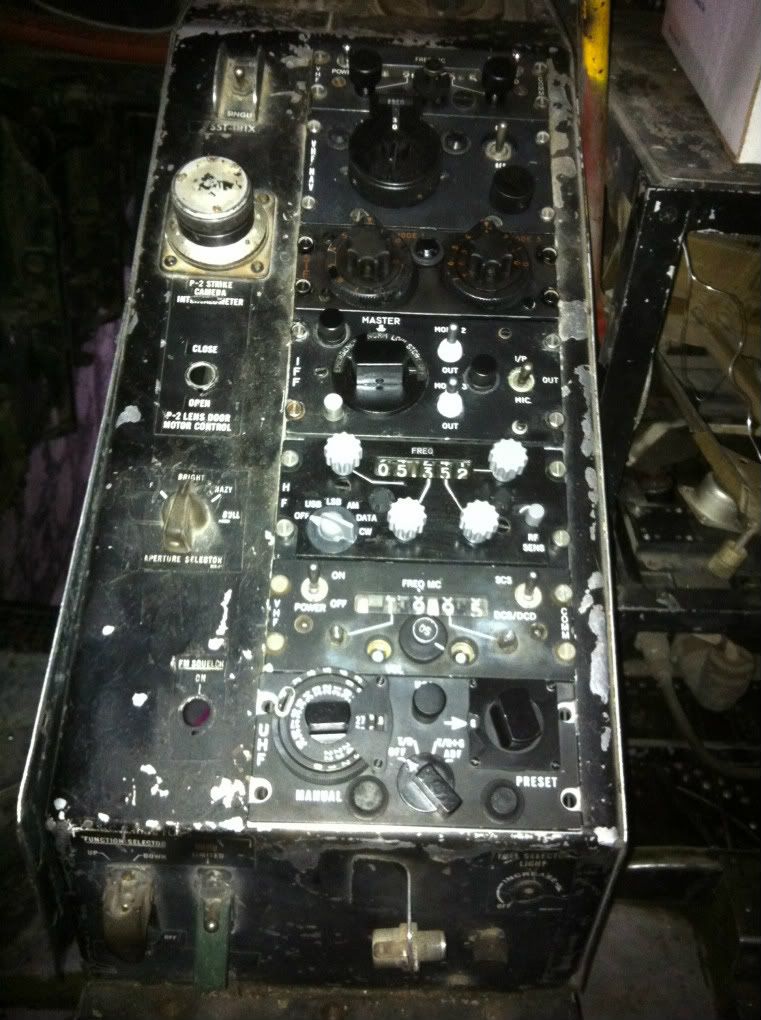

This one is for Dean and all the other radio guys. This is the center pedastal which has camera... yes camera controls plus some of the radio equipment. There is a another stack of remote control heads that goes down the middle of the instrument panel between the pilot and copilot's flight instruments. More about these later, but Rand is cleaning up and restoring the painted lettering on each of the control heads plus making the knobs and switches work again. Hot dog!! Not only can we nape those feral hogs for the BBQ, we can take pictures while we do it. Anybody got a lead on cameras that were designed for the bomb bay?? :-) JR

That is awsome Jim!! You provide the power and I will get Jimbo G to provide the ice cream!!! Tractor ice cream that is, the best ever!! Best hangar mates ever!

Those bomb releases look familiar. After the problem we had with "hung ordnance" we had to start performing a full function check prior to loading. Cock all of the releases, then get in the cockpit and step through them while someone observed in the bomb bay, making sure they tripped. Don't remember how long that went on. We tested the system in "select", "train" and "bomb bay jettison", then tested the releases to see if the "safe" side of it worked OK. It was kind of fun experimenting with the "BRIC", setting different intervals and airspeeds and listening for the delay between releases. Think they eventually gave up on the daily testing, since we were never able to reproduce the problem on the ground.
