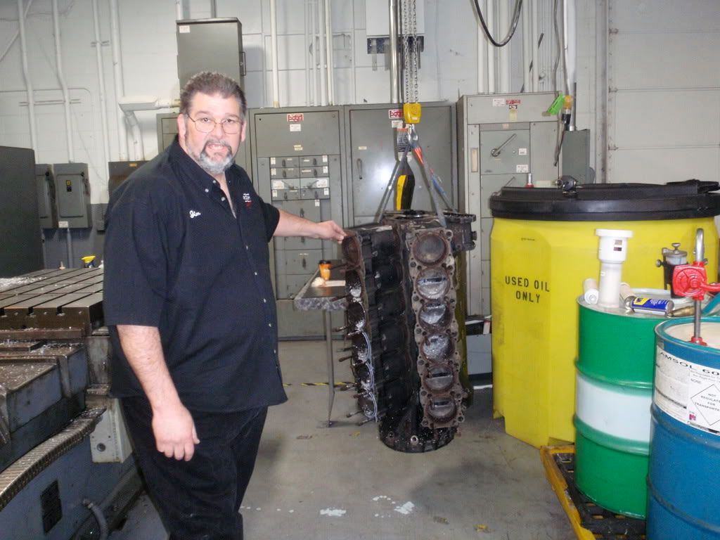

Are those 500 heads? How many hours SMOH and how many cracks? Can't see the red marker in the pix from that angle.
Lookin purdy!
Thx,
VL

vlado wrote:
Rich:
Lookin purdy!
Thx,
VL
Actually they are 620.
There were a multitude of cracks in each head. Some required work on the seat and spark plug hole areas. A couple spark plug holes are welded up in the pic.
Rich

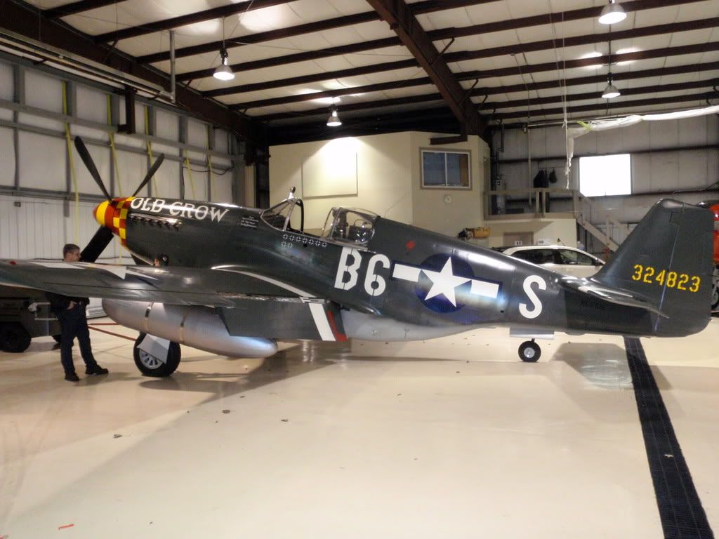

Here's Old Crow as a centerpiece

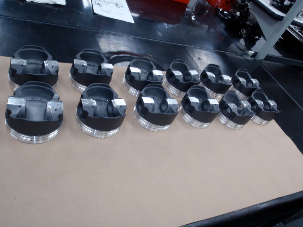

new pistons with the teflon coating, the anti-corrosion stuff on the top, and these funny anti-detonation grooves. The work is just fantastic.
Big Jim with the project du jour. This will live again; found somewhere after sitting forever, it's only got 500ish hours on it, but the pistons are so frozen into position that the autopsy is taking a different path. Drilling around the piston so as to save the rods and the crankshaft. If you look closely you can see the cuts in the pistons. Really cool stuff.

Isn't it cool to walk into your hanger in the morning and see Old Crow waiting for you with that canopy open? Gawd, very cool.
Amazing work they do. But, what are those "anti detonation grooves"? Never heard of this. Will it save some engines? Is it a race mod? Race = NASCAR or Reno?

vlado wrote:
Jim & Rich:
I still remember 'mopping the floor' at Subway after Big Jim's last visit out here!
Thx,
VL
It is in all the Merlin PMA approved pistons they make.
Rich
Thx,
VL
Maybe Paul can step in here but they're little grooves which are believed to act as accumulators to soften the blow down the side of the piston. There are lots of small circumferential grooves above the top ring, and then one bigger one between top two rings.
Jim, you've pretty much got it.
The idea behind the grooves is they act as small accumlators and dissapate some of the energy (pressure) that results if detonation occurs. This will help protect the piston rings in the event of detonation.
