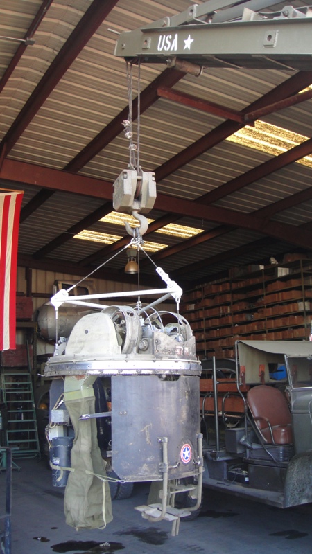

Travisd80elcam wrote:
I do have to ask though, have y'all been able to locate a top turret for her?
As a matter of fact we do have a Martin turret slated for the Harpoon. The turret goes with the rest of the aircraft in that it is in original condition and is still operational. We still need to make the adapter ring to mount it. I have a new old stock high profile dome for it but I will not bring the perfect original dome out in the sun. I have a reproduction low profile dome which will have to suffice until I can reproduce the correct high profile dome. Here is a shot of turret being lifted by the old 1945 Federal Wrecker truck at our museum. We will use this truck to install the turret in the Harpoon when we are ready but there has to be some conflict by using an Army truck to do Navy work!
If anyone is interested there is more on the wrecker truck here:
http://www.twinbeech.com/SFAMc2.htm

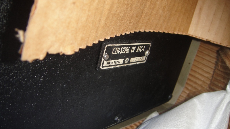

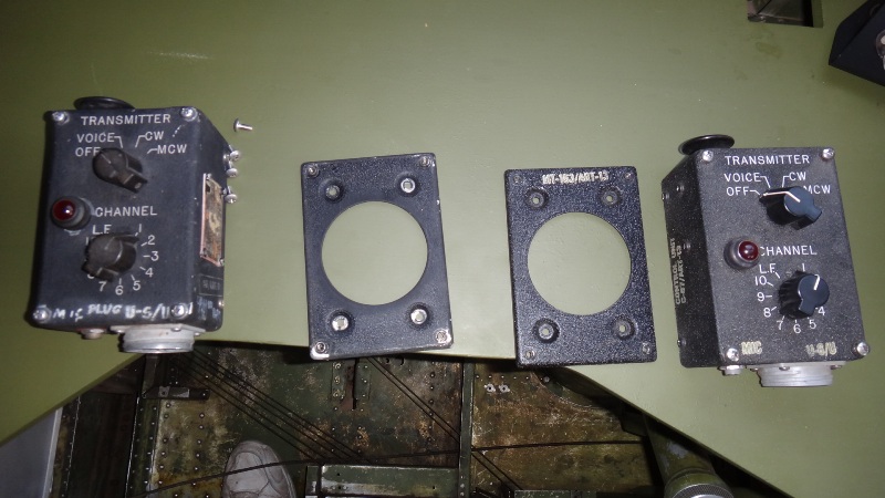

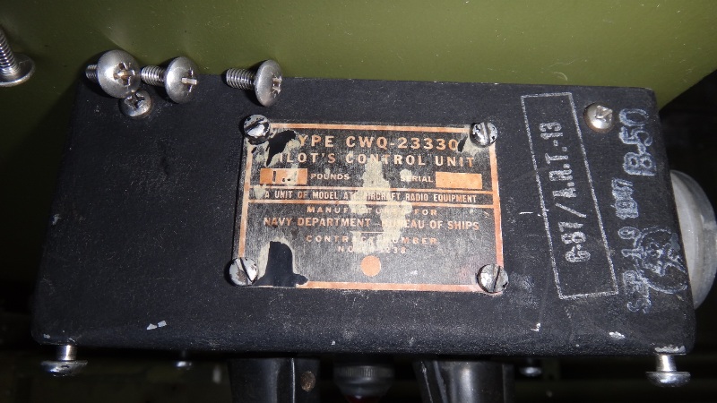

Speaking of ART-13 I recently did a revision to our set. The control head I had originally installed was early ATC
and was not in the best shape. At the flymart at OSH last year I found a new in the box late war control head for the ATC transmitter (ART-13). Here is a shot of the old one removed on the left and the newer one on the right
You can see the older control box's data plate and the stamps from post war mods. The mods in this case are simple stampings since the control box's are identical electrically and in function.

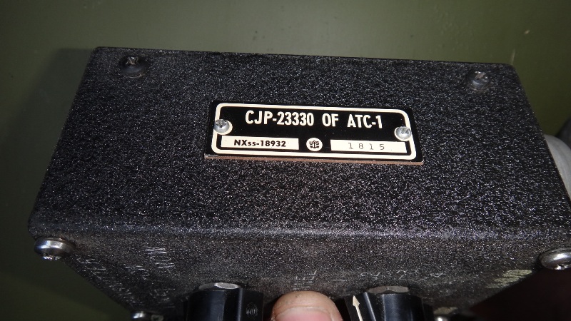

This is the late contract control head which matches our ATC transmitter (not the one presently installed but the one that will go in. This head also has the same stamps as the earlier head identifying it with the joint Army/Navy designation system namely C-87/ART-13

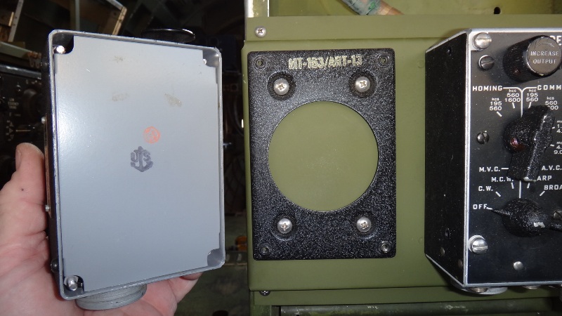

Ooooh, Navy anchor stamps!
I guess I am a rivet counter and I will post the serial numbers of the carbs later as sadly, I do not have them memorized :wink:
Here is the new head installed in place of the older one. As we come across better gear we will continue to upgrade. To the left is the ART-13 soon to be replaced with...
this ATC transmitter which is slated for our PV-2D. As soon as I dig it out of the storage hangar that is. It isn't NOS but looks to be an overhaul for Trans Ocean Airlines in 1955. Pretty good shape as it came in its shipping crate. I picked up two of these on eBay and one was an ART-13 and this one was the more rare ATC. It should be perfectly operational too.
This is the data plate on the ATC transmitter which is a close match to the control head. Same exact contract and only 276 serial numbers away. Pretty lucky to find components so close together. Now all I need is to find the same vintage dynamotor.
Its nice to be able to find the correct gear for the aircraft/project which isn't always possible. With time, patience and perseverance it can be done. The ultimate puzzle.

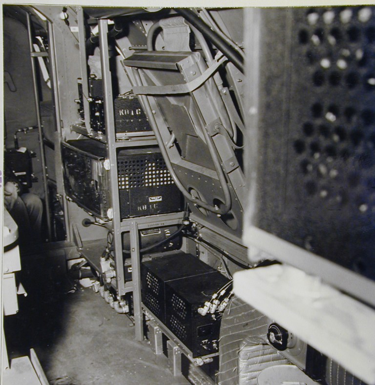

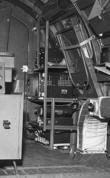

This shot shows an early production PV-2 where you can see the earlier ATC data plate
Here is a shot of what I believe is a mid production PV-2 showing the ATC with the later data plate which I think is correct for our PV-2.

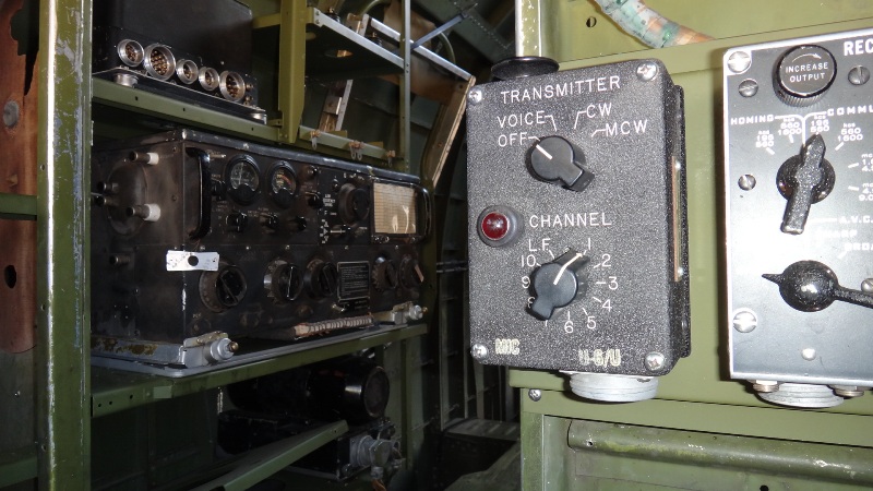

Check out the Plexiglas protective cover over the face of the ATC. I think it was for protection of the crew member as a crew station with a seat belt was on that floorboard against the spar. My second guess is it was to protect the radio from getting bashed as people were transiting through.
The APN-4 loran receiver/power supply can be seen in the above photo at the bottom middle with the indicator located above and to the right and out of focus. The indicator was mounted on the front side of the radar rack and was pointed toward the navigator. The APN-4 indicator in our Harpoon and other late harpoons was on the other side of the fuselage closer to the Navigator. I am still trying to find out exactly how it mounted as photos and information of this has been very elusive. I know that it was supported from the floor but how the rest was mounted is still a mystery. More fun puzzle stuff!

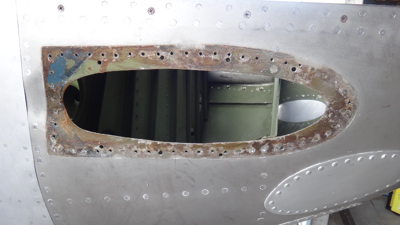

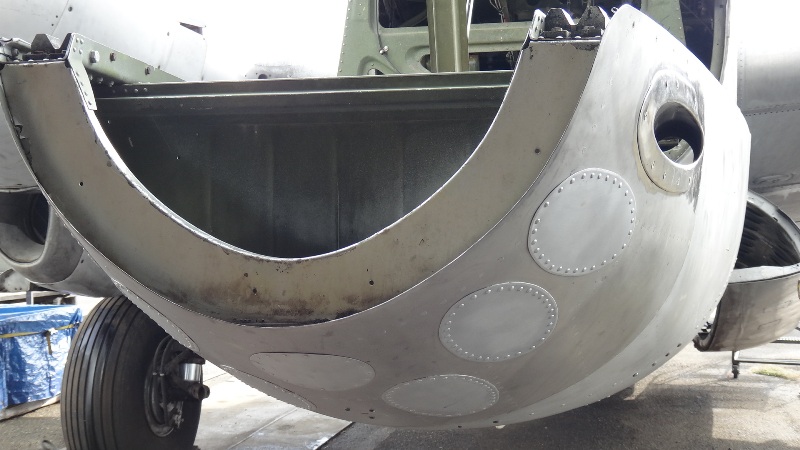

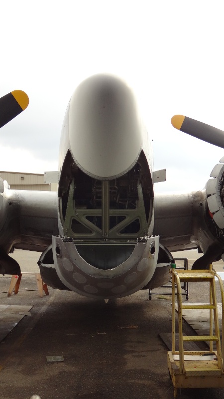

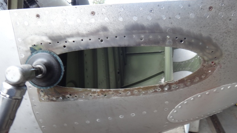

Gun ports
With so much to do on this project if you get tired of working one think like radios or radar (is this possible?) then you can simply pick another subject and work on that.

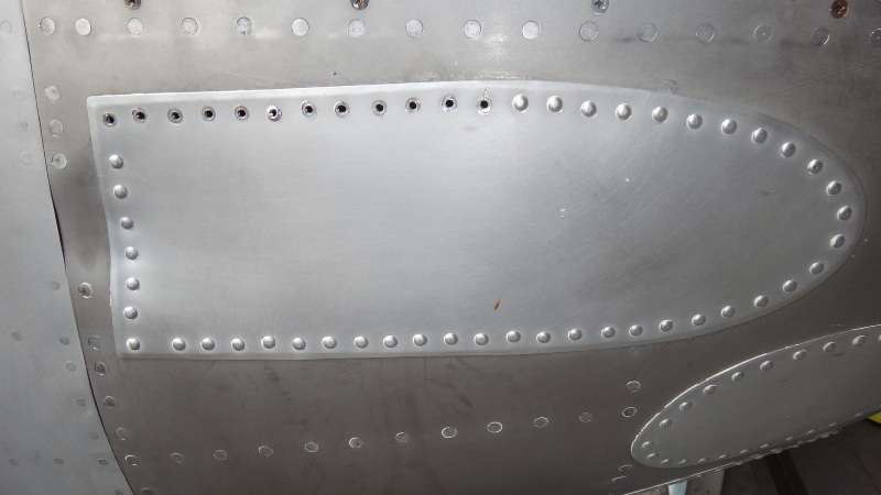

The gun ports were removed along with the rest of the military gear when she was converted to an air tanker. We were lucky enough to acquire four out of eight of the unique original gun ports we need for our D models gun nose. The nose structure where the gun ports are is made from stainless steel as are the ports themselves. Stainless was needed for the strength to withstand the gun blast and the corrosive effects of the 8 50 cal guns blazing away at about 10 rounds per second per gun.

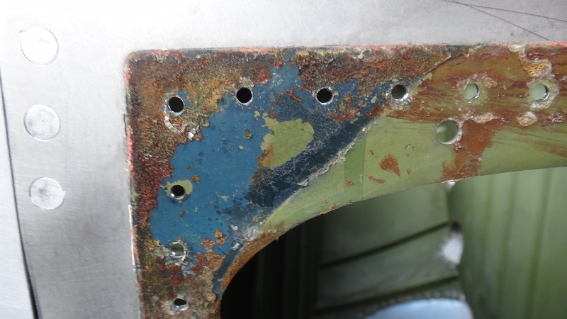

The ports were covered with aluminum and riveted in place. first step is to drill out the rivets to remove the plate. Notice the concave dent on the left or aft side of the port. I thought this was interesting as there is a matching one on the other side. More on this later.
Look at the original paint and primer under the plates
Next the area is cleaned with Roloc wheels. Lots of extra holes from the rivets most of which will be covered by the gun ports. I think these can be tig welded by someone with better welding skills than I possess.

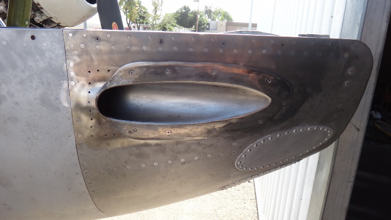

The gun port back in place with some metal massaging being needed first. The matching dents on the aft side of these upper ports was originally convex as it was contoured to fit the aft end of the tube. When they removed the ports back in 1958 they simply hammered the convex form into a concave shape and riveted the plate over it. A sheet metal hammer was able to pop it back out and the gun port slid right over it and fit just like it was supposed to.

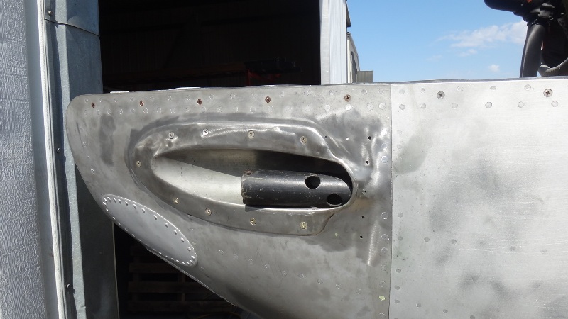

And of course I couldn't help but slide a 50 cal cooling jacket in place :roll: boys and their toys (I was channeling my wife just then)
2 out of 8 gun ports help turn old Tanker 101 back into a Warbird. One step at a time and now we have additional air conditioning for the pilots just in time for winter!
Now all we need are a few other items to finish out the nose... :shock:
Anyone want to donate a 50 or two? One of the problems with this project. We have a good collection of the solenoids, chargers, feed chutes etc but this beast has 8 of each in the gun nose alone and we certainly don't have that many. Its gonna take a while before we can outfit the whole nose but imagine when we do. What a display with the nose down at an air show where you can walk right up to 8 50 cal guns and ammo boxes, feed chutes and all of the bells and whistles...okay stop daydreaming and get back to work
