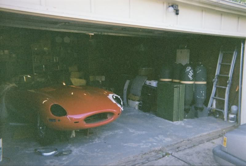

We are stashing parts ALL over the place. We aren't particualr, except I hope that Jag doesn't leak oil all over the bombs!

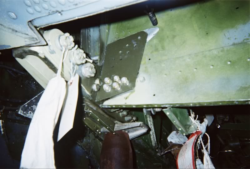

And here are some lovely shots of the Compression Strut Tie Bracket "Napkin Holder" mostly installed! WE still need to hock bolt in the top of the diagonal brace and get the bolts reamed to size through the napking holder. But it is a lot farther along than it was three weeks ago!
SPANNER

Just worry about a nosy neighbor seeing the bombs and calling the Bomb Squad (or Homeland Security)! Then you have real trouble! They will blow up your house and ask questions later!!! :shock:

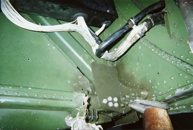

Da dum...
Who can spot the changes in this picture? (Hint: one is easy and the other one is a bit harder to see...)
-David Carr
B-17 Texas Raiders --- Maintenance Officer
Ditto!!!!! Do yourself a favor, take a cardboard box and open them up and block off the view to the outside world.

Looking good!!!! Wish you guys were still progressing foreward instead of packing the thing up.
