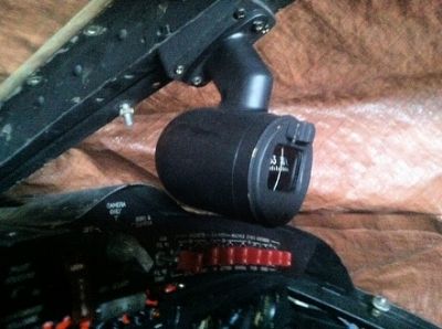

Larry installed the new compass and mount earlier this week. It is quite an improvement over the jury rigged mount that was there previously. Saved a bunch of space and cleaned up the look tremendously if you compare to an earlier cockpit photo a few pages back. Thanks Larry!!!
On another note, the hangar dance is tonight and the weather looks to be perfect. No reason not to come enjoy a Big Band with a B-24 as the backdrop. Not often you can see and hear what it was like back in the 1940's. Many folks are wearing clothes or uniforms from that era, but it is not a requirement. Sure adds to the scene though. You can still buy tickets on the Vintage Flying Museum website to save $5 or walk ups are welcome. See you there!! JR

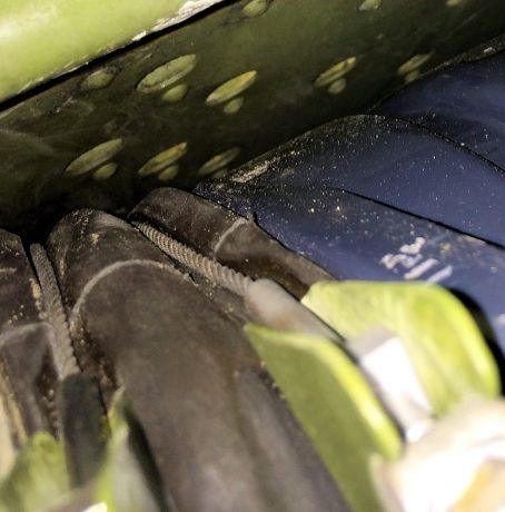

So now that the hangar dance is over and the hangar is restuffed with airplanes, we need to get back to business. JR and David A have a plan to finish up the oil cooler straps. The picture shows just how tight a space they have to work with to get those cables across the seals. Part of the problem has been the alignment between the cooler and the air inlets. It is off just enough to prevent the seals from settling in as they should. Saturday should see another attack on the problem. In other news, the newly overhauled Carb Air Temp gauge came in today. That just leaves the Fuel Flow gauge to go. I expect it late this week or early next. Ray will be finishing up the repair to the nacelle on No. 2 so when the engine comes back next month, we should be ready to mount it to the QEC and then get Ichabod over to lift it up to the airplane and mount the prop. We are getting anxious to hear airplane noise, but there are a lot of details left before we get that far. The report on No.1 engine's ignition system, mags, wiring harness etc is rather lengthy.. translated...means expensive. Looks like it may run over $6000 to overhaul, but this is good insurance and money well spent. This is going to be the most expensive year ever on the restoration costs mainly due to the engine overhaul, but also the other big ticket items that required overhauls like the oil cooler, various pumps, instruments, generators, etc. Again, better to know where we are starting than have to wonder about more unknowns. Stay tuned for more progress. The Other JR PS the B-29 is back in the hangar. FiFi, the B-24, Beech 18 and Buba all depart for the Midland CAF Airsho on Friday at last report. Might be a good day to drop by Meacham Airport and hear a lot of good noise. See ya there!

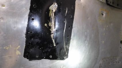

If it has a scab patch on it, then JR likes to look underneath. It's been a good thing he has made this a practice. We have found numerous things that really needed attention. This is the latest one on the left inboard flap lower surface. Apparently it is more crash damage from the Macon unpleasantness... yuk. More work for Ray and Lou. They sure could use some sheetmetal help if anybody is willing to volunteer. This is one more project to be tackled this coming Saturday. Really a shame Broomrider 1 can't just wiggle her nose and make it all better, but she claims she doesn't work that way. Wonder what she wiggles then?? :-) The Other JR
