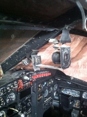

Ahhhhh, the next project for the cockpit crew... the compass mount. We are not certain where or when this mount was "constructed" and it certainly is well dampened, but it does not match the original in the Tech Order. Anybody got a clue as to why it was done this way? We noticed that Buba has a similar sort of arrangement although not an exact duplicate. The video and pics of K during her military days all show a very simple mount. Larry has found the appropriate mount and it is on the way. We also have a new BMEP gauge, new Fuel Flow gauge, and some other associated hardware on order. We found eight new static wicks for the ailerons and elevators so that is another square filled on the to-do list for the avionics guys. Larry put in some overtime today working on the instrument panel. Kudos go to him for going above and beyond on this project. If you aren't aware, all of our people are volunteers. That's pretty incredible considering the high caliber of talent and dedication of these guys. They are doing a magnificent job. It will be worth the wait!!! Cheers, JR

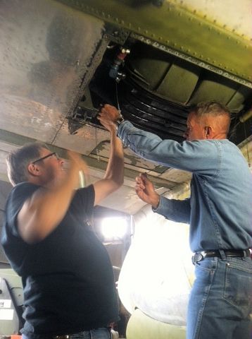

The real JR and David A banged on this right side oil cooler for the better part of one weekend. Those last cable pulls were a bear because the cooler did not line up exactly right on the front side with the air intakes. It took a bigger hammer and maybe a rubber bygawd to coax it into place. But they hung with it. That's what I mean by dedication. The real JR is taking a little trip up to the Northwest this week so maybe he can get a look at one of our ignition harnesses we sent to Precision for overhaul. Doesn't look like our engine will be back before the VFM Hangar Dance on the night of Oct 4. Shucks! If you haven't gotten your tickets yet, be sure to visit the Vintage Flying Museum's website for a discount. The GGA DC-3 will offer rides as well, weather permitting. And we will kick off our raffle for an aviation themed quilt that would make a great Xmas gift. More about that later. Can't think of a better way to spend a Saturday night than with a Big Band and airplanes!!! See ya there!! The Other JR

Regarding the No 2 oil cooler installation, I recall from my F4-E days the maintenance / flight hour ratio was 72:1. We were elated when the A-10 came into service at 48:1.
With Kay, and I suspect most warbirds, maintenance hours wasn't a concern. Accordingly the maintenance manuals reflected it. Here's step e. "Install rubber seals to oil cooler and air ducts with cables and clamps".

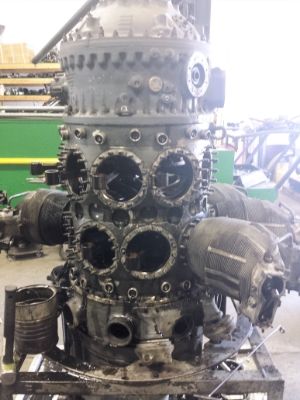

This was an earlier stage in the teardown of our engine. Guess I overlooked it, but I like how it shows the cylinders that are still on vrs the empty slots. Sure like to know what it looks like now, but it is one of those things where you don't want to disturb the doctor during surgery. :-) And how bout the O2 Lady knowing Latin?? Didn't know Broomriders ... oh wait, now it comes clear, their special books are written in strange languages and it is getting closer to Halloween. I bet she is studying up for the big one. VMC is in the long range forecast for that night but might need the longhandles!!! :-) JR

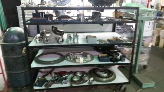

Got some preliminary info from the surgeons today. Not very good news. There's been a lot of "part-ectomies" as shown by these shelves piled high with items that are bad so far. The front power case and bearing are not going to pass. Many cylinders are "big" according to the measuring stick. So we have to think about replacements. This could go to the point that it would be cheaper just to buy a ready to go engine and make a boat anchor out of this one. Just very glad we decided to have it overhauled instead of trying to run it another season. Good grief, Charlie Brown. Saddened in the Republic... JR
