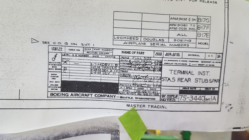

Anyway, here are some pictures I took of Ye Old Pub in June 2019 when I was living in Madras, OR. The day I took the pictures they were reaming the tapered holes in the wing attach fittings.

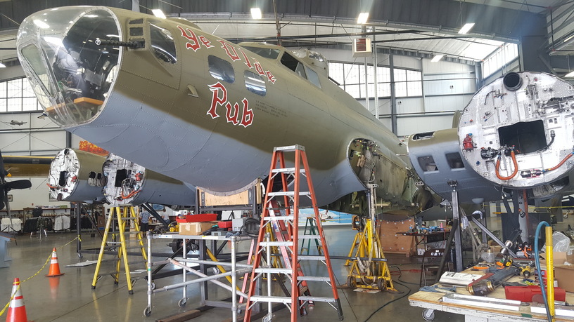

More

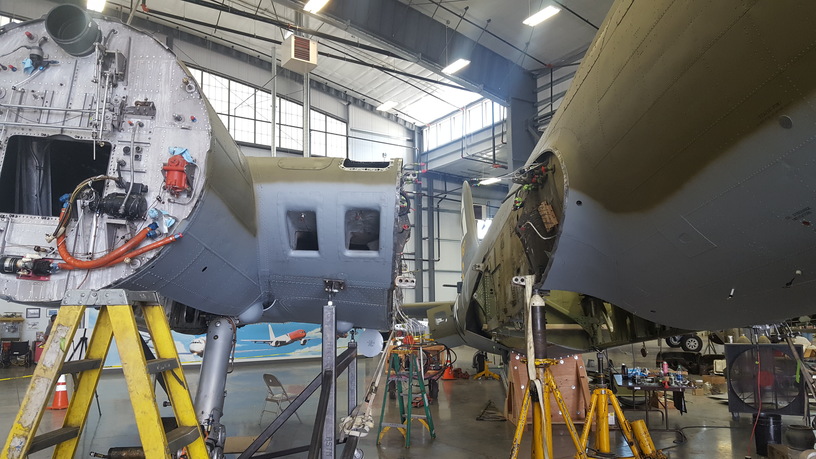

more

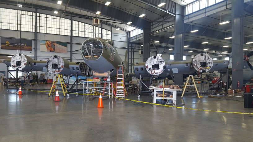

more

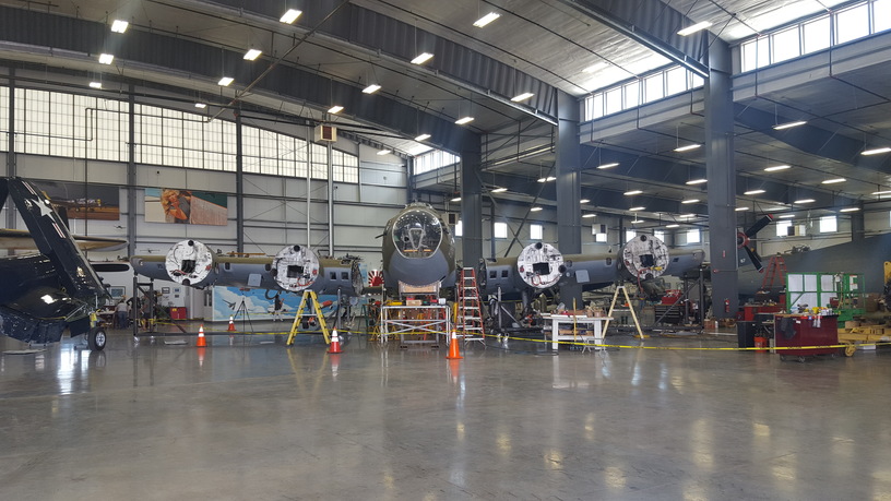

last one
