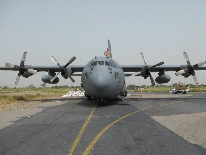

There are a few situations that call for the Buddy or Windmill. The first step to any of these (in a Herk) is to think ahead and, prior to removal of power to the aircraft (APU, engine generator, power cart), to preposition at least one of the props to the optimum blade angle we call "on the cuff". The motor which provides hydraulic pressure to the prop is AC powered and, should you subsequently lose the ability to get AC power, you'll wish you'd pre-set the blades. It's common to cuff a prop when shutting down at a forward location or anyplace you think maintenance/support is nonexistent as most of our ops there are internal/APU only. The blades are commanded to move and stopped when the black Lockfoam cuff aligns with the matching lands molded into the spinner assembly.
This crew has elected to "cuff" both inboards and the high pitch is evident. (photo by Joe Houston)
Now, if the APU fails to start, (and there is no maintenance or air-start cart) a Buddy start can be performed with another Herk and your ship's battery only. Once that first motor is running, then that engine's AC generator can power the plane and provide the bleed air to spin the remaining three.
Another contingency is that you have a single failed starter or failure of the bleed air system to supply pressure to an individual engine. Place the affected engine on the cuff and arrange for a Buddy start; hopefully this avoids a 3-engine takeoff. This situation is also a reason to perform the Windmill ... which I prefer because you don't need a Buddy and the total pain involved is much less versus the wind blast, FOD hazards, etc of the Buddy. Interestingly, one of the sim scenarios is to not have time for a Windmill (the enemy is arriving) and to perform a 3-engine takeoff followed by an airstart of the engine with the broken starter. Another diabolical scenario would be to do a Buddy start an engine and to have a remaining problem on another engine which then leads to a 3-engine takeoff. You gotta hand it to those sim IPs.
Anyway, I digress. Windmill, Buddy, 3-engine takeoff, airstart. Each a different tool for the toolbox, not sure of the direct applicability to a B-17, but a little insight into 4-engine ops.
