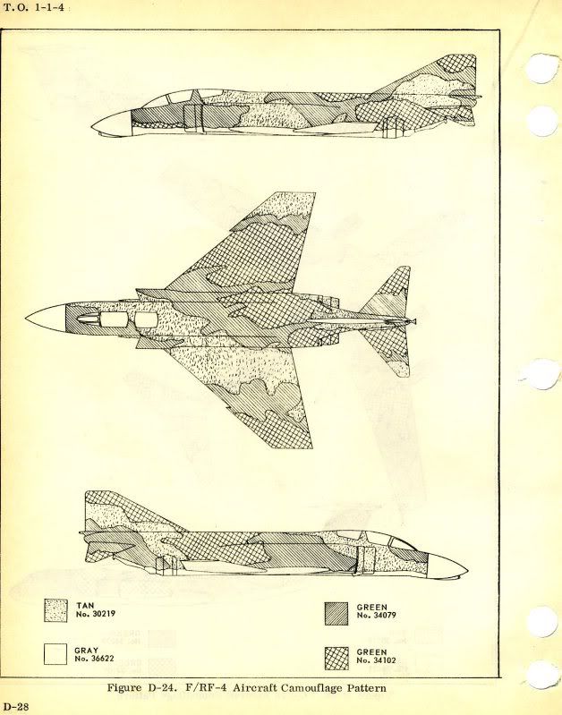

The only reference that should be used in an accurate repaint of the SEA camo is the diagram in the T.O. 1-1-4. Individual unit markings are applied over the basic scheme.

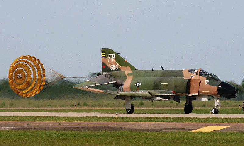

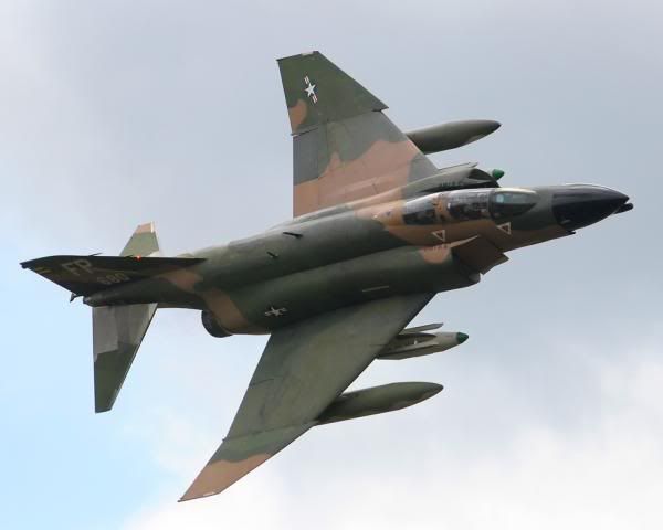

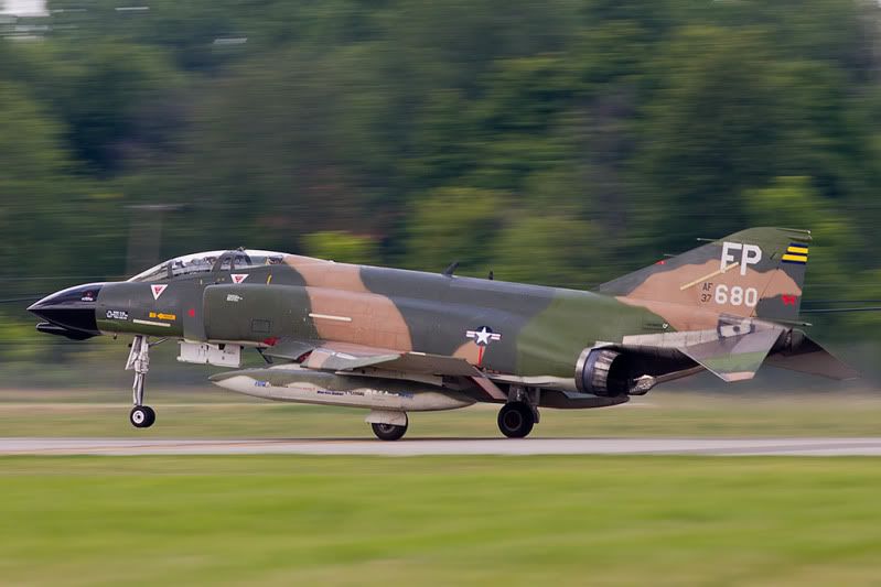

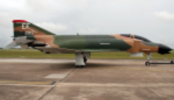

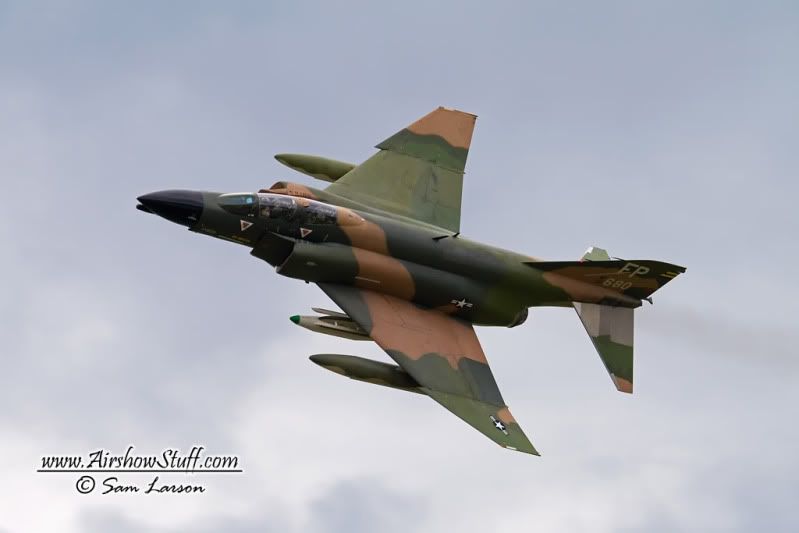

We also repainted the CF F-4D at the same time. We used standard aircraft type paint, with a normal spray gun. This was a scuff and paint process. This series of pictures shows all aspects of the SEA camo. The pictures were taken by various photographers at various venues, most were taken at either Houston or Thunder Over Michigan.
